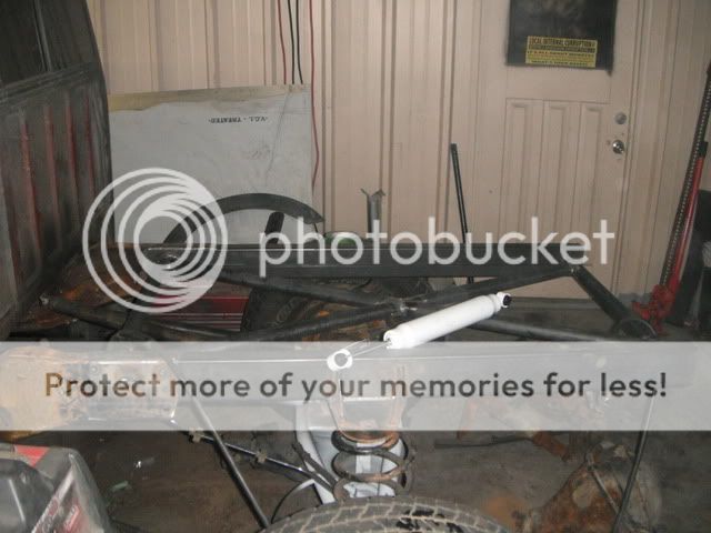

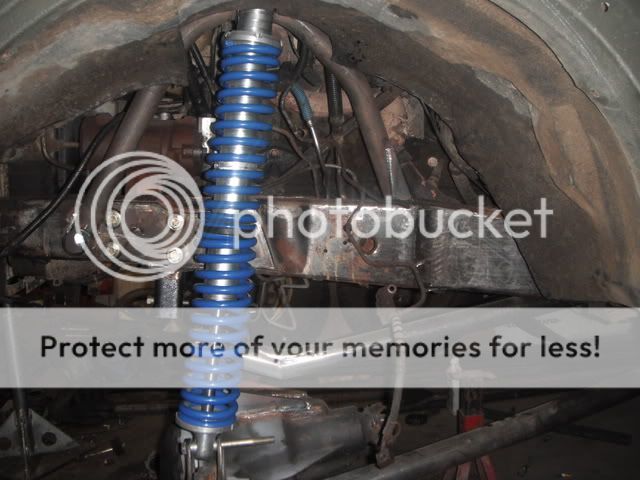

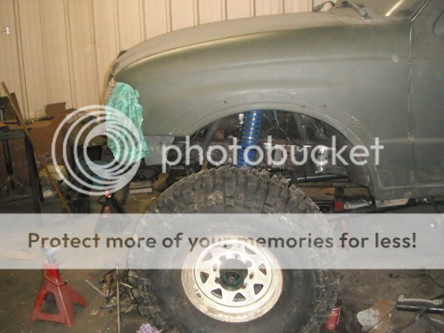

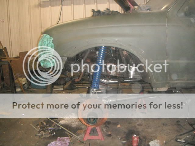

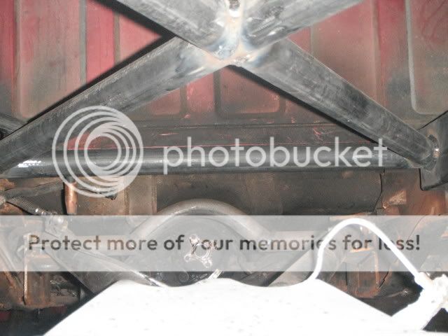

getting there! more pics soon of the bed cage and rear quarter panels!
I like the rear frame...I might do that when I rework the rear of my truck.
