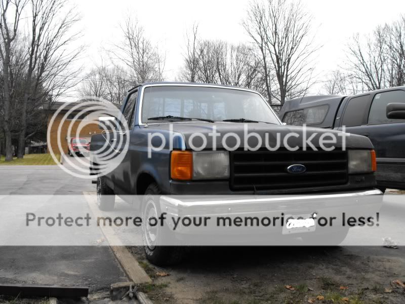

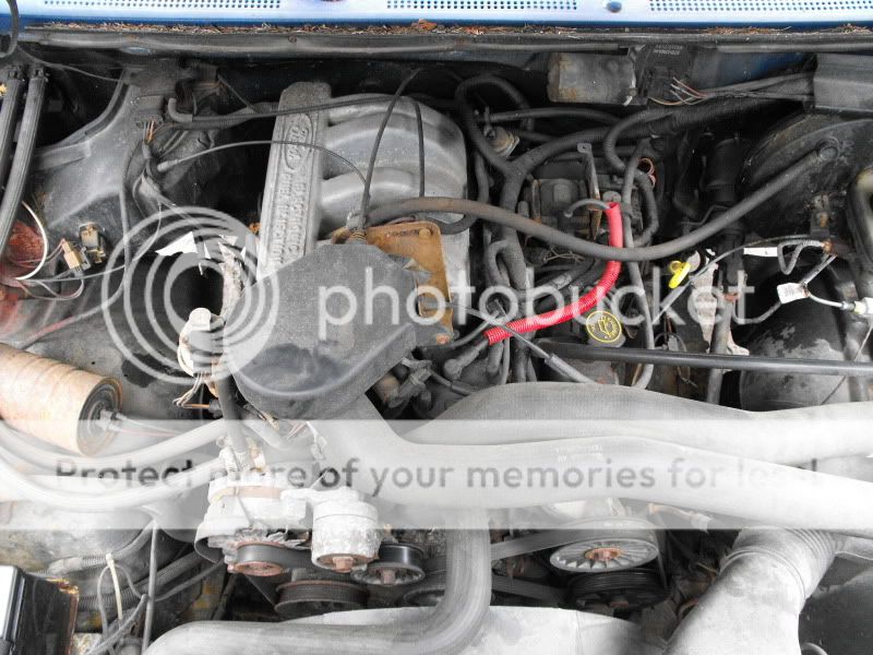

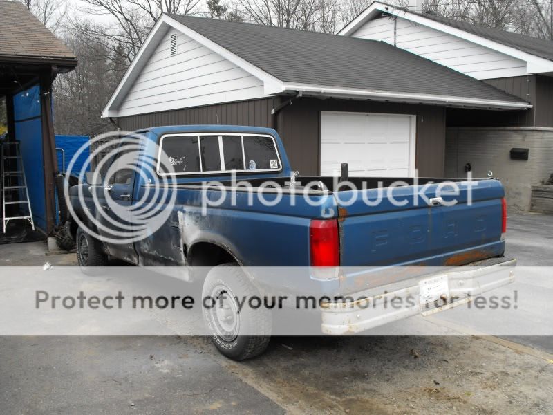

1988 FORD F150 5.0L 302 EFI A4LD Tranny Donor Vehicle/Winter Beater
BIG OLD BAG OF SHIT!!!!
but the 302 5.0L EFI only has 85 000km. Paid 600$ for the truck!

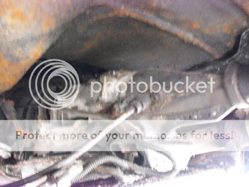

im pretty sure its a A4LD Tranny which should bolt right up.. i know i must remove the tailhousing but idk whats under neath that. the shaft needs to be shorten?
if im wrong then its a AOD tranny? and i can buy this P/N 50-8405 - AOD (1988 & up) to Borg Warner 1350 T/C. (Adapter length of 5" or 9")
http://advanceadapters.com/product/1805/50-8404.html
My Transmission code in my door says "T" which would mean i have a A4LD. but its a f150 and everyone tells me they didnt have this tranny.
did some double checking and with the markings on the trannys oil pan and the tail housing bolt pattern i think ive come to the conclusion i have a 4R70W Tranny which is the same as the Explorer and a adopter is needed 550$...
anyone got ideas on how to make power out of this engine?
i was thinking headers, exaust, computer, Efan.
i also heard that i can put 351w Heads. what can i do for more torque? i know these engines arnt known for there torque but maybe i can change that?
You gonna keep the efi? You could swap the ecu with a mustang(and cam too) then you have lost of options. Like cam swaps, intakes ect...
A set of 5.0 Explorer heads would be a great addition...
yeah i wanna keep it EFI.. i want it to start in the cold mornings of Northern Ontario! soo mustang ECU, GT40 Heads, After Market Cams.
But what Cams i know theres different lifter and duration. mustang cams are??
any intakes that i can buy to eliminate that damn double intake?
Maybe use my imagination and build something... with a K&N
i have a Flowmaster 40 Series that was on my Mazda when i first got it. i think it will be a fine addition with a high flow CAT
also seen someone changed the truck to Mass Airflow Sensor. this could help with a lean gas mixture after some exhaust and intake changes.
i was told theres longer header are better for torque is this true? and does anyone know how much they cost!
