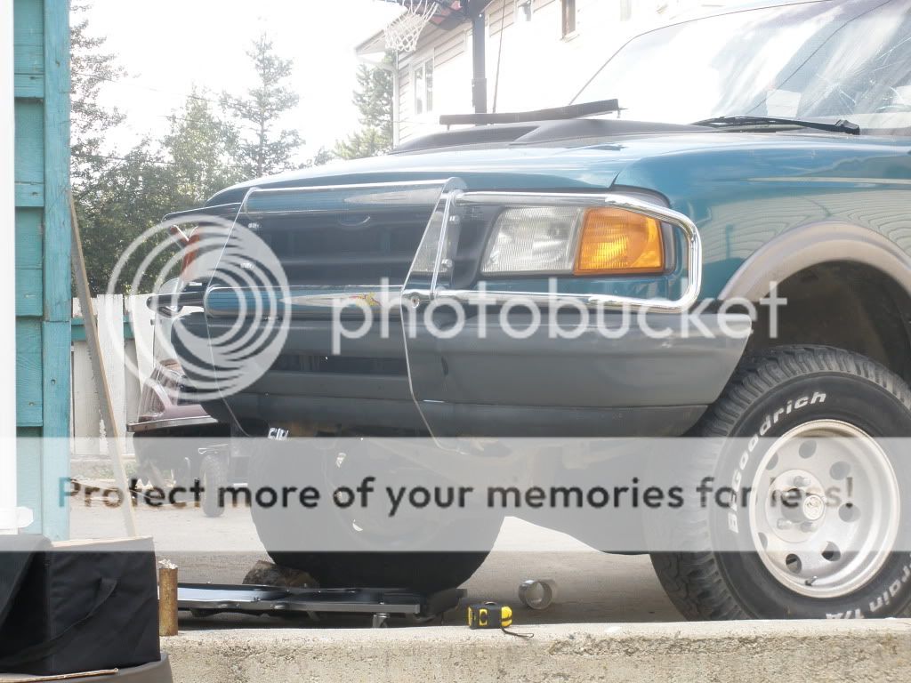

Well the main issues are these: Junkyards here are overpriced, that will lift the back up way higher that the front and I can't afford to lift the front anymore. Plus I really don't want to take the box off. Maybe later on down the road I will do it and just get the front of a 4" lift kit.
But on a good note the same place I bought my leaf springs from for "Spinny" can rebuild both of these, put in new middles leaves and and re-arch them for a touch more lift for $200. That's for both sides so I feel a lot better now.
nice doggy mike!
and nice to see the truck gettin progress
Got my grille guard on, it kicks back because it is designed for a truck without a body lift so it hits on the frame at the bottom but a little cutting will fix that right up. I like it.
I also put on some actual mirror glass, held on with RTV.
