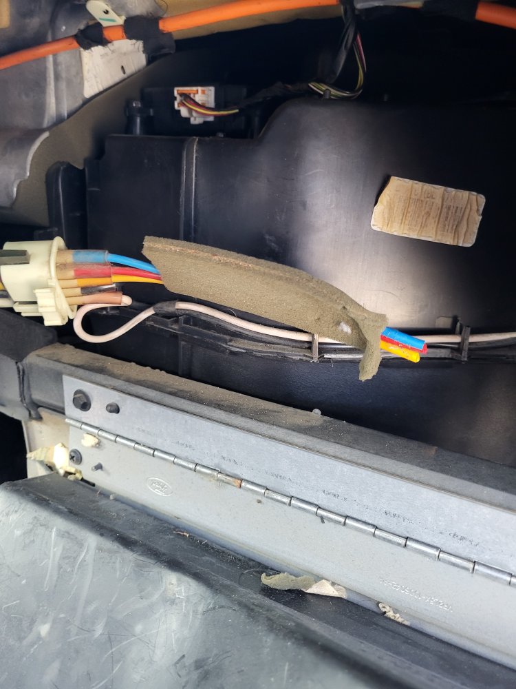

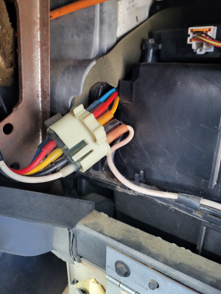

whats up guys never posted but the website always came in clutch for all my diy work. This one sucks, i just installed a new blend door actuator and noticed a mouse nest deep in the passenger dash. My air always blew on defrost but i didnt have time to find the vaccum leak. Well that little bastard chewed the 3 lines DEEP inside the passanger dash. Can anyone point me into the dirrection as to finding the chewed ends on the other side?

They are color coded and can be repaired with snug fitting rubber hose
The white part is called a vacuum manifold and its 2 halves can be separated
Its there from when the truck was assembled at the factory, so the dash panel can be plugged into the HVAC system easily
One half's vacuum hoses go to the Climate Control panel, the one that controls vent selection
The other half's hoses go out to the "vacuum motors" to open and close the doors, and that looks like the ones that were chewed
Just FYI the black hose runs to firewall and out to engine bay, it connects to Vacuum reservoir and engine vacuum
White hose is fresh air vent door AND runs out thru firewall where it changes to Grey hose color for heater bypass valve
As for the repair
Buy some smaller rubber hose(by the foot) that fits snugly over the colored hoses, you can cut a short section of one colored hoses to take into parts shop to get a good fit
Then you need to find the other ends of the colored hoses, which can be a pain
There are just 2 locations for the vacuum motors, one is a dual motor for the yellow and blue hoses
Diagram here: https://www.ford-trucks.com/forums/attachment.php?attachmentid=517&stc=1
No clamps are needed, its Vacuum so pulls hose connections together doesn't push them apart, so even if you can only slide on the rubber hose a bit it will work
Defrost is No Vacuum used, which is why defrost vent is active now

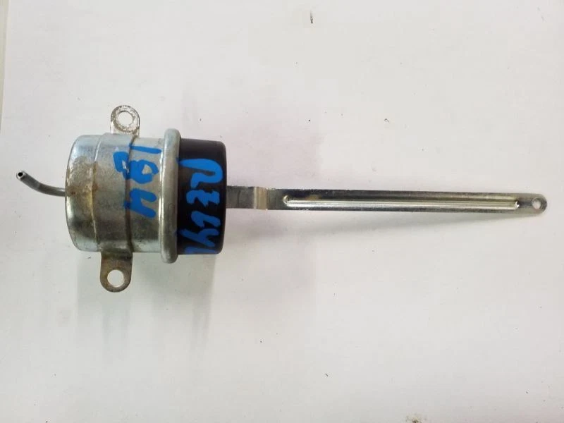

Vacuum motors look like this: https://i.ebayimg.com/images/g/NU8AAOSwKfFljvNr/s-l1200.webp
Just a spring in a vacuum container that will pull a vent door open/closed when vacuum is applied and the spring pushes it back with no vacuum

thanks for the quick reply. access to the cut hoses that are deep into the dash was the whole issue. would i see those 3 hoses if i were to pull the control manifold out? my fear was the connections i need to make will be DEEP inside the dash and require serious disassembly on the ranger. speaking of mice im up in NH and we just got a huge ice storm lost power for 2 days. pulled the honda 3500 genny out and wouldn't you know. Mice chewed those wires also. i hate them so much...
Here is a diagram for a 2000 Ranger should be approx. the same for 2006: https://www.eastgatefordpartscanada.ca/v-2000-ford-ranger--xl--4-0l-v6-gas/hvac--heater
11 and 12 are the vacuum motors you need to access
13 has the white hose
If memory serves 11 should be just above gas pedal area on the side of the vent box/center console, has the red vacuum line
12 would be on the opposite side of center console with yellow and blue hoses
If you can see the red, yellow or blue hoses you can pull hose out and/or cut it then add the rubber hose between the ends
