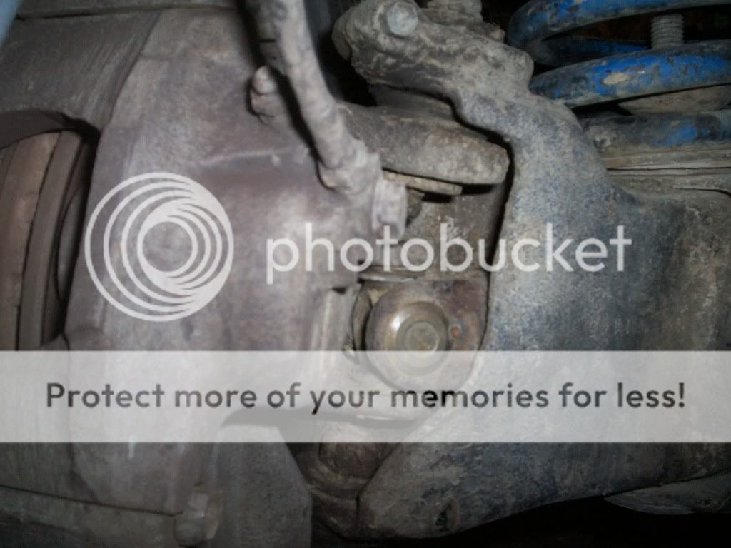

Make sure to tack weld the u-joint caps also! Went on a wheeling trip memorial weekend with Rob (fordguy64 on here) and he spit 2 caps in 2 days, wished then he woulda tacked em!
i kind of feel like your messing with me, at first glance that sounds rediculous, but then again i could of sworn ive heard of doing this before. so are you talking about tacking the ujoint to the yoke, or u bolts?
hes referring to the u-joint at the axle shaft, and yes it a good idea to tack the cap in place so you dont loose them

Also, didn't think before I made the last post... but went out and took a pic of my axle where I tacked the u-joint cap to the yoke on the front axle. You really ony need the one tack like I've got, but having two on each cap as insurance wouldn't hurt. You'll need to do this on every cap, or it's all for naught.
thanks i see now, makes sense
