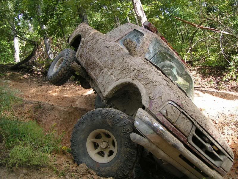

If I would have had more flex, than these would not have happened:icon_thumby:

i honestly dont see an issue with the above posted pictures, looks like normal wheeling. Those situations wouldnt be a problem for you if you had front and rear locked.
and i dont think flex would of so much changed those situations... more track width would of though:icon_thumby:
im not trying to be a smart ass like i usually do, I'm being very genuine.
Thats one got decent flex, about half of what I want (maybe I'm unreasonable, I know I'm crazy!), he's got the cage arms, I've heard a couple people don't like em, but I'm getting ideas for my setup with every rig I look at....I try to find the "weak points" with other's rigs, and improve on their limitations...I'm getting some great ideas from ya'll though:icon_thumby:
that was exactly my thought on the situation, seriously! A set of lockers front and rear and mash on the gas and it would have drove out of that.
