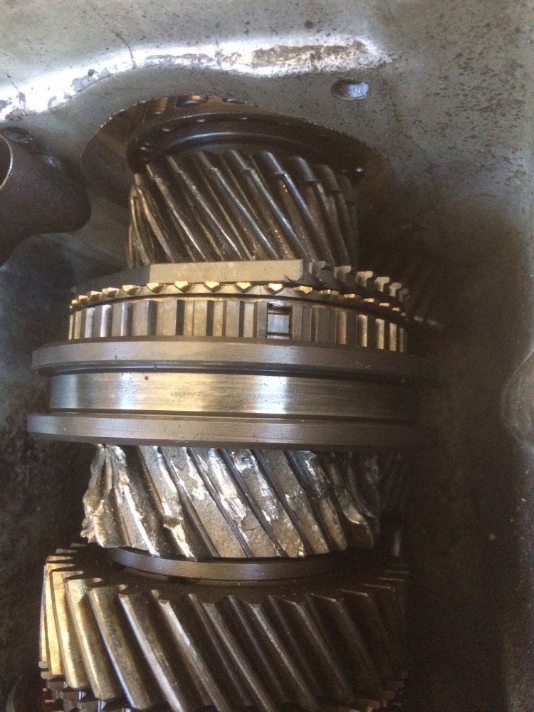

What's wrong with the one in it already?
As Junkie says... might be worth just fixing it... then you know what you have opposed to just putting a used one in it.
3rd gear is completely obliterated & 4th gear is pretty chewed up as well.
