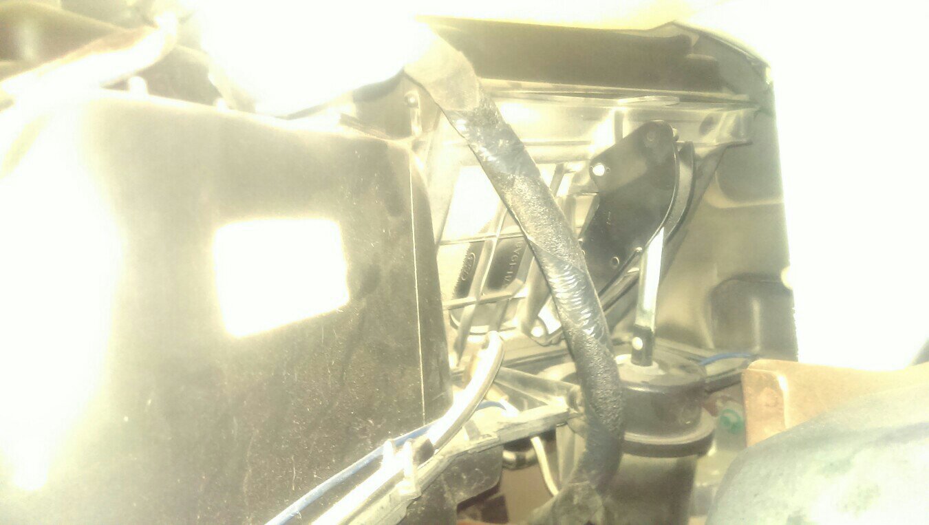

It's vacuum actuated. It's located out in the open, right behind the glove box.
A/C max - Recirculate
Vent - fresh air
Sent from my HTCONE using Tapatalk
So then it would probably be either a problem with vacuum getting to the actuator or the actuator itself is bad?
Or the door could be stuck.
That's a different actuator than the one for the blend door right?
With the engine running, and the switch to max A/C. Pull the vacuum line off the bottom of it, see if it's sucking. If you have a vacuum gauge, it should at least 13" of vacuum @ idle.
If so, make sure the door isn't stuck, and put vacuum to it, if no movement replace the actuator.
If no vacuum @ line, check for bad connections, and broken lines. Pull the panel, and check the back of the switch. Since it switches vent/def/floor position you know it has vacuum to the switch.
Let us know what you find.
