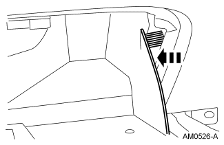

Found it. It's behind the glove box door.
Vacuum Control Motor — Air Inlet Door
Removal and Installation
  1. Release the stops and lower the glove compartment door.
  • AC is working on Max AC only

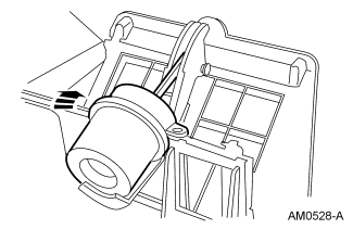

  1. Remove the screws and disconnect the vacuum hose.

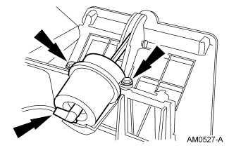

  1. NOTICE: Do not attempt to bend any part of the lever. It is brittle and will break.
    Rotate the vacuum control motor, disengage the lever and remove the vacuum control motor.
  1. To install, reverse the removal procedure.
