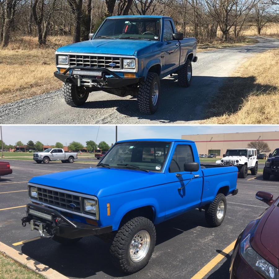

I took on the project to make my ranger look a little better. It's a lot cheaper than a paint job and I think it turned out pretty nice.
Interesting. Did you apply it or someone else? What did it cost? Have any pics of the process?
I thought about doing this also. It looks great! How about some before pics?

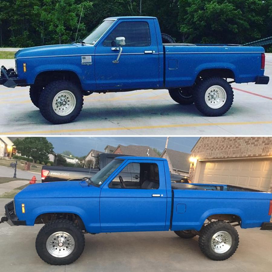

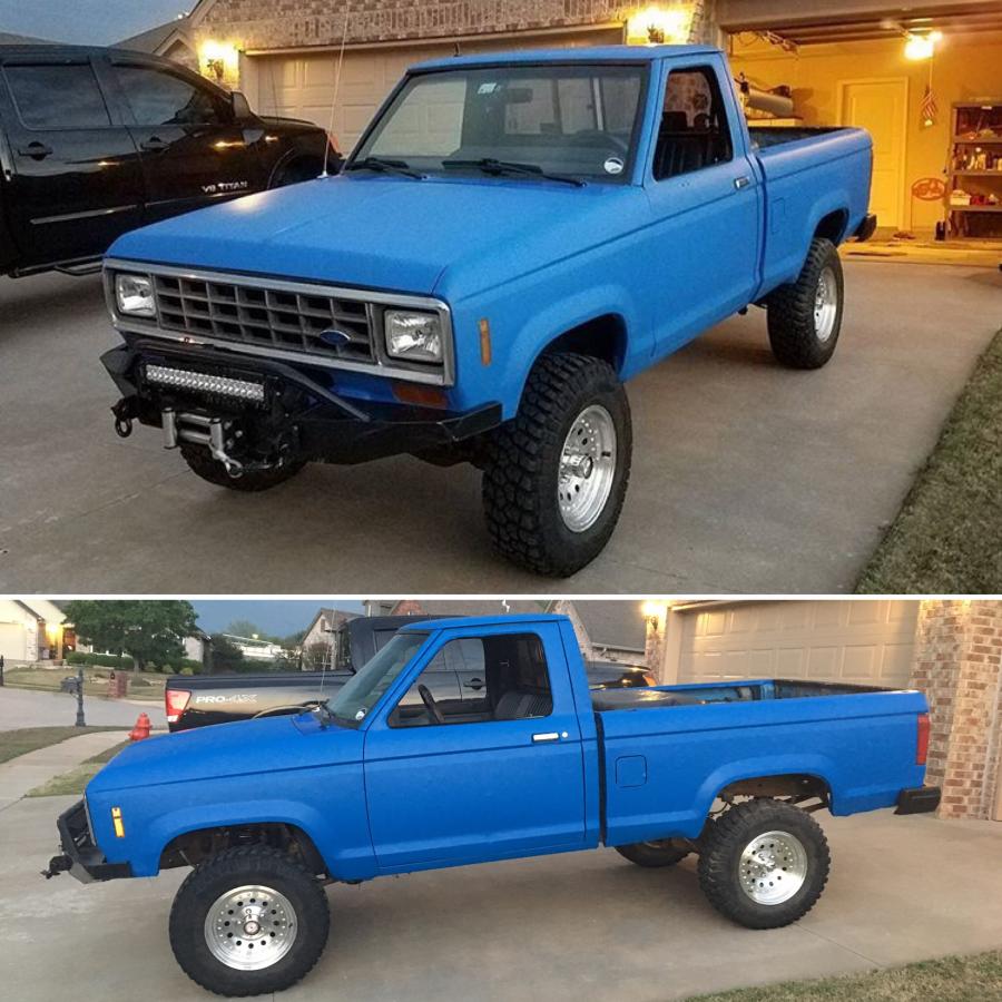

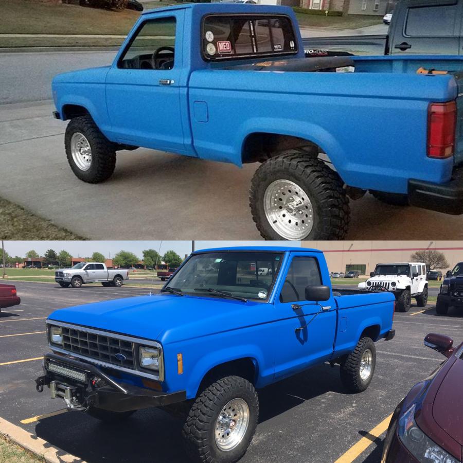

Unfortunately I didn't take pictures during the process. It wasn't hard to do. Just some quick tutorials on YouTube and the basic understanding of the process. The entire project cost about $300. I don't have any great before/afters. Here is something I threw together.
