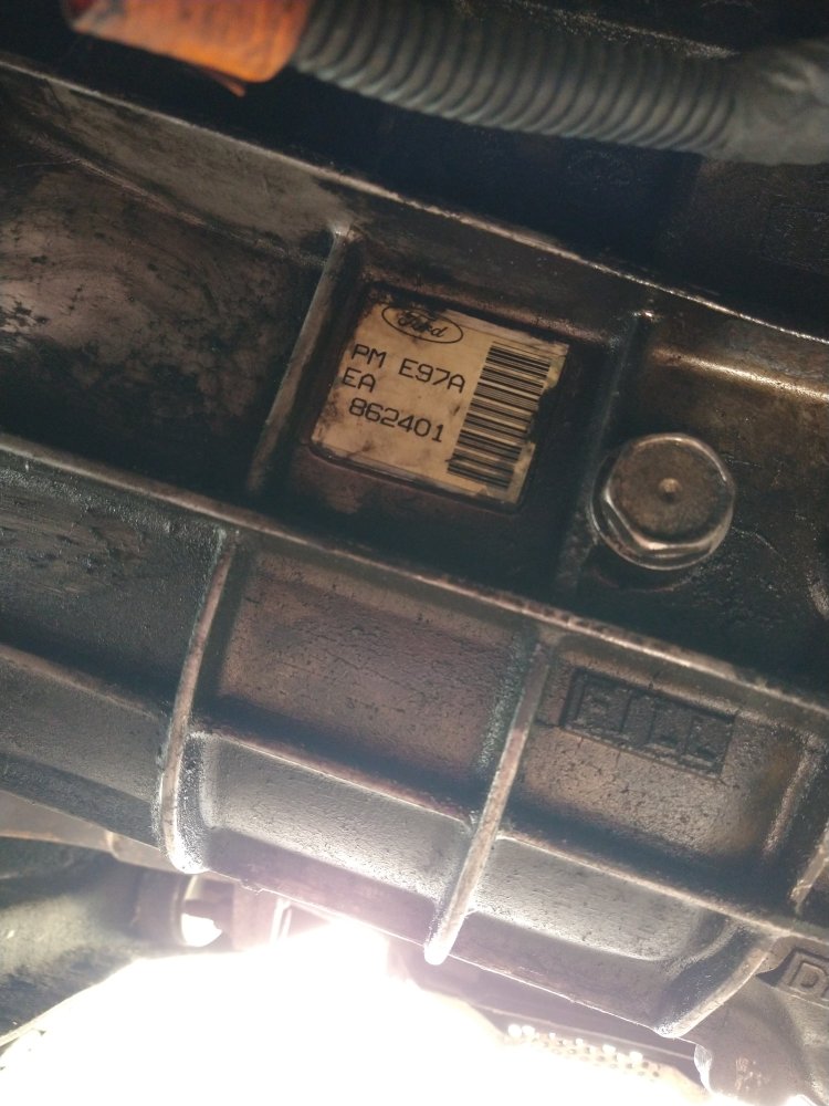

It looks like there may be a wee leak coming from my transmission. I believe it's an M5R1.
The leak seems to be coming from the drain plug and maybe a bit from the fill plug.
When I open the fill plug, the lubricant isn't quite level with the bottom of the fill hole. I have to stick my pinky down about a quarter inch before it's wet.
My questions are: what type of lube should I use? The Haynes repair manual says to use Mercon ATF, but isn't that red in color? The stuff in the tranny now looks brown, like oil. But I'm not sure how to tell what type of solution it is and what I should use to top it off?
Also, how would you recommend stopping these leaks?
You can't see the leak in the photo because I wiped it off to check later and hopefully get a better look of where the leak is coming from.

if it is actually coming from the plug threads, you can put some teflon tape, like plumbers use, on the threads or you can get some plastic or copper washers and put under the plugs

M5r1 is atf from everything I've read. Not sure exactly which. Look in the tech section...
Dex III/Merc, don't use Mercon V
5w-30 synthetic engine oil and Syncromesh MTF fluid are also totally safe to use

Spec is actually just below the fill hole everyone just always fills them all the way up so technically you're fine.
As long as it doesn't stink like gear oil I'd probably just call it good for now, as long as it's not gear oil I'd be tempted to just drain and refill when it's convenient, if it's gear oil it will take draining and filling then running for a while and repeat...
