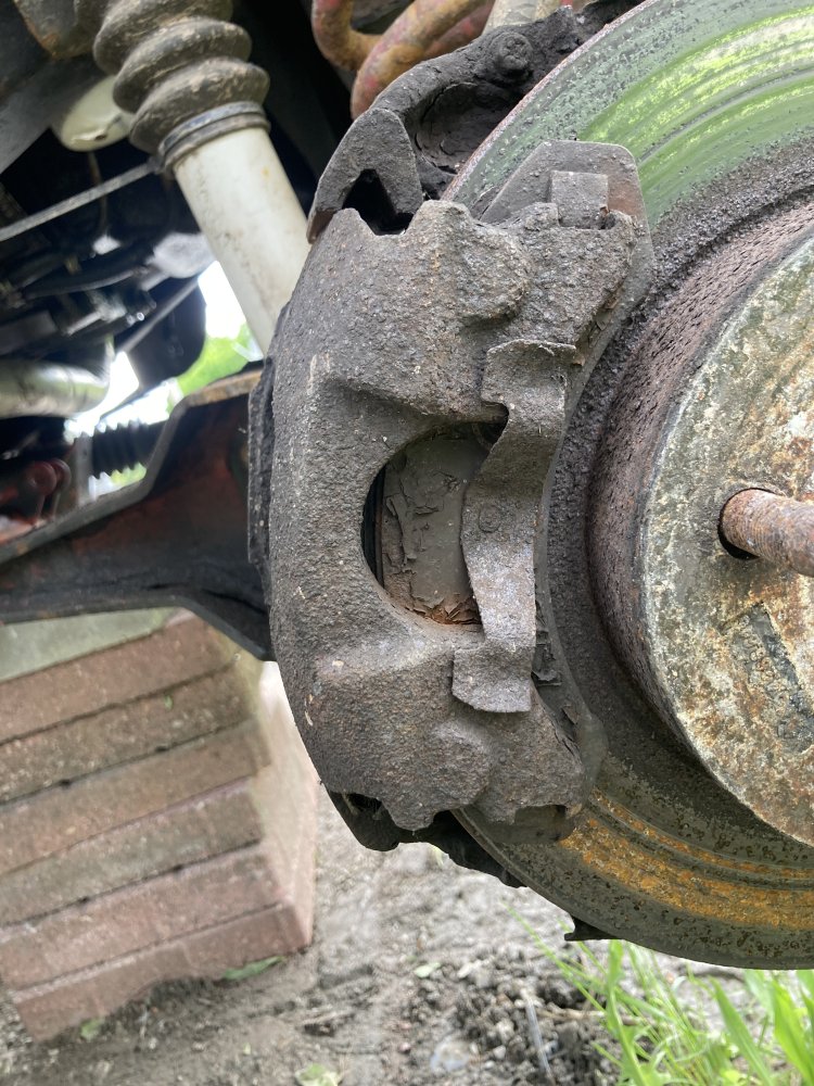

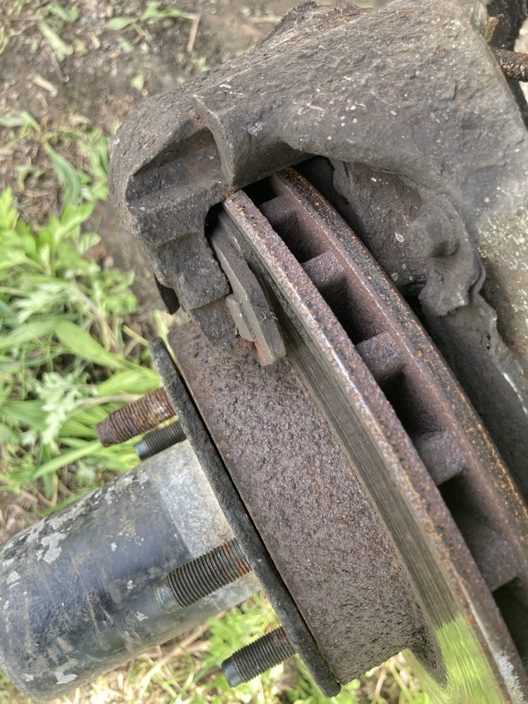

When I first got the truck I checked the front brakes pads but didn’t inspect for much else since they worked and didn’t make noise. Now I see that the passenger caliper is missing a “cotter” pin or whatever these clunky ones are called. And the caliper sits low and lightly drags on the edge of rotor. I’m surprised I’ve never seen sparks or heard sounds from this. Also, even when lifting the caliper up a tad by hand so that it’s not dragging on rotor edge, there’s still a light weight scraping sound and the pad appears to still be making contact with the rotor. There is more resistance to this wheel spinning too. Not sure if it’s the brake/pad or not.
In any case, I gotta order up a pin. May as well order new pads now too and do those. There’s a few MM left on each side. This passenger one looks worse,

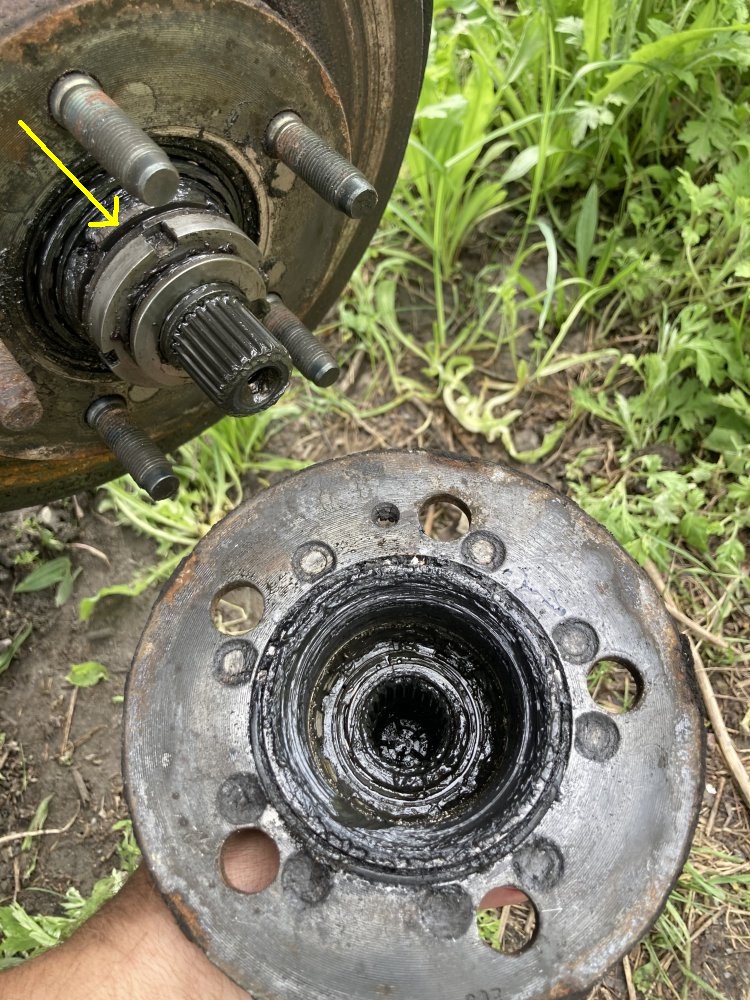

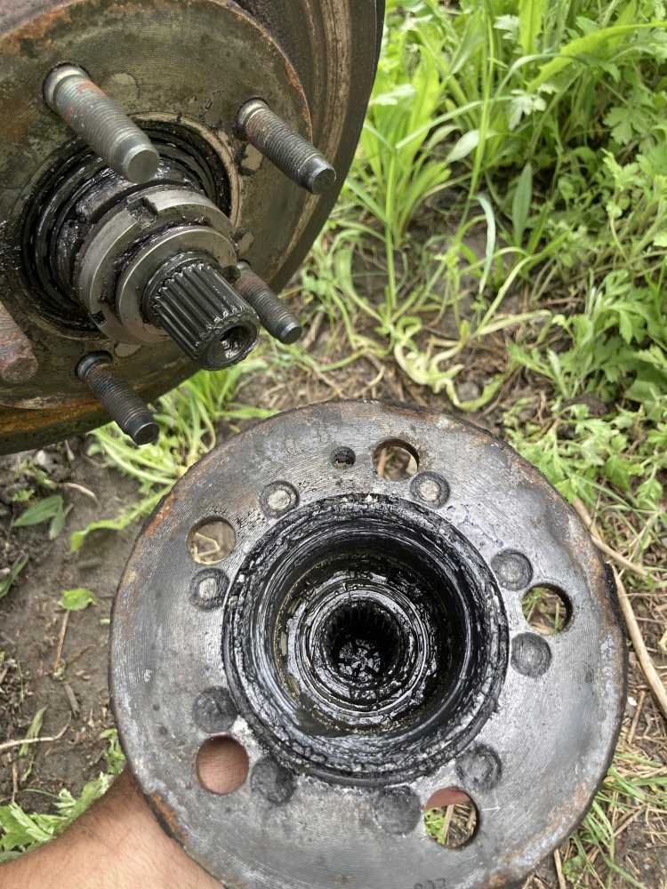

Am also unsure that there should be so much grease all over inside the hubs. I guess it makes sense that all these parts need grease! Or maybe this is a sign of some leak. It’s the same on both sides. This summer I’m planning to dig deep in front with the hubs/bearings/u-bolts.

damn lucky on that caliper pin.
Got a pair of replacement pins on hand now.

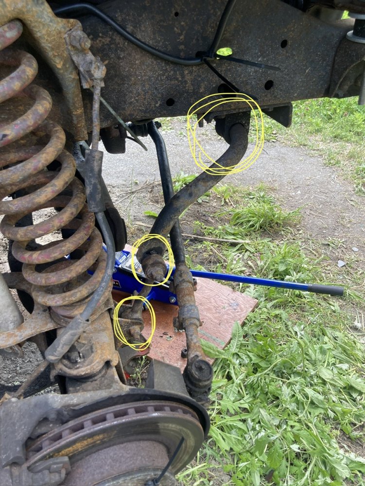

Upon looking at some stuff, I’m wondering if it’s worth the time to also replace the following three sets of bushings, while I have it lifted and without tension, circled in yellow below. Seems like the purpose of this whole bar is to help hold the wheel assemblies in place. Thoughts? Seems like it might be pretty straight forward.

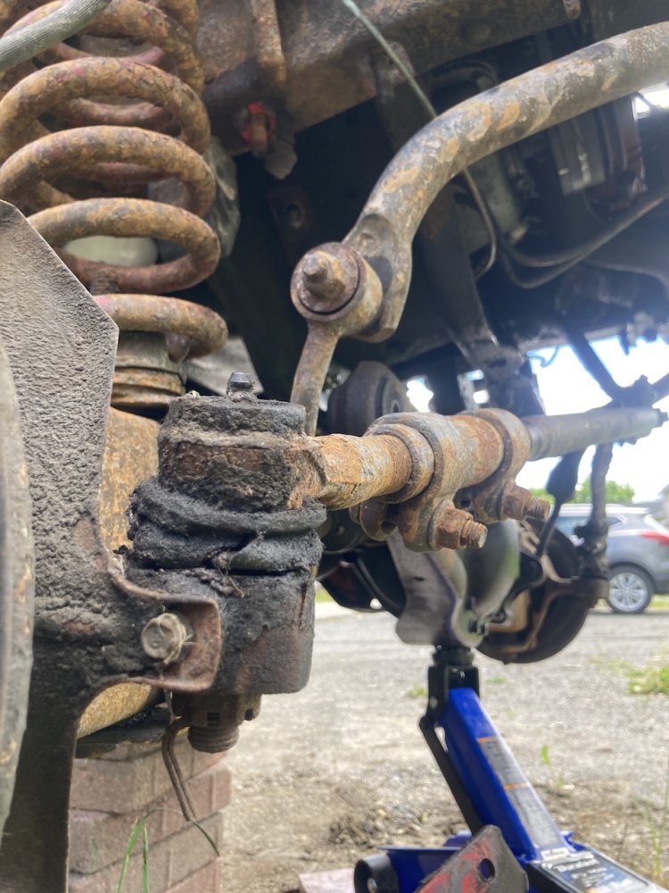

Il also concerned about the steering linkage. I haven’t greased them at all yet, although the shop may have when doing alignment last year.
That is the sway bar and link bushings. Might as well replace if worn.
I usually throw all that sway bar stuff away. But bushings are cheap and easy
I already deleted a steering shock / stabilizer and didn’t notice a change. Interestingly there is no sway bar indicated in the 89 shop manual for 4x4’s, only 4x2.
So what’s the deal? Without one would it in theory be leaning harder on other components to do their job well and not fail?
Ttb is a sway bar.....😀
I deleted the sway bar on my '90 4x4 when I did the Dana 35 swap and 6" lift, I don't drive it any slower around corners than I ever did, haven't fallen over from that yet, it has gotten tired and fallen over a couple times for other reasons :). With stiff enough coils like they all have (unless you go jeep or early bronco coils) the sway bar is just kinda extra weight... but bushings are cheap and if you don't like body roll then go for it... with a lift and not having longer end links it isn't working to it's full potential anyway...
That looks pretty normal as far as the grease is concerned... But do I see that the wheel bearing locknuts have loosened in this pic?
I’m not sure what to look for so I’ll look in the shop manual. Or can you explain?
I’ll check both passenger side and driver side.
I see what looks to be a gap between the locking washer and inner locknut.
