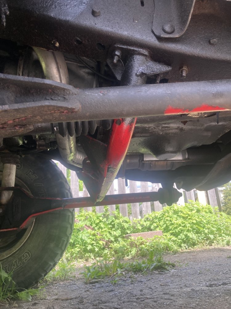

Anyways I was working under truck and noticed that the Rancho radium arms might be a little beefier than the ones you’re referring to. Maybe they evolved their reinforcement a bit as the product lived. Here is a pic of mine below. Cosmetics aside, ie the paint peel and surface rust, it looks like the engineered transition from the strong boxy section to the tubular section is a more extended and I guess “stress distributed” than the drawings you made. It’s not atotally burly as the Super Lift one you compared it to, but still it looks less like there’s a single weak spot where the crack would build. That’s the optimistic take on it anyways. I could be wrong.
But I’m replacing both drop brackets, which is obviously the weakest point of this Rancho system. I’m also going to replace the radius arm bushing and axle pivot bushings. I know the latter can be a beast but I’ll figure it out. I want to take care of as much cost as I can in my own before taking it in for a real alignment.
Yours look the same as mine (other than the grease and missing paint). Those were just impromptu freehand drawings from some almost 30 years ago... I don't declare myself to be an artist lol.

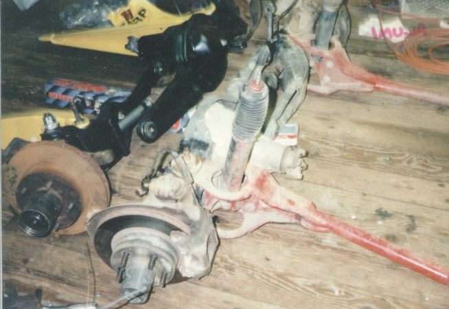

This is the only (sorta halfway decent but not very decent) pic of the Rancho arms I had. The driverside arm in this pic was a replacement arm... Although you can't tell in the pic, it is bent in that area. It caused a fairly hard pull to the right due to the resulting change of the caster angle. You can also see where I had to modify it for (stock!) tire/wheel clearance (and yet it still rubbed). It was just a shitty design all around.
But yea, put a gusset or two (or some ¼" steel plating) in that area on the driverside radius arm that runs from the flat plate section down along the tube for a good 5 or 6 inches, and you should be fine. :icon_thumby:
