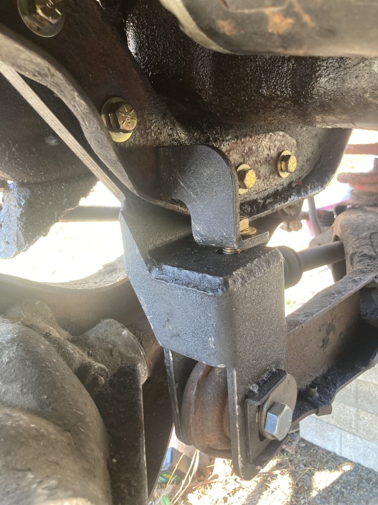

So it’s in lightly and just not yet thread locked and torqued.
I’m concerned about the “reinforcement bracket that is part of the set. It is a small L shaped thing that creates an extra bridge between bracket and crossmember, above the axle connection. It doesn’t line up perfectly, there is like 1/4” gap unless I start to torque it down and create some kind of bending somewhere.
Anybody have any thoughts about this? Pic below.
On a side note, I finally understand how the cam bolts create camber of wheels. Makes sense. But it also took me until now to realize that the old Rancho drop brackets simply have no cam bolts. That makes me wonder … is starting off setting the cam bolts mid way making them the same position as the old version which had no cams? Dead center height? So for now, my passenger side wheel has a cam bolt, driver side does not. Not sure I want to spend money on an alignment until I’ve got both brackets in, and would like to be able to drive the truck between now and then.
I am considering adding a couple heavy duty washers in the reinforcement bracket instead of forcing something weird during torque down.

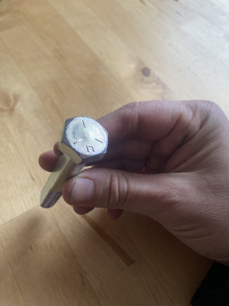

Is that lower bolt a grade 5?!
Got a decent enough toe setting to drive the truck and took it for a slow spin around town. Everything seems ok, but i can tell things are slightly weird with alignment so I'll drop it off for the trusty cheap alignment tomorrow. Will take it to a nice alignment place after I've done the brakes and also installed the other drop bracket.
Here's the bolt you're probably referring to. It's the cam bolt that comes with the Tuff Country drop brackets. This is of course from the drop bracket that's not installed yet. I'm not sure what grade this is but i sure hope it's not 5.
74754
It is.
No lines = grade 2.
3 lines = grade 5.
6 lines = grade 8.
Great. Thanks Tuff Country / Suspension Connection!
Guess I’ll start combing though McMaster to see if they have good cam bolts.
It will be fine. If it was grade two I would be worried. Grade 8 is stronger but also more brittle.

I'm sure it was suggested somewhere one here, but maybe its time for a solid axle swap? Seems like you are halfway there.....
That center bar to the bracket makes no sense to me.
But I’m still left figuring out what the center bar offers. Just structural reinforcement?
I had a Rancho lift once myself. Nothing on it really made much sense. My guess is that bar was a(nother) poor engineering attempt to compensate for the poor engineering of their bracket.
I found cracks in that same bracket of mine after a mere two years of using it. Fortunately I caught it before it broke and I welded the whole structure of it closed using 1/8" steel plate (leaving just the bottom area where the beam mounts open).
We...many year ago noted it actually causes the failure.
The bar isn't the problem (though you're correct its completely unneeded, especially with a well-designed bracket). The problem is the unreinforced open plate-steel framework of the bracket. Without any boxing or other reinforcement, the entirety of the bracket flexes, and eventually it fatigues and breaks. That bar does little to stop it from flexing.
I definitely would suggest planning on completely replacing that kit as soon as you can possibly afford to. It's a death trap in more ways than what you found. When I pulled the Rancho kit off mine after two years use, I found cracks in every single bracket of that kit (the one in question here, the opposite bracket for the driverside beam, both radius arm brackets, and one of the radius arms even. A replacement radius arm bent in the same area the first one cracked). This was all with running not-so-real-big 32x11.50 tires.
The Skyjacker Class 1 kits are relatively affordable among good quality kits. Only thing is this kit is designed to use the stock Ford radius arms, which you would need to procure a pair of those (along with a stock crossmember) from a junkyard in order to install it.
Or if you have a welder (or access to someone who has one), I'd suggest weld a 1/4" thick gusset along the top of the driver side radius arm, and gusset both of your radius arm frame brackets.
