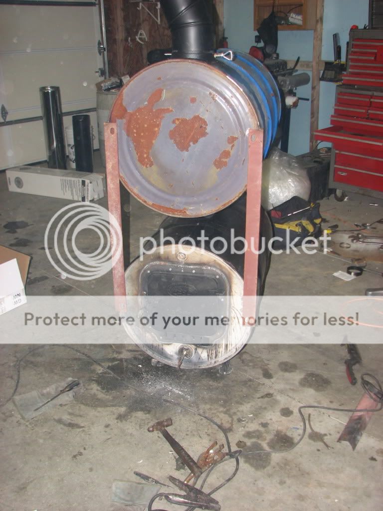

made me a wood burner for the garage...

just one barrel heated my 30 x 40 just fine with 12 ft ceilings...make sure you put the exahust out the other end of the top barrel so the heat has to move through the barrel before going up . and put about 3 or 4 inches of sand in the bottom under your fire grate. dont worry about paint, it wont stay on there anyway..lol

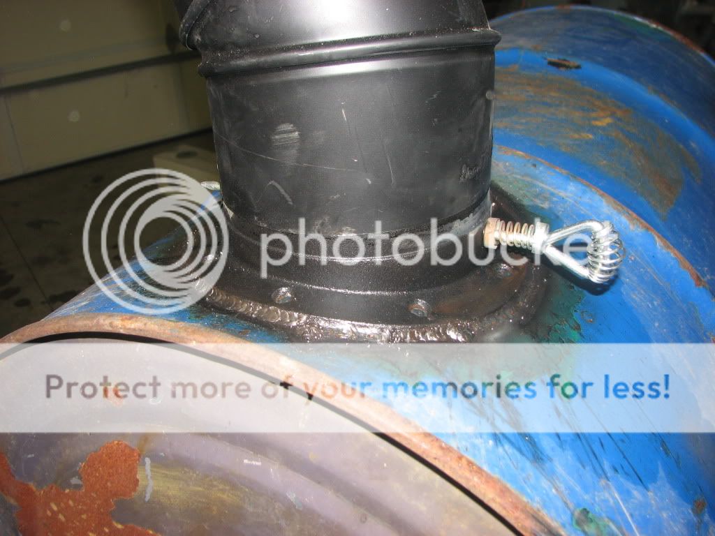

yea i put the flapper on the front of the top barrel, wanted to keep the vent as far from the studs and styrofoam as possible to help prevent a fire

If you have more of the pipe you connected the two drums with, poke a hole in each end of the top drum and insert the pipe through it and mount a small fan on the pipe. You'll draw even more heat out of the exhausting smoke.
Sorry. Didn't see this had already been mentioned.
yea i may see about getting some today
A couple pieces of advice...
1)Don't leave the ashes in the barrel at the end of the heating season.
2)Line the lower barrel with sand (better than nothing), "Black beauty" (better)
or Firebrick (best) (Note: just laying it in place works)
3)The upper barrel works even better as a heat exchanger of you weld several lengths
or 3" or 4" diameter pipe through it lengthwise
Or as a friend did... welded a continuous length of seamless 8" diameter duct
through his upper barrel and mounted a blower fan on the back blowing air
THROUGH that pipe...
Any heat that escapes to the outside world other thn that required to
create a the "draft" that keeps the fire going is wasted energy.
Someone else I know used stainless steel barrels and welded threaded bungs in the
ends of the upper barrel and pumped coolant through them... then again he also put pipe in the floor for radiant heating from the floor.... but it was all filled with second hand anti-freeze.
His standby generator was powered with a water cooled 4cyl Kohler engine
and that was also in the circulation system... so the wood stove also served
to "preheat" his generator engine.
AD
Another idea would be to encase it in a tin box and put a funace blower on the bottom drawing in the cool air from the floor. Then have a couple output ducts at the top for a forced air effect. buddy of mine did this for his shop.

thanks for the tips guys, most of that will be done before it goes into action i hope
as for the triple wall, ive got a single 3 foot piece that will be going through the roof but the rest will be just regular wood stove pipe...dont have that kind of money

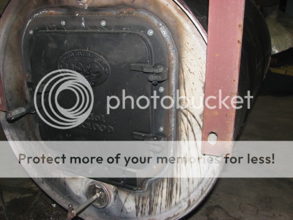

finished welding the stuff in...it comes where you can bolt it but i didnt want to worry about it leaking
welding cast to thin metal SUCKS...exspecially when you dont do any prep work lol
