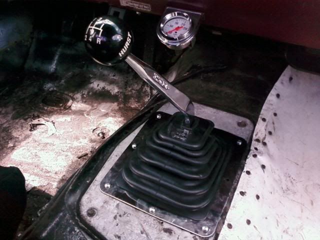

Well, I found out today the dealership doesn't carry them. But I went ahead and ordered the Hurst off Summit because its only about $80 more than the shifter I found on drivetrain.com. I did need the whole shifter, stub lever, mounting plate, and top lever. And I guess the Hurst comes with the knob too. Not quite as cool as the black-chrome skull i was gonna get for ~$50 :sad: but its still pretty sweet. But thanks Alan for the info

See, Summit ships within the hour and the next day I got the shifter lol... pretend you don't see the jerry-rigged floor panel :icon_welder: lol it wasn't my doing
One thing I did differently... I cut the top off a stock shift lever and tapped
it for threads so I could use the stock knob and the stock shift boot.
Basically I like the Hurst but I wanted to hide it from various kinds of unfriendly eyes.
