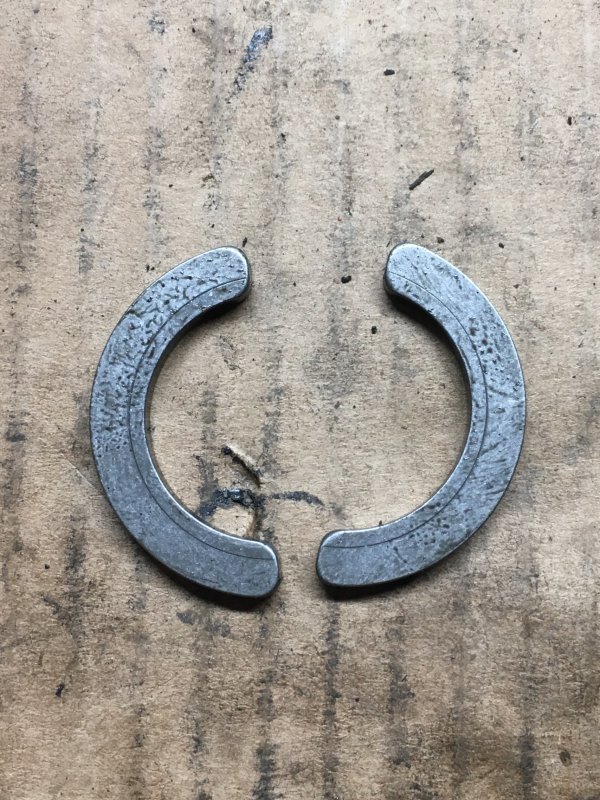

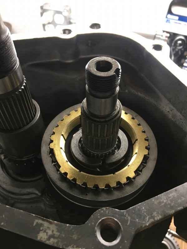

M5R1 Final assembly assistance needed

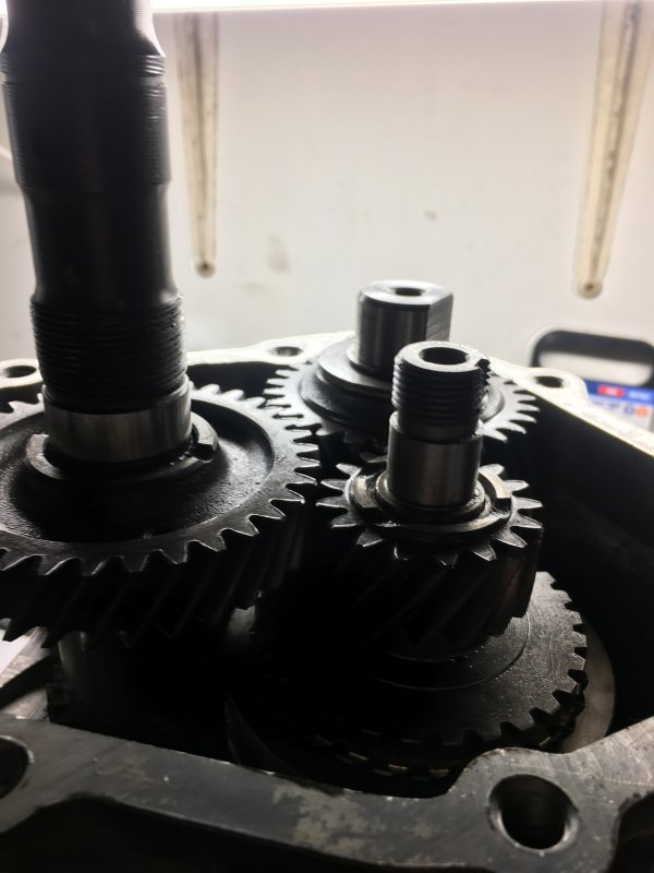

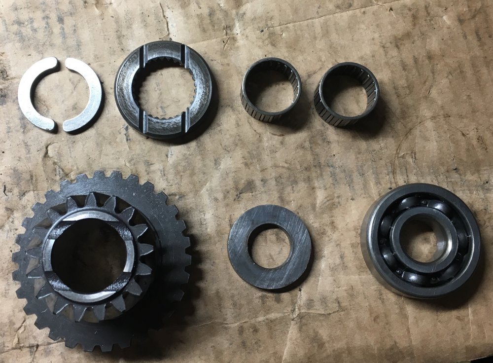

If you had to grind the split washers down to fit, it means that everything before them on the counter shaft (including 5th) isn't seated all the way or is assembled wrong. There should be room for the washers to fit. If not, something isn't right. I wish I could be of more help but it's hard to diagnose stuff like this over the internet.
Yeah I understand, I appreciate you trying to help though.
