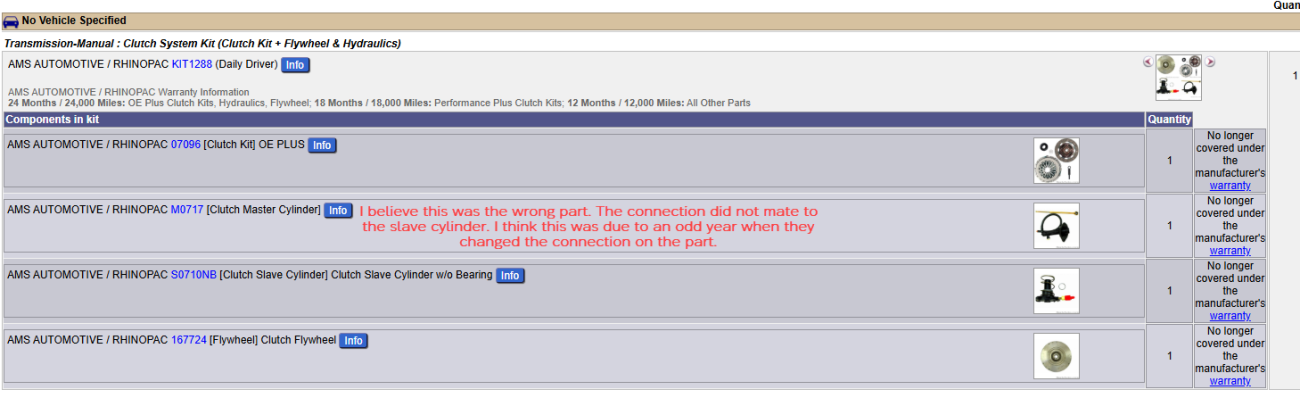

Sorry I missed this post. Here is my order list from Rock auto. This is my stock 2.8l mated to an M5OD 4x4 transmission from a 91' ranger with a 4.0l.
I remember the clutch master cylinder connection not fitting the slave cylinder. I'm pretty sure this is because this was an odd year they change the fitting. Just be prepared to order an older style to make sure it fits.
Everything bolted right up and I've had no issues.

as mentioned, key is a complete setup. a 90 or 91 4.0 ranger is close as you can get.
there are some differences between the master from 83-87 88-91 and 92 on. it is in how the quick connects and o rings ect work.
the later flywheels are 8 bolt as well so you dont want anything newer than 97 as it may be wrong....there is crossover with that 6 and 8 hole.
so bottom line, order a complete setup for a 1991 4.0 and you should be good to go. the pilot bearing or bushing should be the same across the model run....so get a complete system master/line/slave with the 4.0 flywheel clutch pressure plate/tob and pilot.
