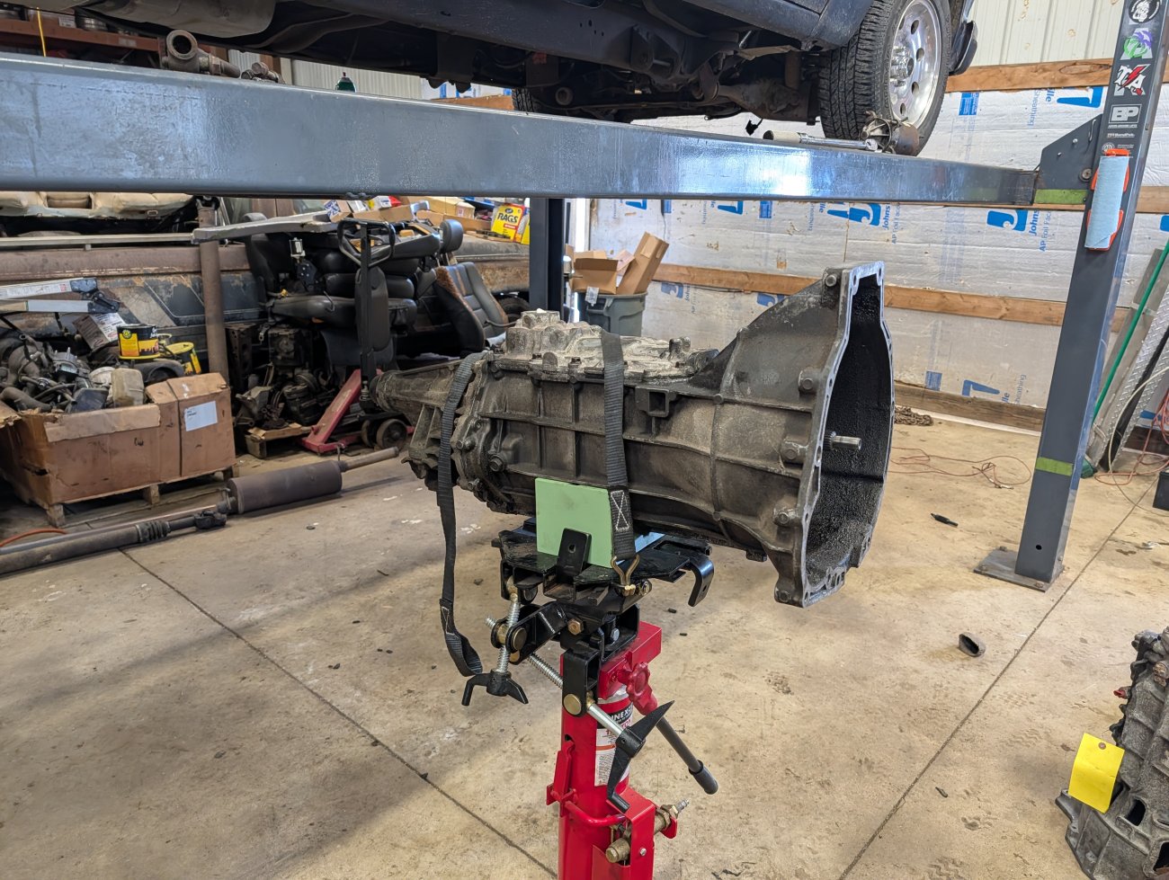

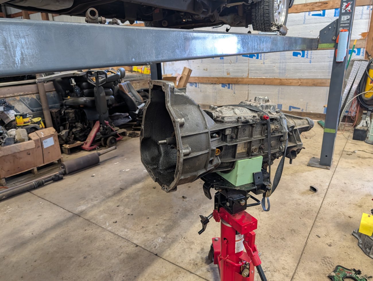

M5OD + trans jack = misery...until now!
Yeah, honeycomb interior, I think 40% infill is pretty solid if I understand correctly... fastener locations could be added to the print no problem I imagine or even areas with 100% infill to drill/tap...

Studies have shown that anything beyond 30 to 40% infill is honestly a waste of time and material if you have thick enough walls.
If I had intentions of bolting it down I could have printed in pockets for nuts or nutserts
