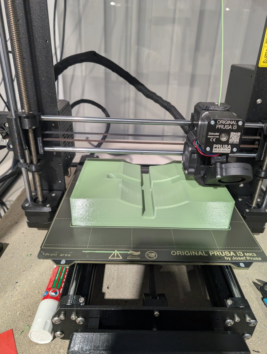

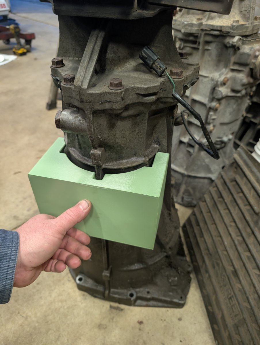

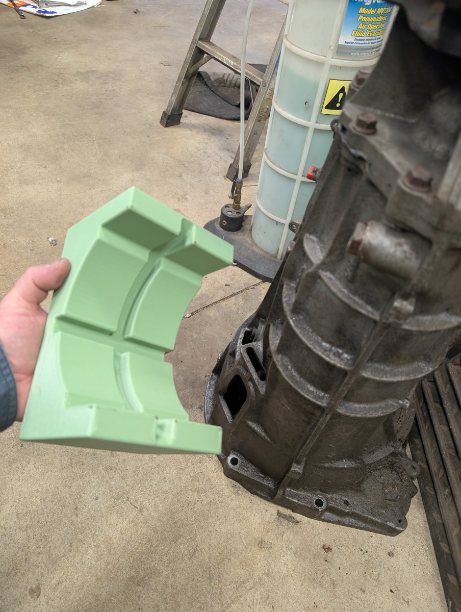

After swapping my 103rd +/- 5 Ranger M5OD I finally decided to make it easier.
Since the bottom of the trans doesn't have a single flat spot on its difficult to stab a trans in with any precision so I put my poor fusion 360 skills to work.
PETG with 10 layer walls and 40% infill made for a stout unit.

3D print deal looks pretty cool! Let us know how it works!
looks good. is it strong enough to drill & tap?
I wonder if J B weld is sold in bulk? or body filler.

You going to offer these for others? Lol
Honestly...with the print time and material cost its probably not worth it, but I'd be more the happy to share the STL
3D print doesnt really do well with adding hardware post printing if it wasnt considered into the design. I just need it sit pretty so i can strap it down to the trans jack.

safe to assume it has hollow /honey-come interior?
if solid areas were incorporated could the material support small loads around bolts ? not exactly load bearing, but secure it in place.
Yeah, honeycomb interior, I think 40% infill is pretty solid if I understand correctly... fastener locations could be added to the print no problem I imagine or even areas with 100% infill to drill/tap...
One of these days I want to get a 3d printer, I think that's what I'll have in the shop bathroom so I can have an exhaust fan, I imagine it would help...
