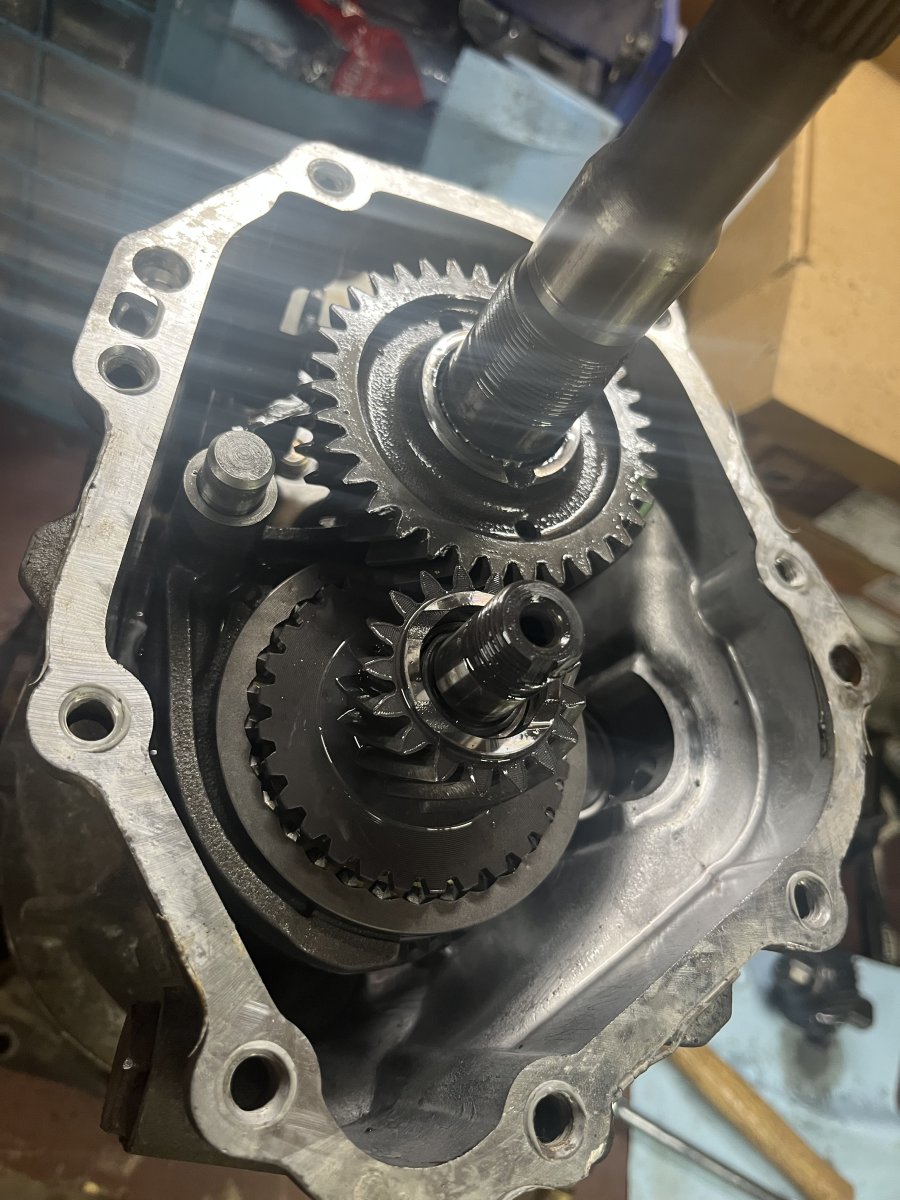

Can you change the 5/R cluster with the transmission in the truck?
I helped my brother rebuild his a few weeks ago and it looked like you could do everything needed by just removing the tail housing.
It's interesting to hear about the issues you've had with the aftermarket gears. The engagement gears on my brothers R had the points worn off, but we reused them because we didn't want to wait for a replacement set. Maybe it's better we left the originals in there.
I am pretty sure you can. Getting the big main shaft nut and a bearing or two might be difficult but not impossible.
I think the aftermarket parts for these are hit & miss after my failures. One example was the input shaft pocket bearing. At the time you could literally get them on eBay for less than $5 SHIPPED. It looks exactly like what comes in the rebuild kits. Same part? How good is a bearing that costs that much? Who knows but it wore into the input shaft a bit and came out in pieces. So was that a bad bearing or a bad input shaft? I don't know. Synchro rings in the kits... are they really good quality? I doubt it after one of mine started grinding prematurely.
I'm also kind of suspicious of the rebuild books. There was some conflicting info I found in one, that I can't remember now. Also for setting up input bearing - I remember reading several of AllanD's old posts where he said to shim it to where there is a tiny bit of preload. The book says NOT to do that. I tried shimming just past zero as he suggested and it was very hard to spin the input shaft or anything else for that matter. The book specs resulted in a tiny bit of runout that bothered me. Rhetorical question: who's right? Both? Neither? Were my parts out of spec? Something else?
No need to have that discussion here, I just wanted to point out that there are a lot of factors in these things and it can be really hard to pin down failures on one thing.
I didn't do the work on my transmission. My brother, a professional mechanic, did the last 5th gear and slider replacement. It was out of the truck, but I think it could be done in the truck with the tail housing/adaptor off. I don't know if the complete R/5th gear cluster could be done out of the truck, but I would guess it could be.

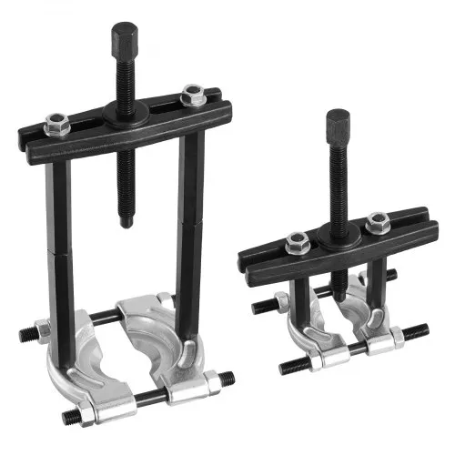

Do you guys have 9+" deep jaw pullers? I've always taken the rear main bearing off with a brass hammer + big prybar, and I would rather shut my hand in a door on purpose than lay under the truck doing that part.
And that's assuming the 5th/rev slider will come off without lifting the forks out of the way?
Come off easy enough with a bearing splitter.
Hf one is shitty, but it did work.
