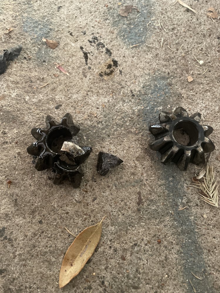

Well looks like swapping spider gears is out
58492
58493
I did pull out a wavy piec of metal
Yes, that whole assembly looks un-rebuildable, IMO

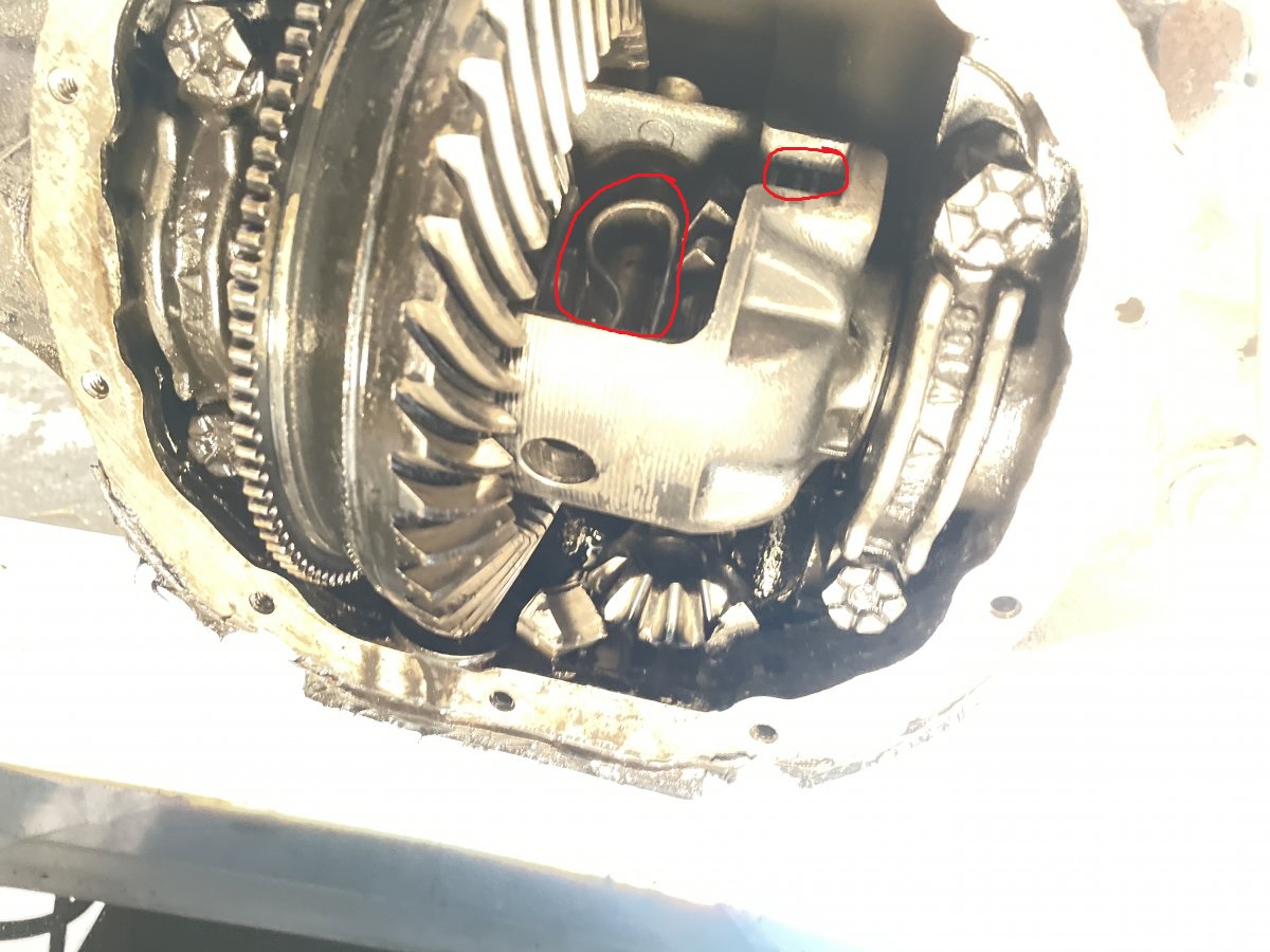

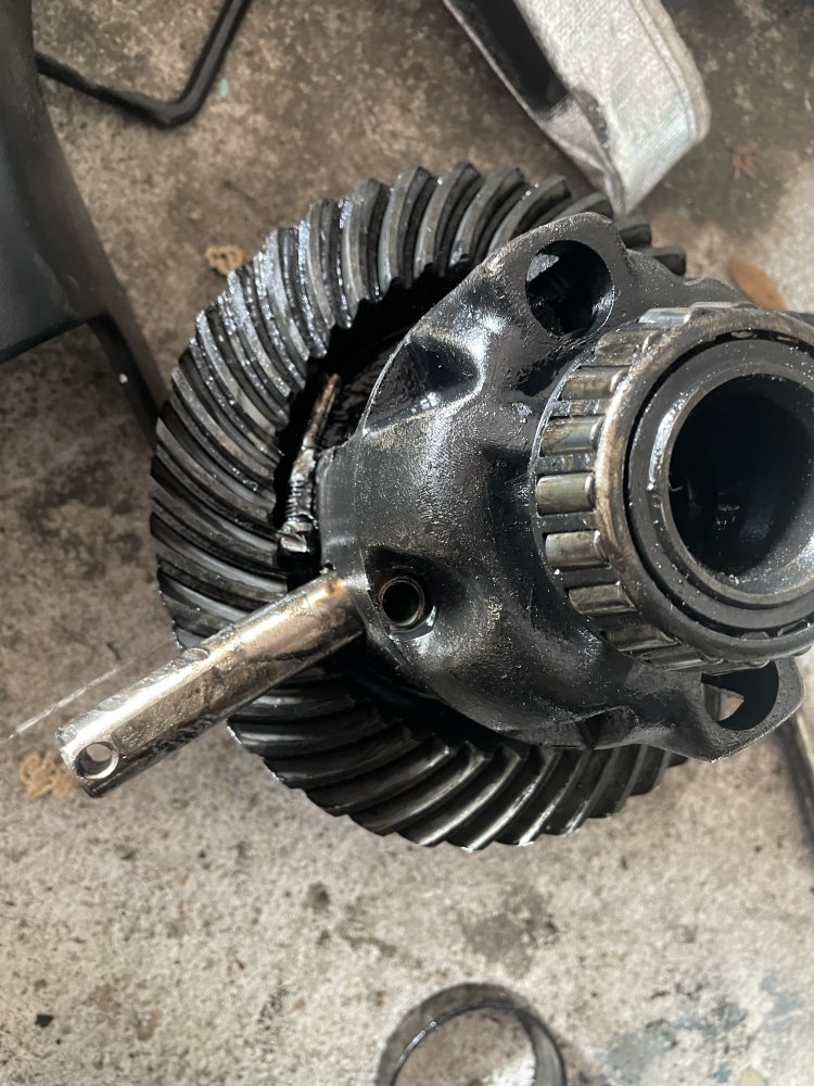

He has a limited slip. His pictures have the trac-lock S spring and I can see the tabs of a clutch pack peeking out... it's a limited slip.
As for the reason this happened: My guess is that the cross pin bolt loosened up and fell out, which caused the cross pin to fall out, and the spider gears followed.. Lack of thread locker? Age? Who knows.
I still wouldn't write off that axle - I don't see any gear damage, but check the cross pin hole very closely, like I said if it's egged out, it's junk. If the cross pin hit the pinion gear and damaged it, it's junk. Either of those scenarios would lead me to suggest a junkyard axle.
