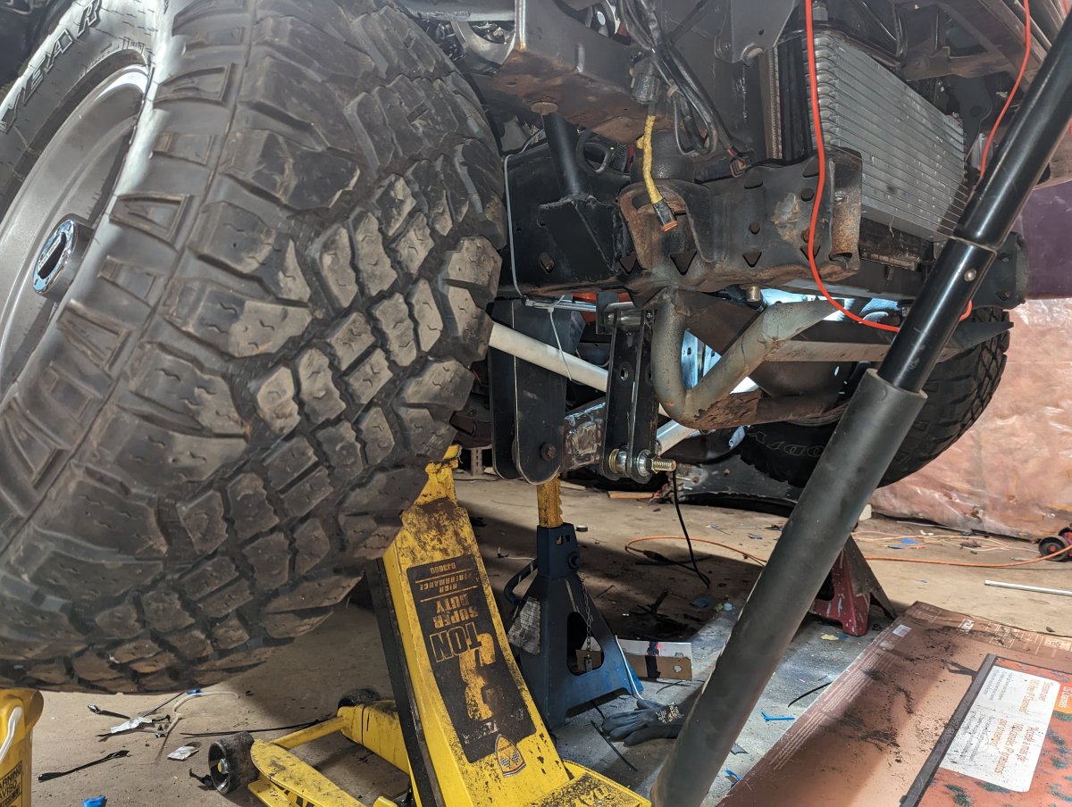

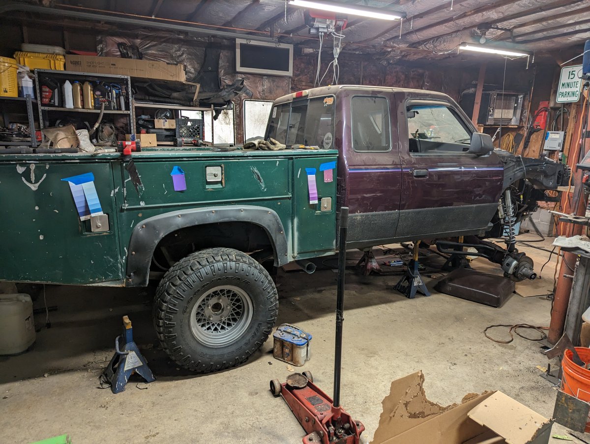

Passenger side is coming together again now. Axle is back together and you can see where I extended the axles shaft. Welded a 4" piece in the middle then sleeved it and plus welded it. I doubt it will hold up but we'll see. 16" shocks in and they sit much better. Travel is what I expected now.

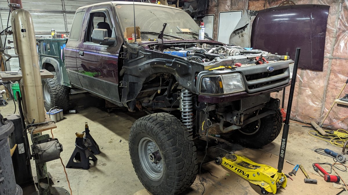

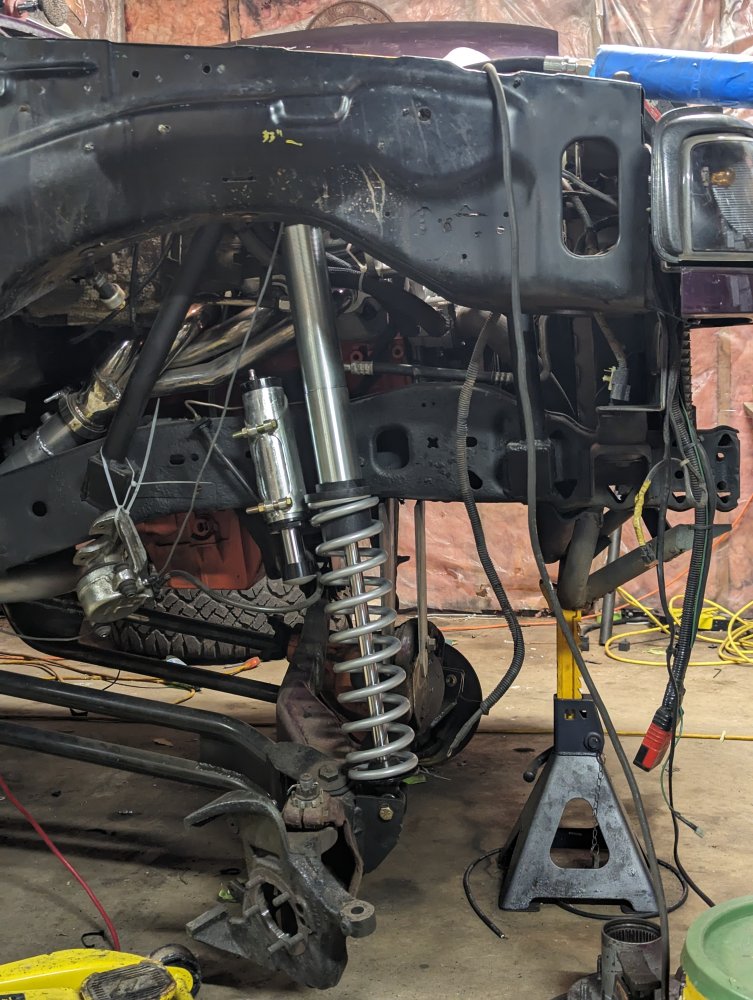

Well bit of an update now. Front end is mostly together now, just need to do steering next. I've got that all calculated out. With a 5" pitman arm I can put it to 8" long idle swingers and have 111° of steering angle with 3 turns of a steering wheel lock to lock. That one took some math to do. Coilovers are in and welded, truck sitting on its own weight with 16" coilovers on 300x16"/400x18" springs. Has about 1.5" of preload. I expect it to drop down a little more with bumpers and sheet metal which should be the perfect ride height.
LS swap! finally

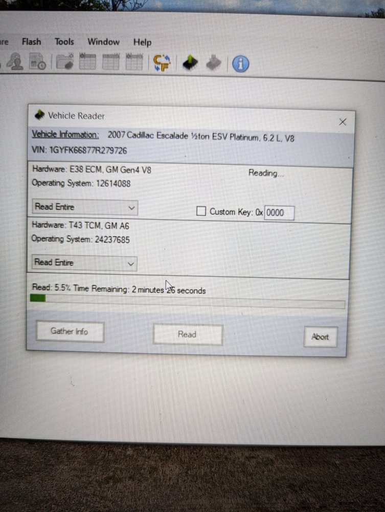

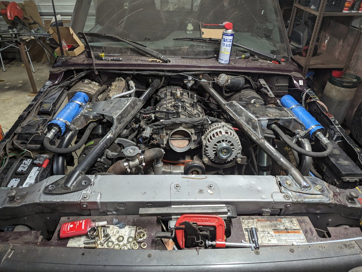

I also have tuning next too, this one has been a lot of work. Doing this all with HP tuners. 09 e38 and a 07 transmission. These should work together but won't work nicely without tuning, which I should be able to do as it's very specific to application. Then make sure my gas pedal and throttle body work together. Truck is fully wired too. Turns over and has zero battery drains. I'm very happy with how my battery wiring is turning out

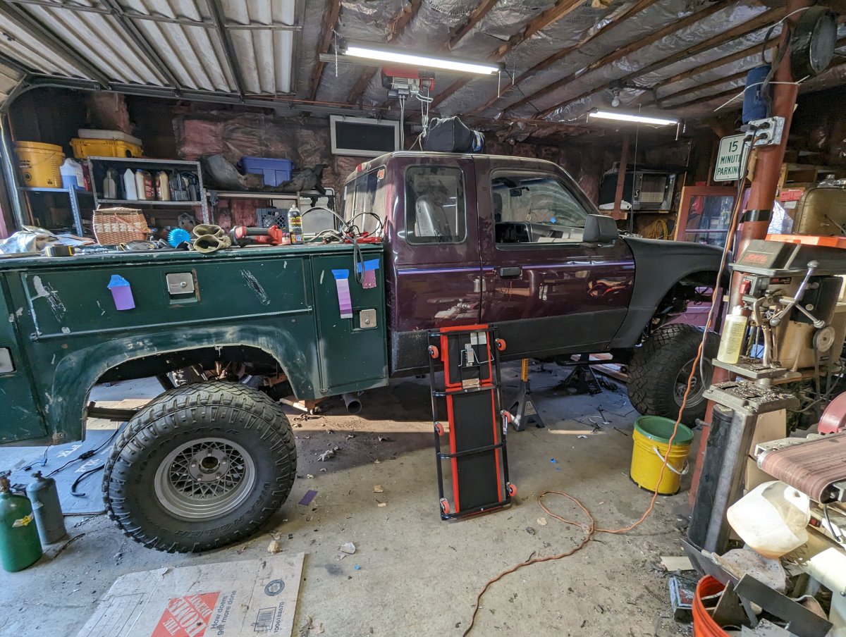

Update to everything. Spent a lot of time learning here. I messed up my wiring combined with a pretty damaged harness. I gutted everything and start over fresh. Redid my body wiring harness and verified everything worked. I bought and re pinned my own harness for the motor side and spent a good amount of time learning what everything does. My Mistake was thinking the canbus network is a bundle of snakes. Instead its a pretty clear daisy chain system.
It now goes OBD2 port w/ resistor - 6L80e - e38 ECU. Not retaining body control module so I also swapped to a 4 wire alternator instead of two wire.
Here's my 6L80e wiring if anyone wants to double check it. Transmission plug first then circuit and where it goes.
Based on a 2008 4x4 6L80e truck

Going to spend all Saturday and Sunday wiring the truck again. Hopefully first atart will be Sunday evening. Then all thats left is a handful of hoses. Make sure everything works and finish up my steering.

Tuning is hard. I have no idea what im doing but im going to figure it out. First time kinda running here. Almost falls into a choppy idle before dying.

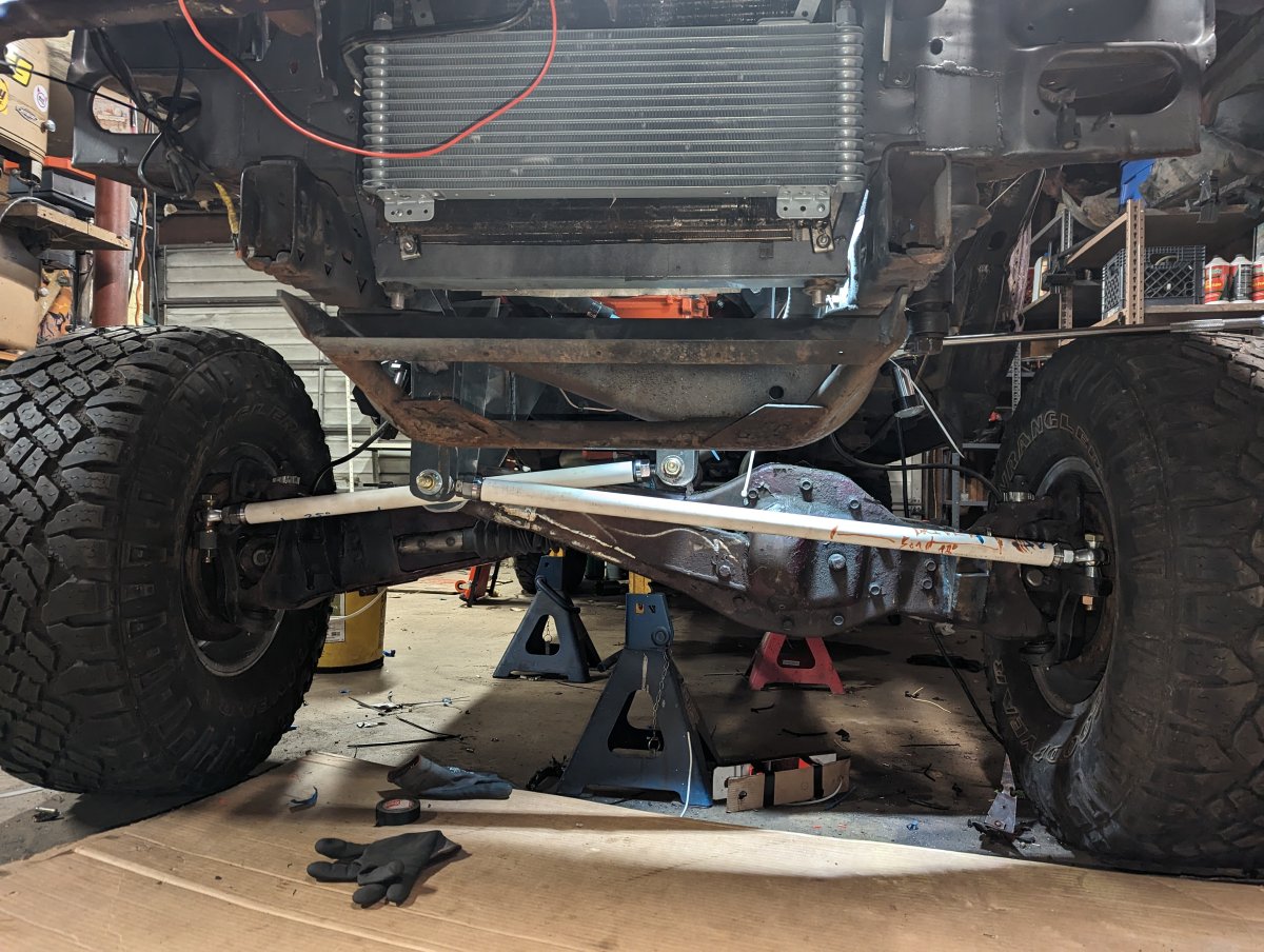

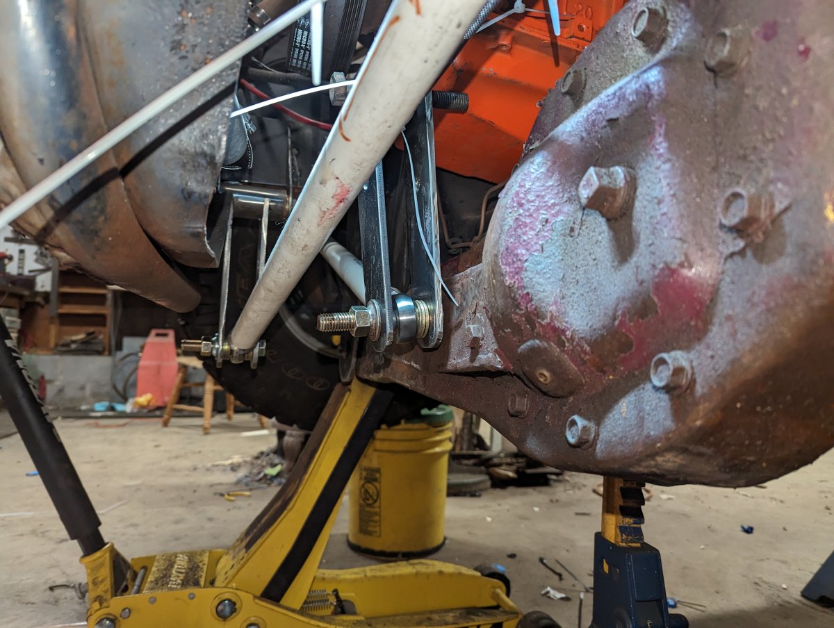

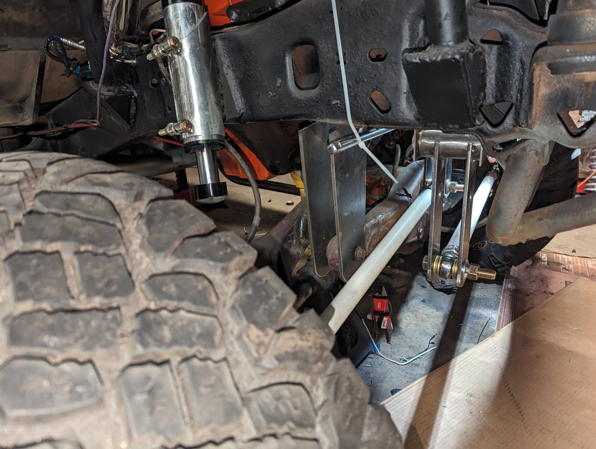

Another update. Engine wiring is 99% done. Ended up paying someone for the tune just too much to learm right now. With that I'll know i have a good tune and can just focus on troubleshooting any issues that pop up. Power steering is wrapped up now too, got a line made a my local hydraulic shop. Only a $132 for a whole new line made. With that done i got motivated to started on steering again. Got both swing arms mounted, high raise drivers side a tad. Both pit man arms need a little bend in them. Passenger 25° and driver 15°. I will have full steerings from bump to droop with ZERO bumpsteer at all. If anyone has 5/8th hiem spacers let me know, everyone is back order for another month.
At ride height
Side angle
Full bump
  • LS swap! finally
I'm too lazy to go back through your post... but did you cut and turn your beams? They seem angled down pretty good. Looks awesome though, love the steering setup
Yep cut and turned with a 3" drop bracket. Everything just looks weird because stretching the wheelbase made the brackets look extra long

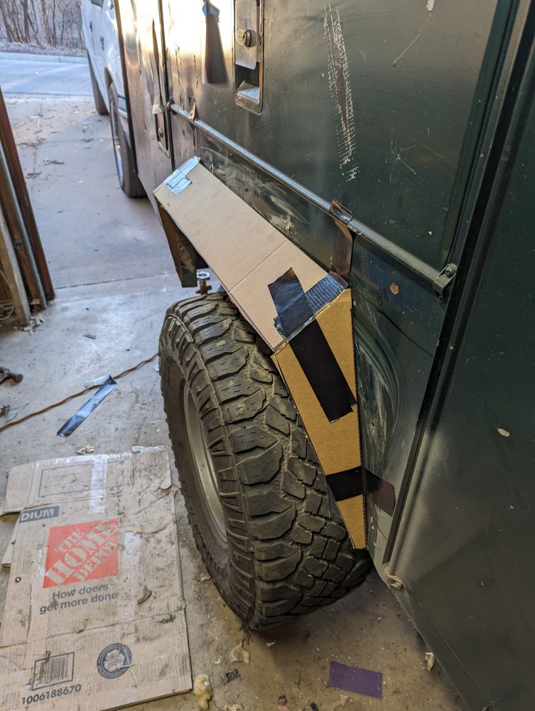

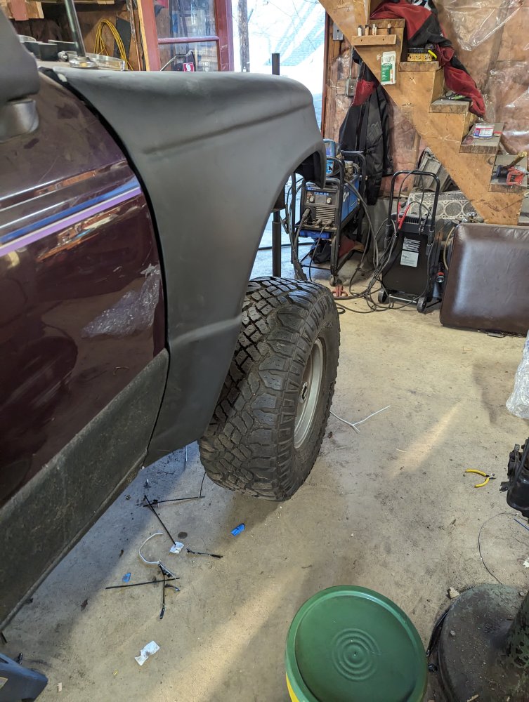

Got my fiberglass fenders in. Definitely an ebay gamble but they fit. Need way more tire though, 37s it is.
