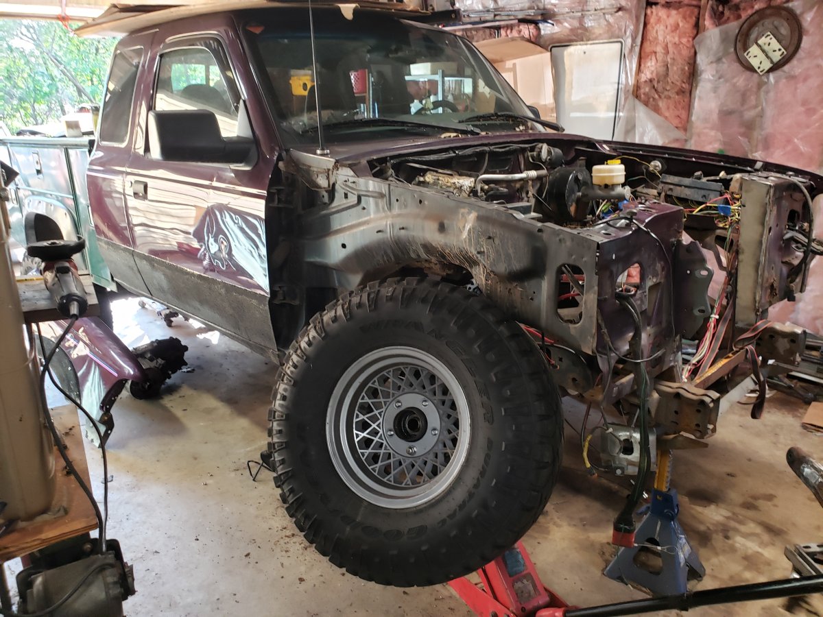

Yeah just don't ls swap your ranger. Nothing fits at all. Was gonna SAS but I can't give up on these beams. Just too much time and effort in them, plus I can't do anything the easy way. Couldn't get the engine to fit at all comfortably. Too close to beams at full tuck but why do I need 23"+ of travel. Pushing the entire front suspension forwards 3" and moving the mounting points out 2" each side. Or I might add 2" to each axle beam. Well see

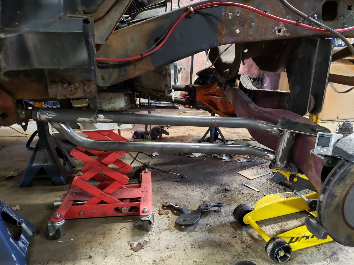

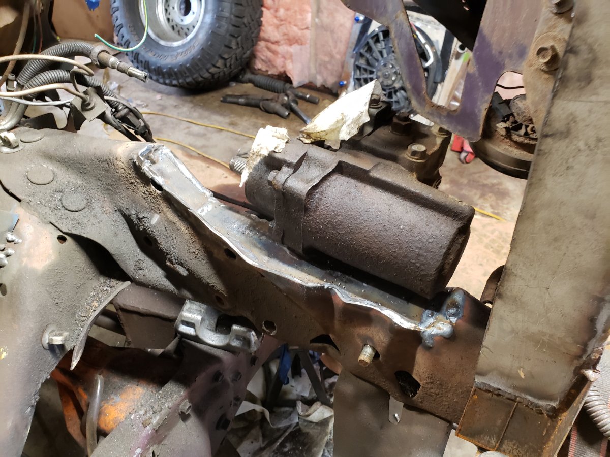

Still coming along. Haven't touched the V8 a minute here, motor didn't fit with stock steering box and with pushing the beams forwards I ended up using a Toyota ifs box. Extended the beams too. This helps way more with travel and tire not completely eating the fenders. Gonna use 2.5x14" coilovers for this. I've got everything ordered except for coilovers now. Need to finish beam mounts, put motor in and then I can weight the truck for coilovers. I already took down front end unsprung weight. About 550lb with drivers side beam being heavier. Swingset will add probably 30-40 lb but that's a non issue. Knowing from what I learned the first time around in excited to build this next set. I'll need some fiberglass pre runner fenders but I'm not willing to spend over 450 dollars on shipping them alone.

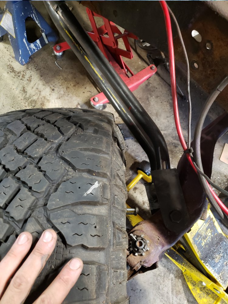

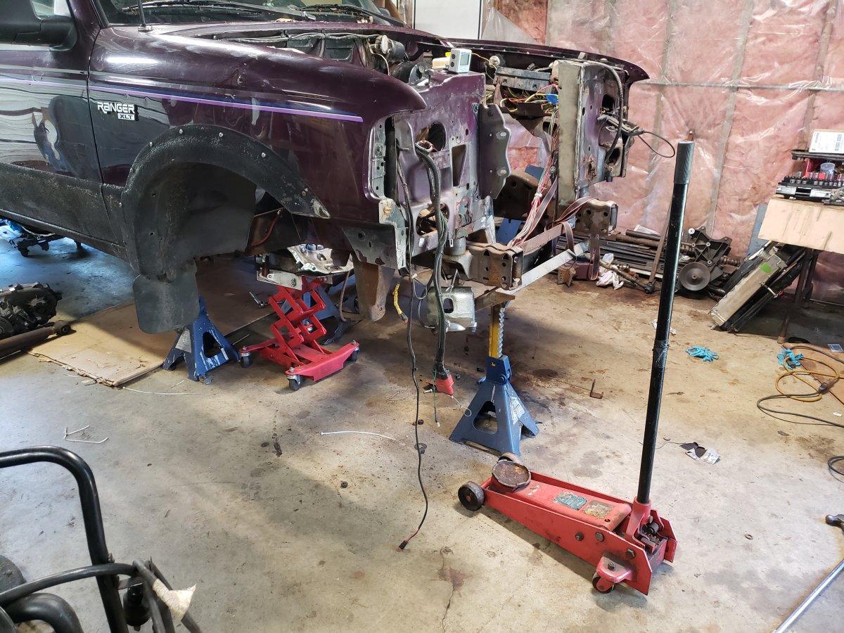

Alright I guess this is a suspension rebuild thread now and not even V8 anymore. .188 wall 1.5" Dom. Looks way cleaner than the old arm. Couldn't reuse the last ones and these "should " clear 37s with minimal rubbing, I can always add front wheel spacers back but then the track width front to back will be wild

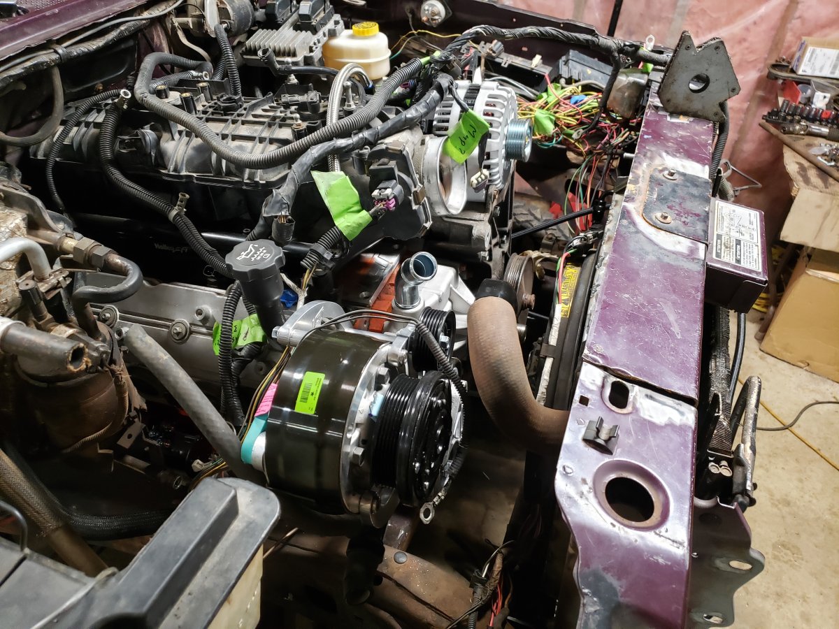

Everything just kinda fell into place now. Gonna order coilovers next and get started on that once they arrive. Moving the axle forward was the right idea. Working on plumbing, wiring and headers/exhaust. Then I'll pull everything to clean it all up, finish final welding touches and paint.

Weighted the ranger today for coilovers! 1250/1192 front and 1010/987 rear got my coilovees on order now

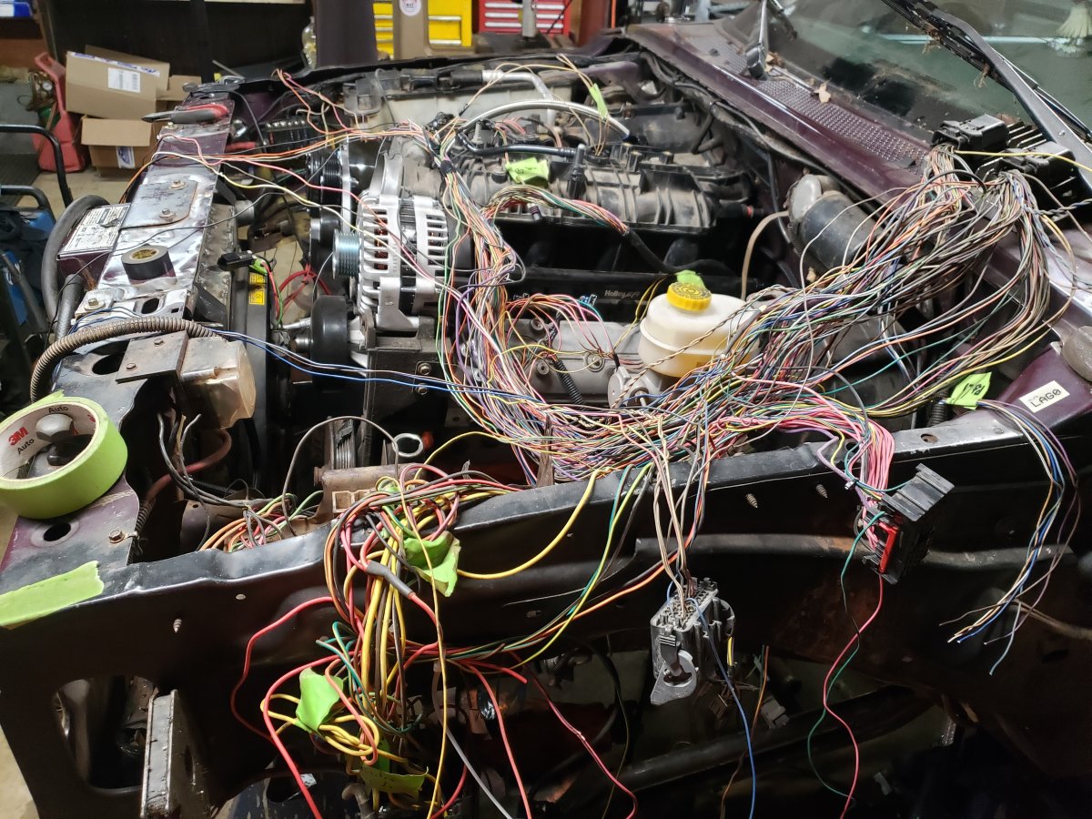

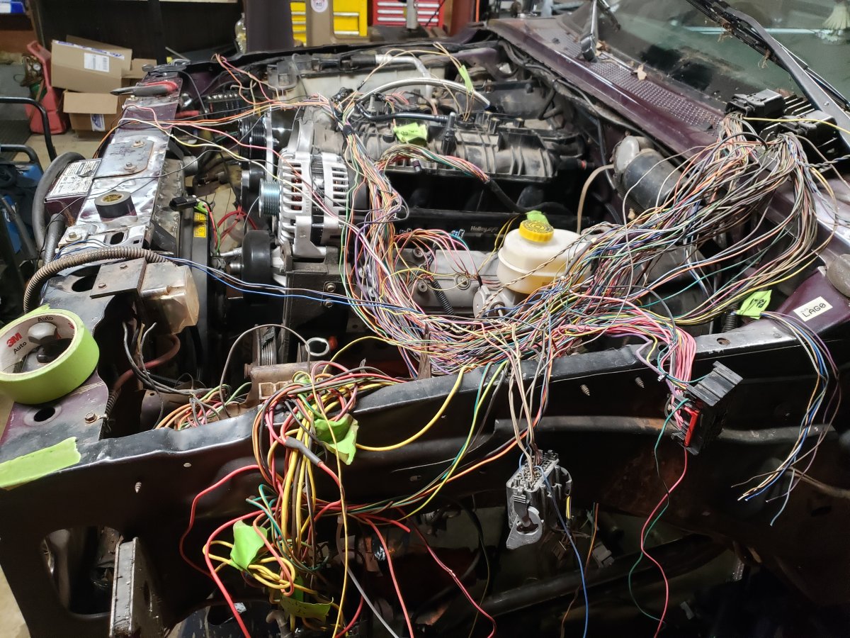

Rainbow spaghetti! Getting tired to fabbing and waiting on coilovers plus I need to fill my welders gas. Wiring is something I weirdly enjoy. LS computer is controlling engine and transmission. I'm still using the ranger side for climate controls though. Transfer case is manual shift.

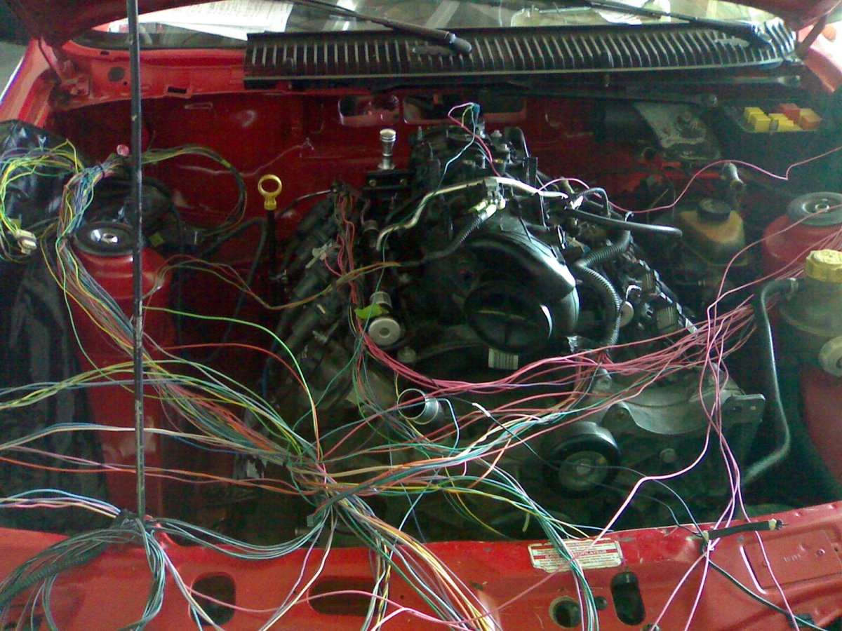

Reminds me of my Old Ls 4.8 swap into my XR4Ti but I wimped out with a 700r4.. and a very pared down chevy express loom.

As someone that has made several engine wire harnesses by hand and drawn many for work, engine wire harnesses aren't rocket surgery as long as you know where the wire goes at both ends and how you want to route it... the hard part is starting with one that's already a thing and making it into what you want then it gets into a spaghetti mess for a while until you clean it up...
