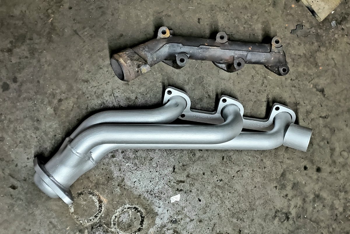

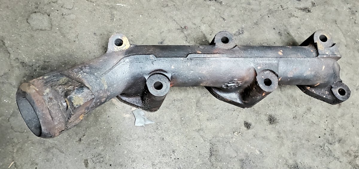

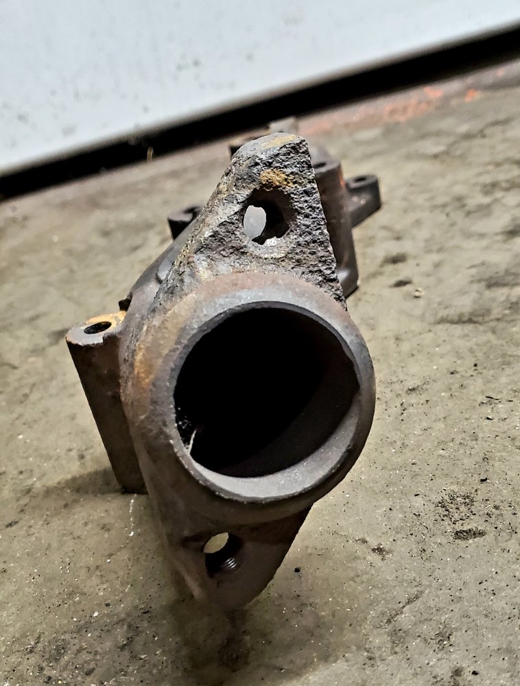

This is what the end of your manifold looks like.
Also, 2.9 manifold vs 2.9 header
Yeah it was a *pipe* dream.

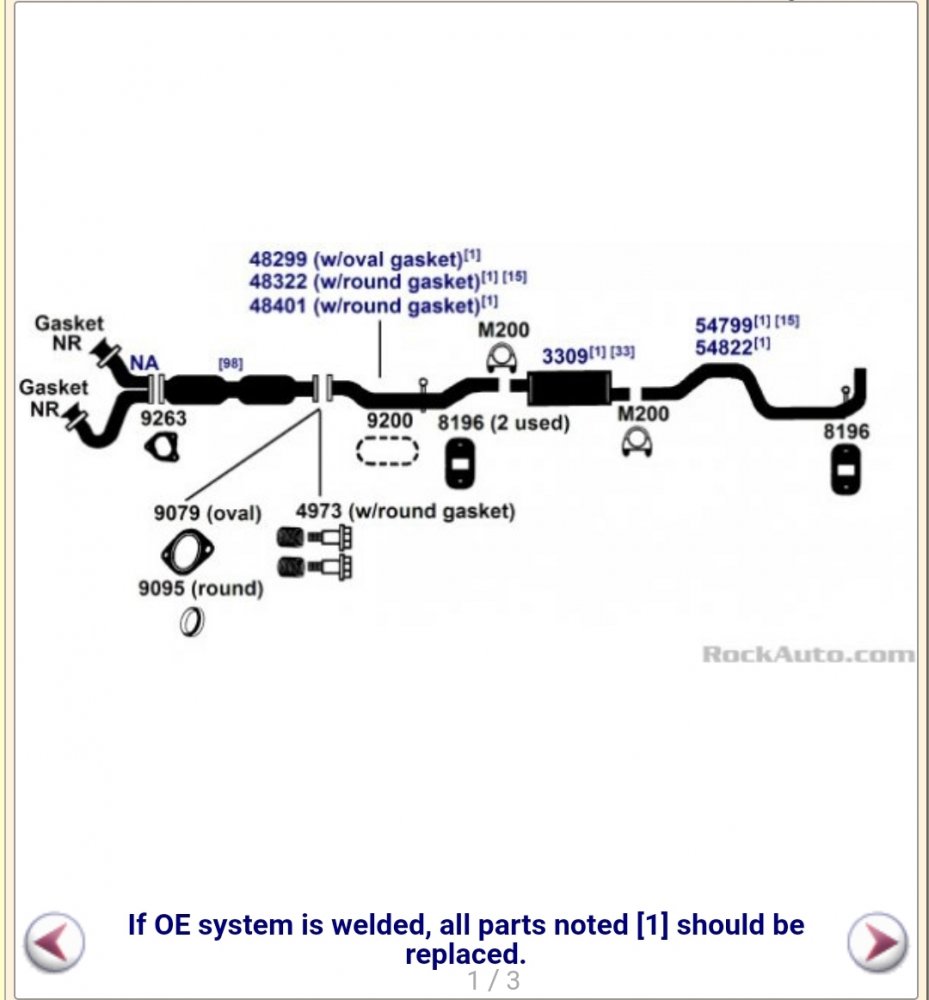

Rock auto says no donut.

Y pipe is $50 on Rock auto. Dirt cheap item.

I can’t tell for certain from the picture. Chances are that the original bolt rusted to the point that it broke and a piece is stuck in the manifold flange.
The removal of the remaining piece is going to be the challenge. If you had a quote from the shop like it sounds like you did. It would be factoring in that problem. It will either require removing the manifold to work on removing the piece or removing the manifold to replace the manifold. Both are going to be a big job.
Even trying to drill out the piece with the manifold in place and not bugger up the flange is going to be work. Factor in the average $80-$100 per hour shop rate and materials, it’s going to add up quick.
