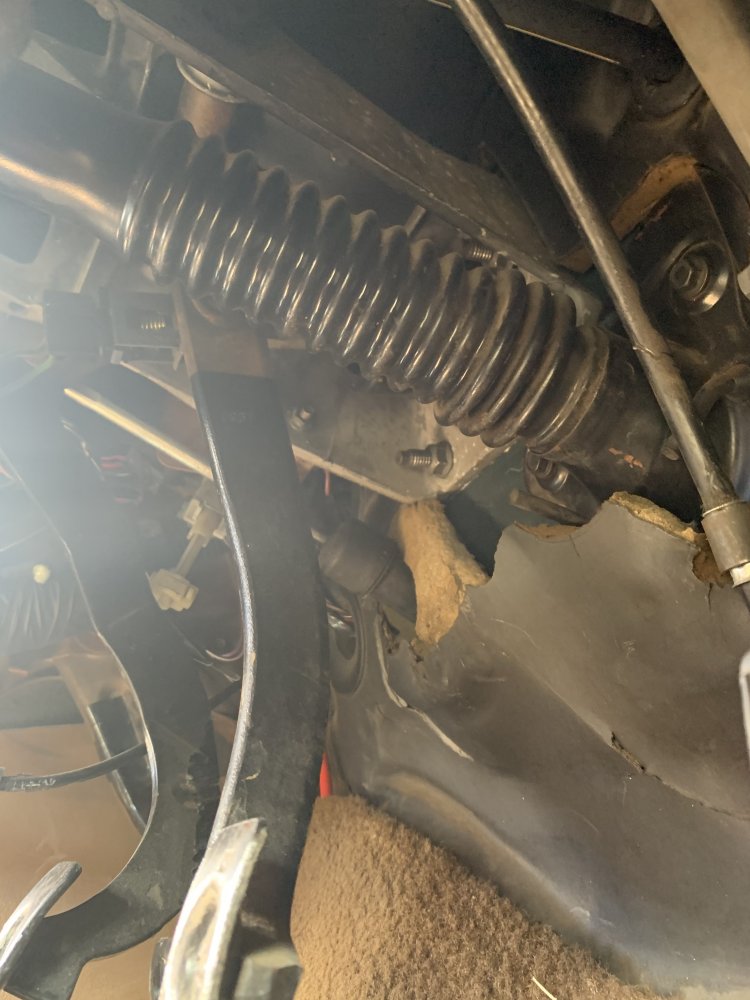

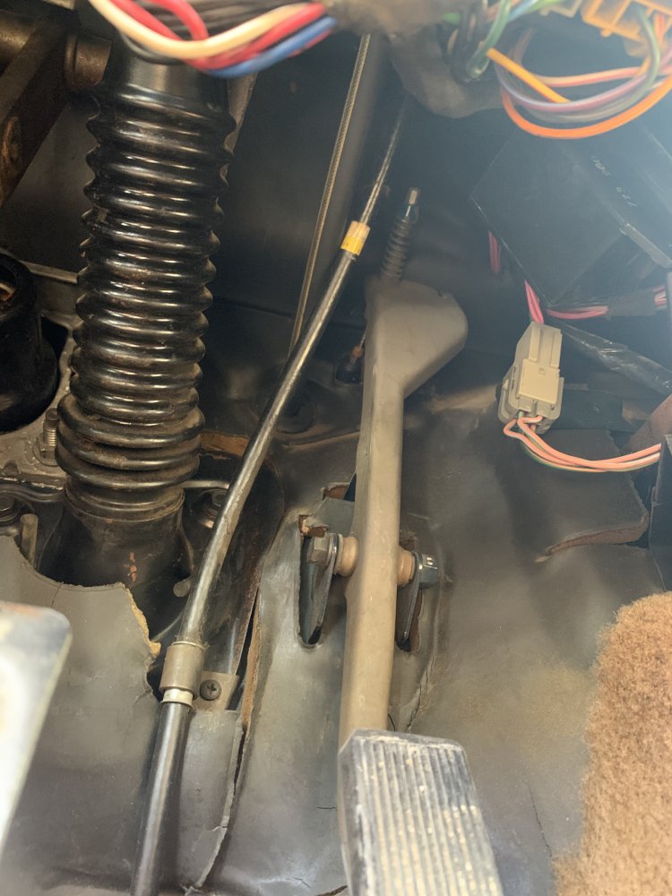

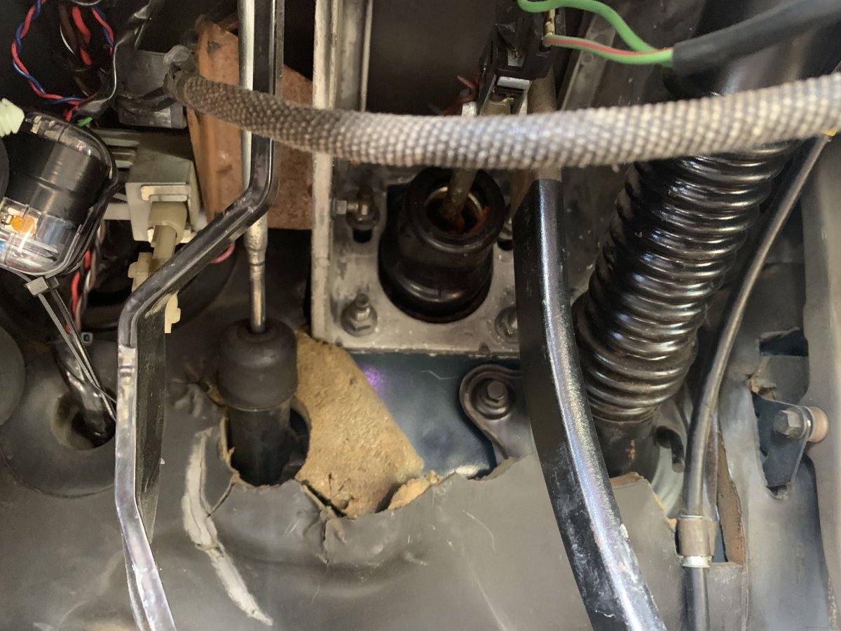

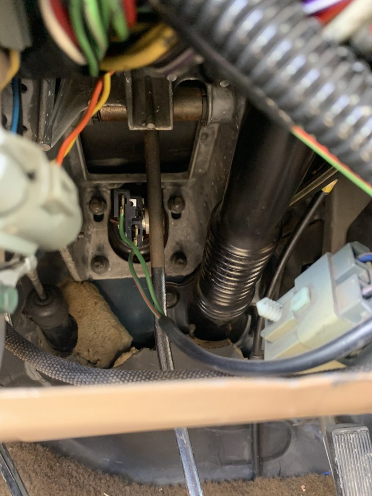

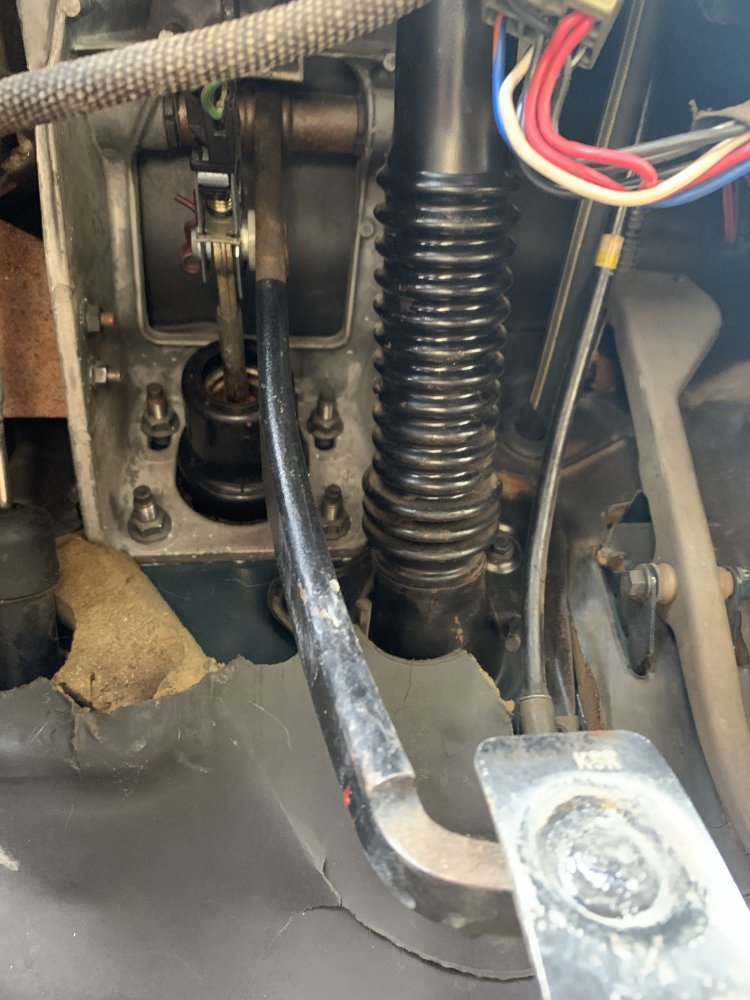

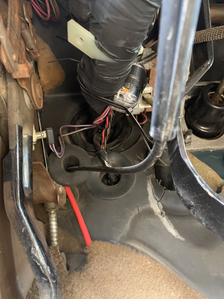

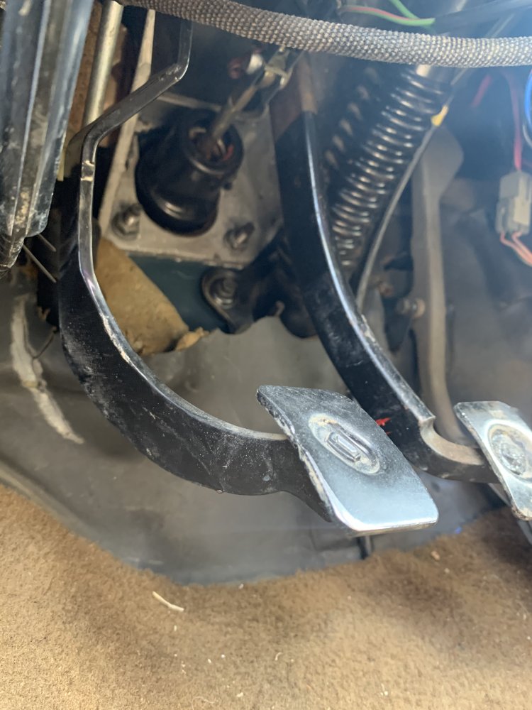

Here is a few pics of it. I took a look but I’m not to sure.

Tucked up behind the dash should be a big plastic box with a bunch of wires going to it. That is the speed control amplifier. See if you have that. You should also have a servo under the hood with a cable attached to the throttle.
There should be a lightgreen wire leaving the amplifier going to the lightgreen on the brake pedal switch. I thought this wire would be a normally closed circuit, but I am looking at the diagram and it will only lock out the cruise if it has voltage on it. So if you find it, it needs to be hooked up but it would not keep the cruise from working if it wasn't.
Go out to the servo under the hood. It should have a vacuum line going to engine vacuum. It should also have a vacuum line going through the firewall and down under the dash. This is the one that went to the dump valve on the brake pedal.
Make sure the VSS is hooked up at the transmission. Speedometer cable comes out and there is a two wire electrical connector there too. Also check for pinched wiring.
If you have a hose feeding the servo from the engine... fun fact if it isn't draped across the brake booster just right the hood hinge will pinch it off. Good times diagnosing that one. It worked fine as far as I could test it but with the hood shut (the only logical way to test it on the road) it wouldn't work.
