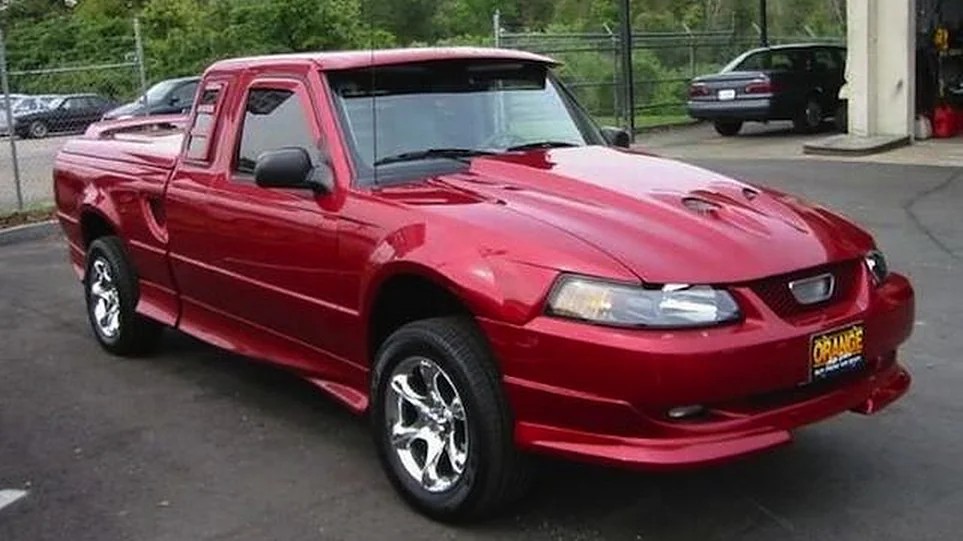

Definitely crazy what conditions old engines can operate under and still work. I was always under the impression that if it starves for oil, you’re cooked after a couple of miles. Anyways, Solid idea, maybe do that alongside jacking up the engine enough, disconnect bell housing bolts to be able to access the bottom end and get a look at that pump and properly clean out the pan. If it gets me some sort of oil pressure so I can still drive to work while I gather parts/cherry picker for the eventual swap. My eco boost mustang I’ve been using doesn’t make a very good work truck.
