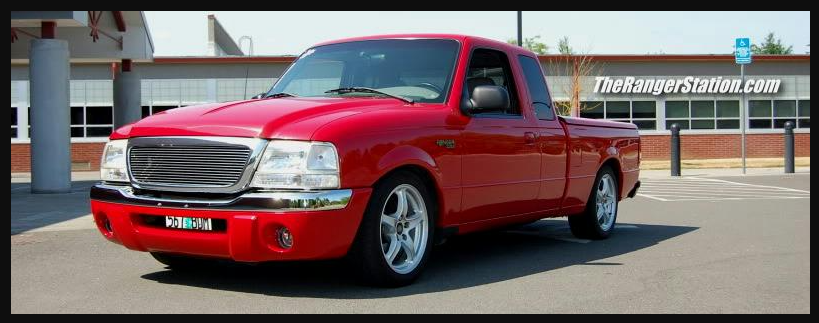

@stmitch has a sweet stance on his ride.

@stmitch 's build: https://www.therangerstation.com/stmitchs-supercharged-3-0l-2000-ford-ranger/

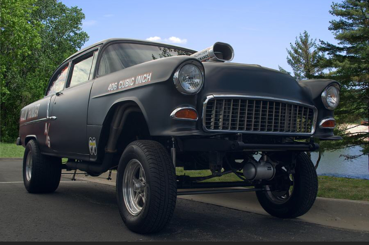

If you get just the flip kit without shackles it’ll slam you down to 5” and a 3/5 stance will make you look like a gasser which isn’t a bad thing either. Gassers are sweet, but that’s not the look you’re going for.

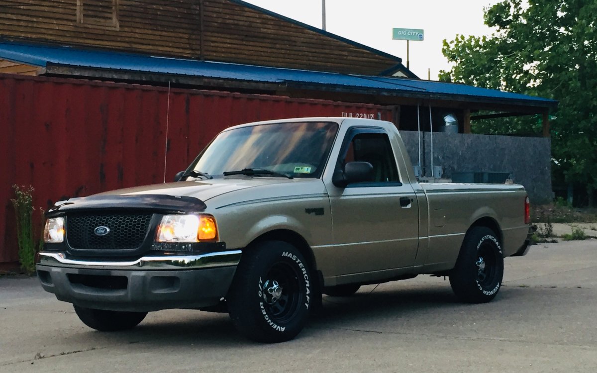

Here’s mine at 3/3:
Nice! To bad mine has torsion bars
