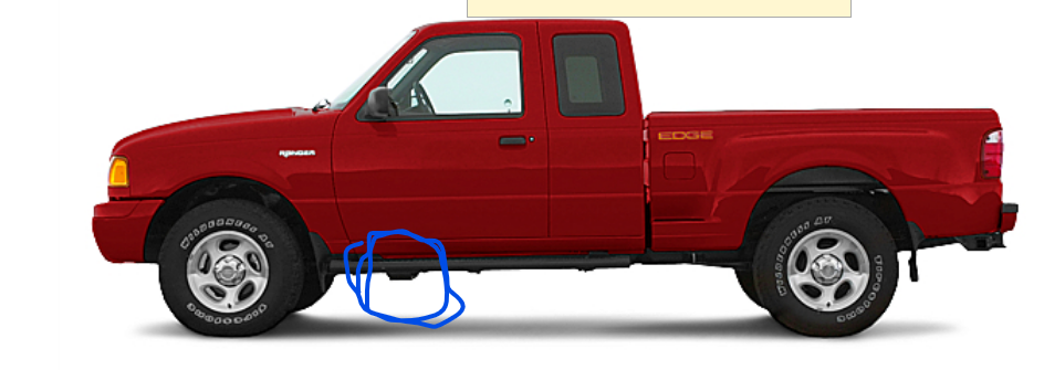

looking to lower my 98 Ranger but im new to mini trucks
easy way to check is to stand back from the truck and look under the area where the seat is. if there is some big rectangular deals welded there, its torsion. if the under side looks smooth and normal, its coil.
or lay under and look in that spot. if there are some garden hose diameter bars running from under the seat area to the control arm, torsion bars it it
  • looking to lower my 98 Ranger but im new to mini trucks
You have an XLT, so I'm pretty sure you have coil fronts.
Yes i do, sorry again for being a newbie but one last question. IF i went with the 3" / 4" kit without shocks, i couldnt keep my factory ones correct? i would have to end up getting new shocks anyways? just looking at budget and all
