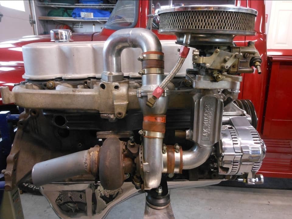

Sounds like you want a real Junkyard Dog type. you might like this.
i sure do
32247
32248
Someone just posted these pics in a 73-79 F-series group on Facebook... I figured you'd like to see it.
