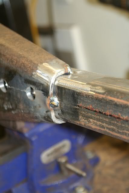

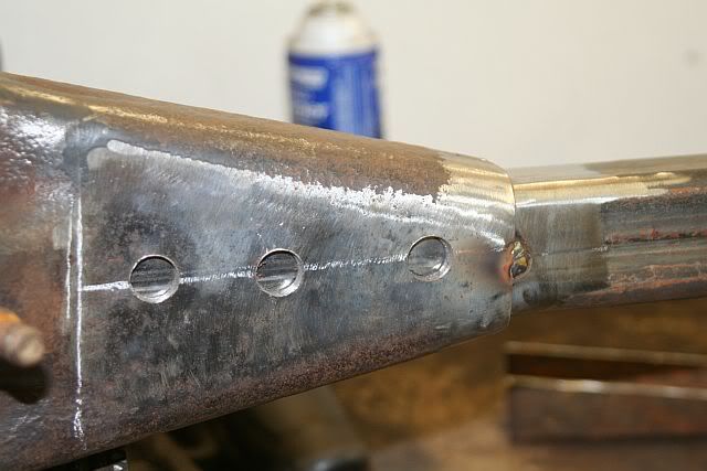

Build them yourself if you have the welding and fab abilities.
Its cheap, you only need like 5 feet of 2x2 square .250 wall tube, and some misc 1/4" flat plate to make mounts.
Here's some pics of mine that I built.
Dang, I know it's been said, but Ryan your welds are a thing of beauty!
