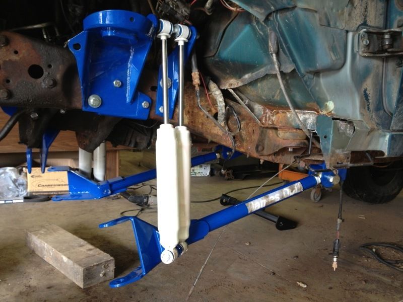

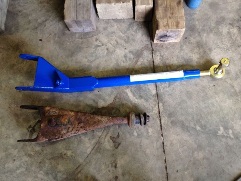

The Duff kit replaces existing drop brackets and the entire radium arm mount. The Duff kit replaces the existing transmission cross member with a new one that the duff arms bolt to.
You will keep drop brackets on your axle beams.
Here are a few photos from when I installed them on mine:
