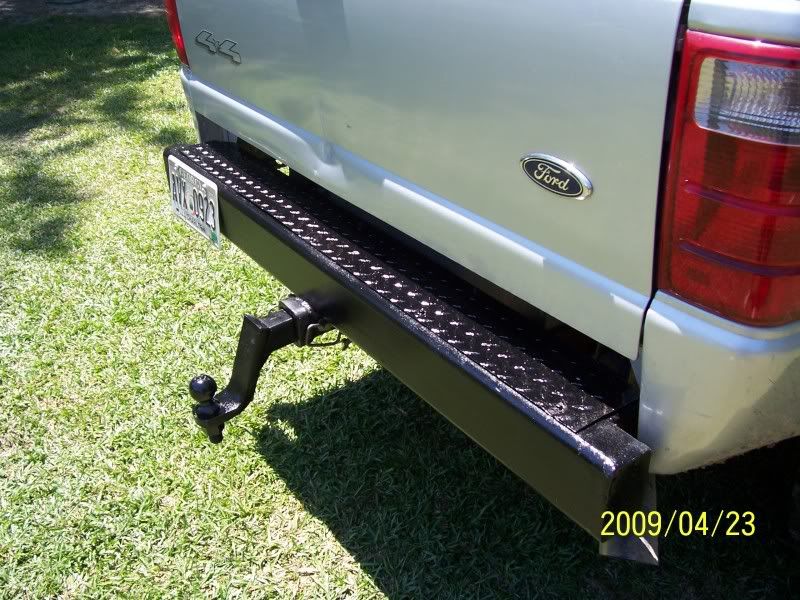

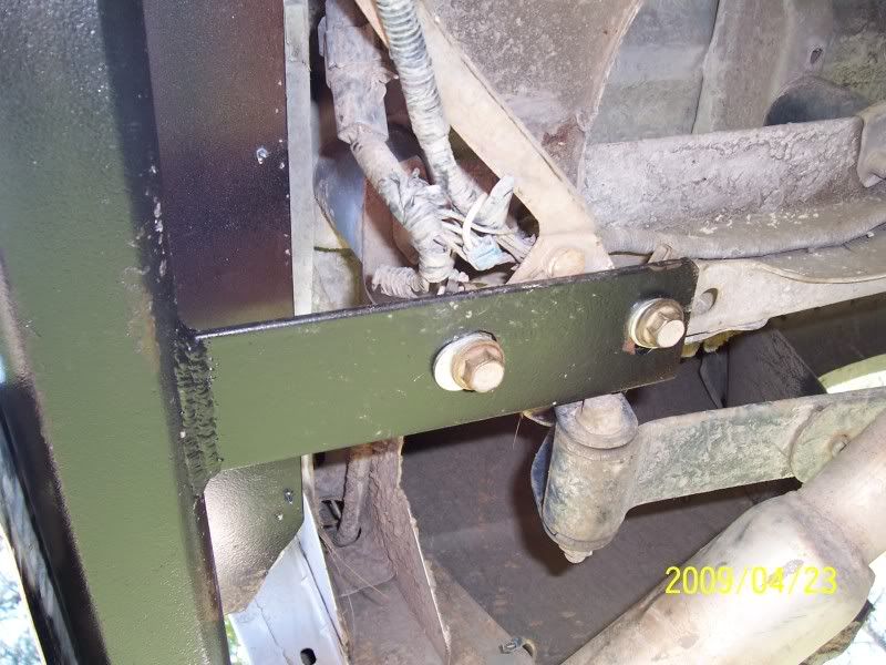

Heres some better pics after i finished painting it. and one of the mounts

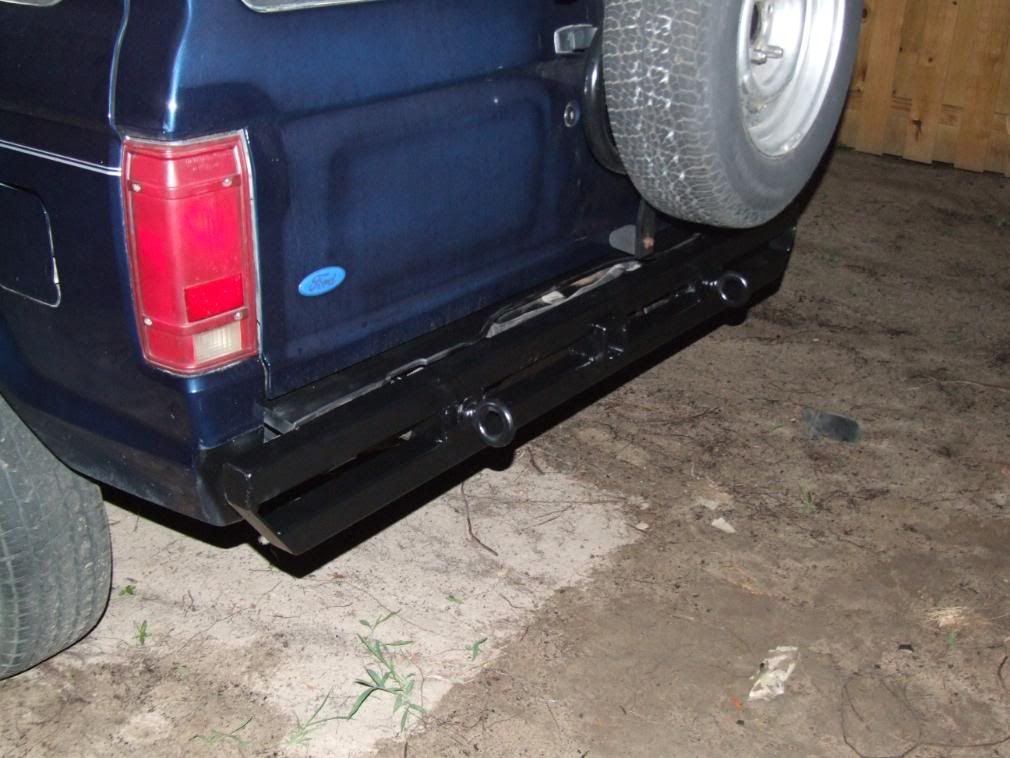

At last got a day to play so i got the rear bumper built, used some idea's i seen on the site and put them together, So thanks for the idea's.
Going to put some back up lights and hang the highlift again.

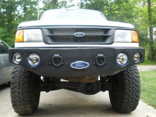

I made mine out of 1 1/2" 11ga tubing for a frame then covered it with 1/8" plate. There are two back up lights as well as two d rings on the rear and four lights (2 6" and 2 5") on the front along with d rings. There is also a 2" reciever front and rear that is reinforced with 3/8" plate.

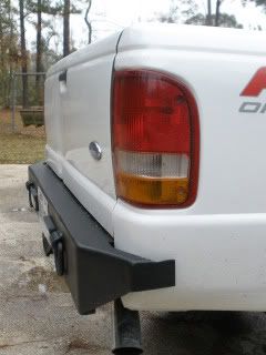

Ok here's my contribution to the bumper thread...I fabbed these from a bunch of scrap I had around.

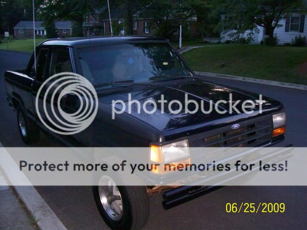

workin on a bumper for my 93 i still got a lil ways to go but i think its gonna look sexy once im done:icon_welder:
