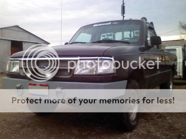

camodown, I like that bumper you've got. And the license plate is the right color too..... :icon_thumby:

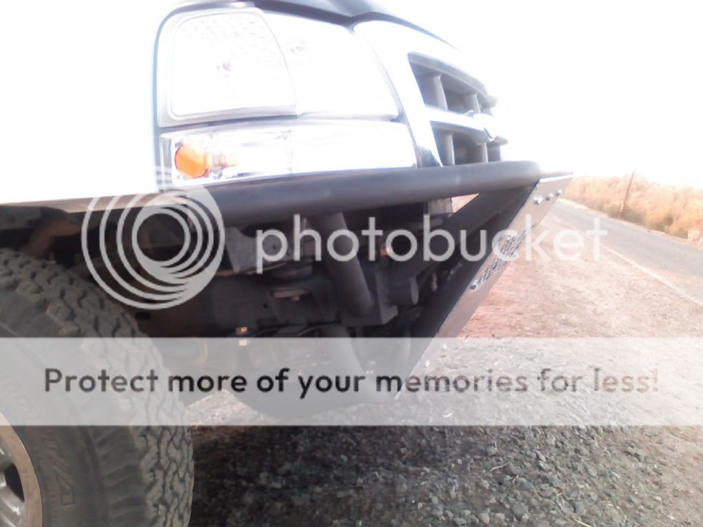

heres mine I got it last week from White Rhino Fabrication
I think that makes two white rhino fab bumpers in this thread.
God damn their amazing, how much did you pay for yours?

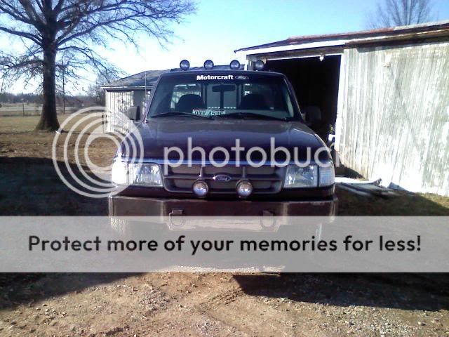

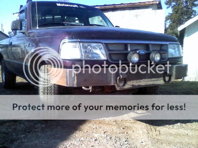

Planning putting lights in it still. Made it all out of 1/4 and 3/16 steel.

Looks good. Bet that thing weighs a ton though. How is it mounted?

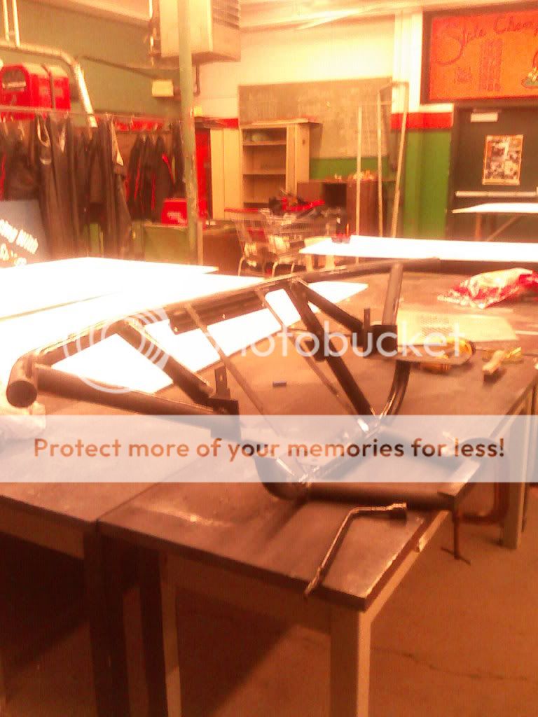

I'm hoping to have mine done here in a week or so.

It doesnt weigh as much as I expected it to, I would say it is around 60 pounds it doesnt sag the front any and even if it did I doubt it would sag down 10 inches to where my old bumper with the 4x4 foglight valance was. lol.
To mount it I reinfoced the frame horns then bolted it on with four 1/2 inch grade 8 bolts. There are peices of 3 inch angle iron welded on the backside of the bumper that bolt to the frame. (almost like the way the stock back bumper is set up). I will get pics of the backside tomorrow if you are interested.

i LOVE the white rhino fabrication bumpers. i must get one
I paid alot less than what he normally charges, if I am not mistaken I was told he usually gets $500-$600 for them, and the best part is that its built to your truck so every one of them is a little different
