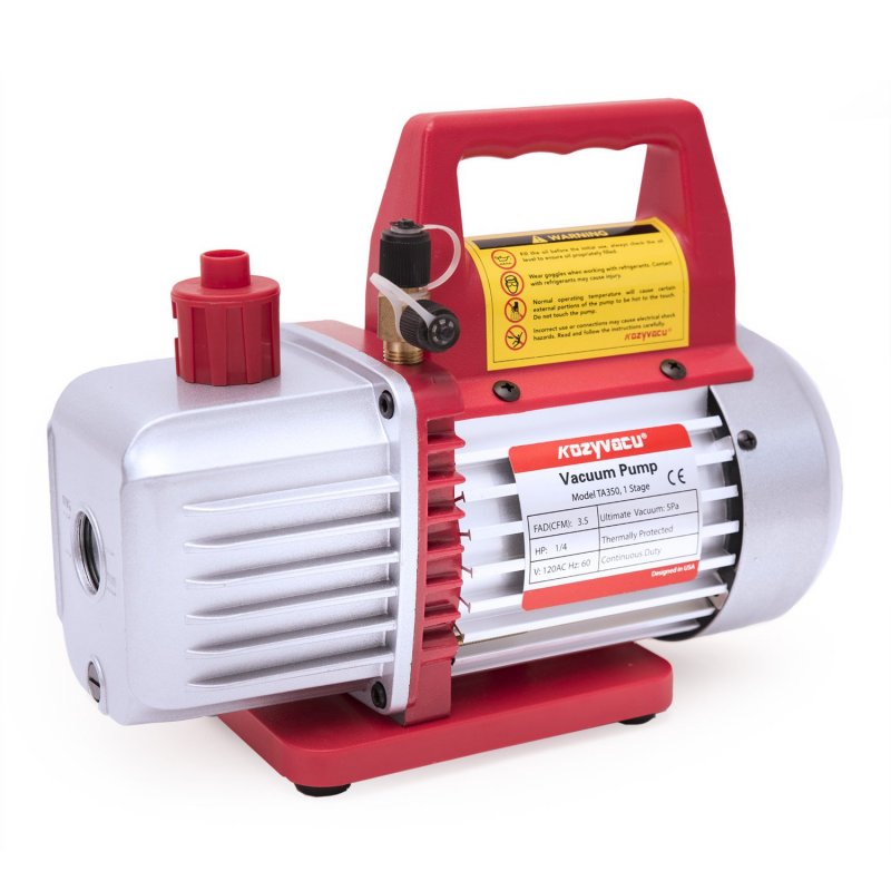

I got all of the hoses crimped, installed and tightened down, and my manifold set and vacuum pump hooked up. It's been running about 15 minutes, and so far it can only pull down to 25 in.hg vacuum. I was skeptical about this little pump, but I'm gonna run it a little longer and see what happens. It could also be the fact that I have it hooked to a long extension cord, which could be lowering the supply voltage to the pump..

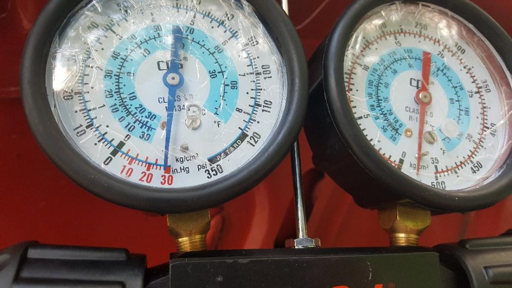

Well, newbie mistake. I forgot to zero out the manifold gauge set. After I zeroed the low side gauge the best I could, and opened the valves again, the pump was pulling down to around 29in/hg. Acceptable for me.
After about an hour or more, it hasn't leaked down any. I'm going to leave the gauges hooked up overnight to verify there are no leaks. I'll pull vacuum for another 30 minutes or so tomorrow if it hasn't leaked down, just to try to minimize any moisture in the system. I did my best to keep everything sealed up over this entire debacle, and when working on the system, if I opened anything up, I put the sealing caps back on as fast as I could..

I will say a couple things about the little "Kozyvacu TA350" pump I bought on Amazon. It pulled down to maximum vacuum in less than 5 minutes easily. But i did notice is has a factory defect. The wiring plug has an intermittent connection in it. If you pinch or wiggle the plug, it will shut off. I should return it but I think I'll just cut the end off and install a new plug.

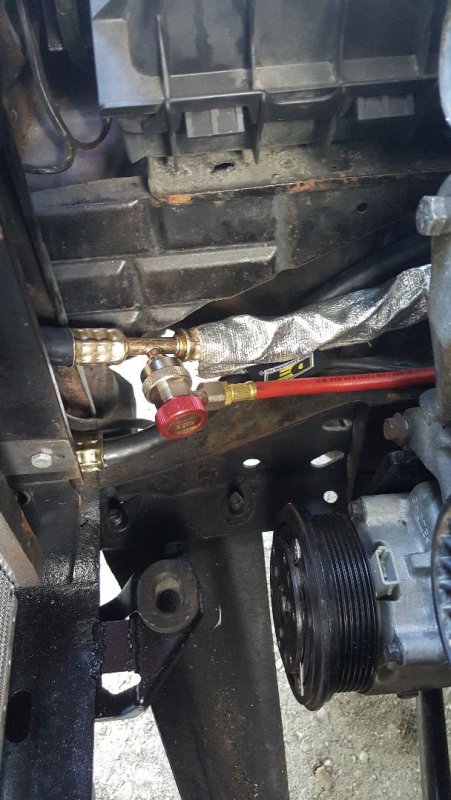

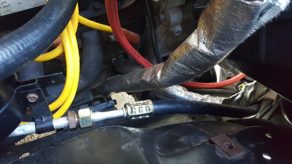

Here are a few pics of the A/C install on my rust bucket. lol

Nice Bird...
Looks like it's time to wire it up.

Well, some not so good news. I went out today and looked at my gauge set and the system had leaked down about 1 or 1.5 in/hg. To about 28 or so. Now, the outside temperature from last night to today has probably changed 35 degrees or maybe more, so I'm wondering if the gauge reading changed because of temperature.. Not the system pressure but the gauge itself. Also, I left the high side valve open and the high side quick connector doesn't quite fit the in-line QD high side fitting like it should. It won't fully snap on.
So, I pulled the vacuum back down again (took about 2 seconds) and now I plan to leave it under vacuum for several days to see if it leaks down or not.. This time I'm leaving the high side valve shut off to eliminate the QD hose end from the equation.

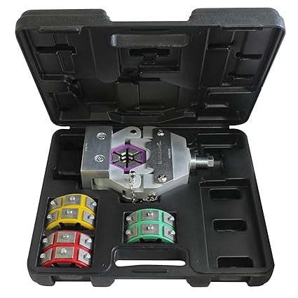

So… you bought a hose crimper tool? If that is your first go at... those look pretty good... way to go Bird.

Yeah, I bought a Mastercool manual hose crimper set. A very nice tool. Very easy to use and worked perfectly as far as I can tell. I had to buy one because every single business I called said they couldn't crimp my fittings because they weren't Gates brand, or they couldn't crimp any A/C fittings at all, etc.. Lots of excuses, and lots of ill-informed mechanics that had no idea about Atco/Gates fittings being the exact same specs.

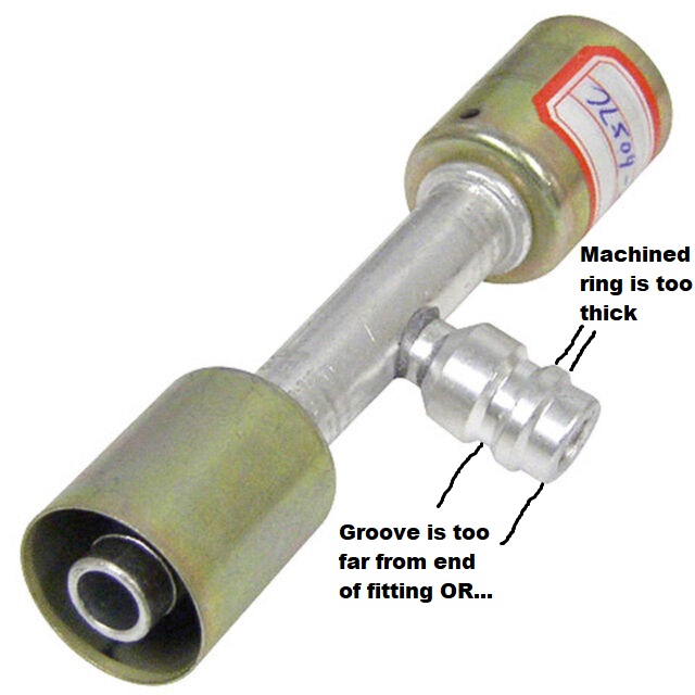

The high side QD port fitting in the hose I made, I'm wondering about it's quality. It's an Atco brand fitting which should be good quality. My Atco fittings came in ATCO/Gates branded parts bags. I just checked and the QD attachment on my gauge set attaches perfectly to my 2001 Ranger's high side port. So it seems like my fitting in the hose I made is out of spec. (I just contacted the Ebay seller to tell them about the fitting being out of spec)
Here's what I've determined so far about the fitting on the high side hose I made:
(this isn't the exact fitting I used, but it shows the QD portion clearly)

Well, I just popped outside real quick to check and the system is holding vacuum for now. It must have been that high side QD port that was leaking. HOPEFULLY. I should know by tomorrow if it has a leak or not..
I also heard back from the Ebay seller that I bought my fittings from and he said he's going to take all of his remaining "splice connector w/ 16mm service port" fittings to Atco and have them checked. He stated that I was the first person to ever report having an issue with his fittings. He wants to call me on Thursday or Friday, and I told him I'd be glad to provide the most accurate measurements I could get with digital calipers.
Well crap. It's leaked down about 1 inHg overnight.
I'm going to leave it for another day or so and see if it continues to leak further down or not. Again, the outside temperature has dropped pretty drastically, so I wonder about the gauge's accuracy when the ambient temp has been fluctuating so much.
