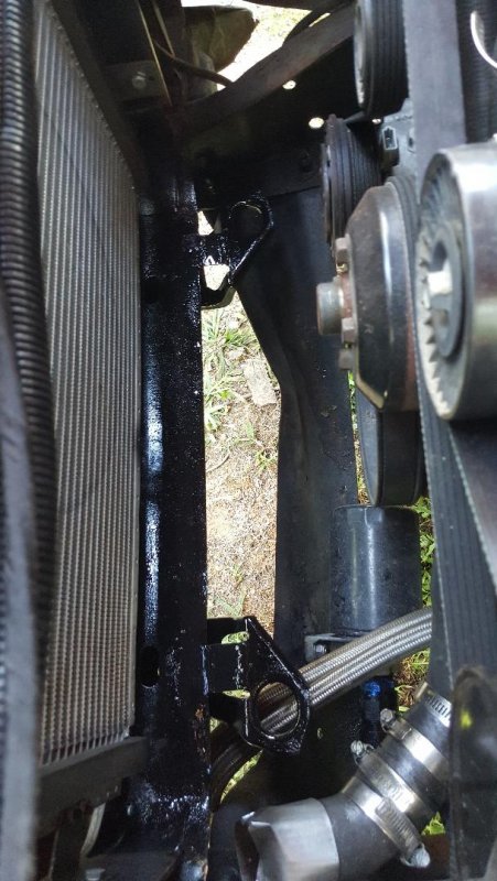

Today I got the lower radiator mounts rebuilt after cutting (hacking) them out of the truck for the 2nd time. So I welded in some new steel where they needed it, trimmed them up, ground them back to shape, welded them in the truck, and then wire brushed/cleaned with brake clean and painted it all.
I test fitted the radiator and mechanical fan after welding them in and everything fits wonderfully. The radiator hoses will still present a challenge as they always have.
It's definitely not my finest work but it's more than adequate.
