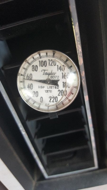

This was the temperature in the truck when I first went outside today. Outside temperature was around 76 degrees.

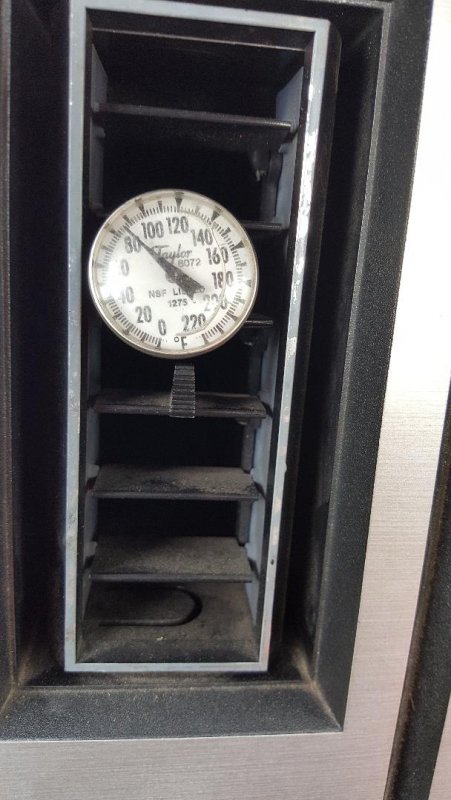

This was the A/C temperature on high after idling for around 15 minutes..

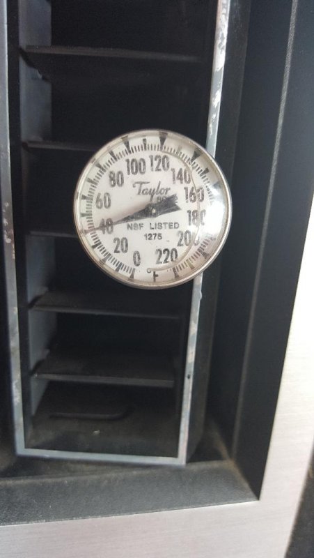

This was the A/C temperature when cruising on the highway at 55-60 mph.

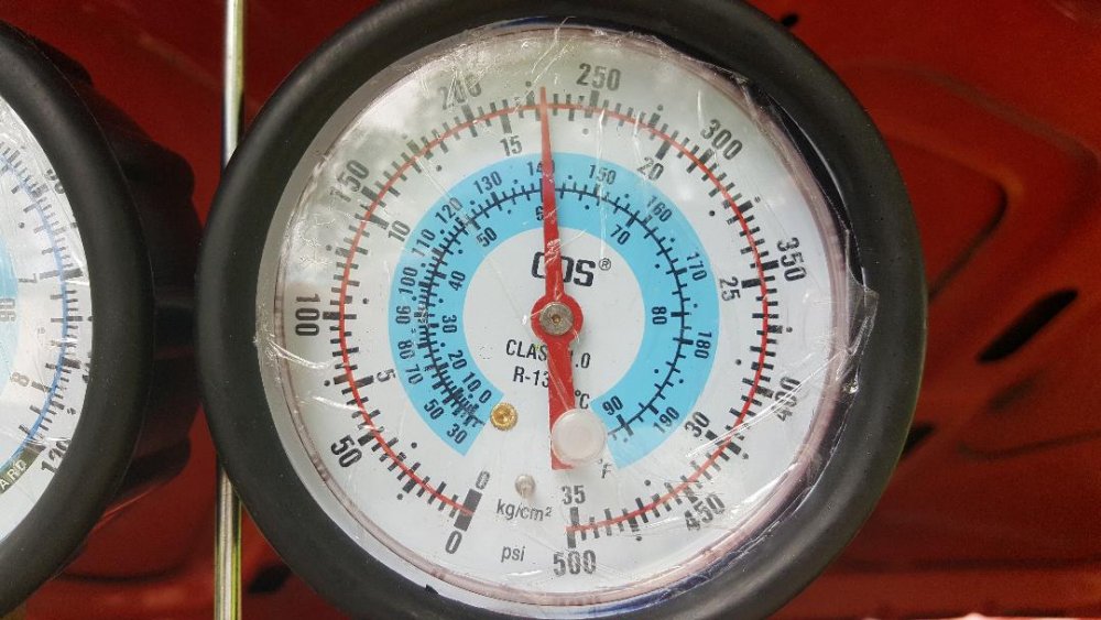

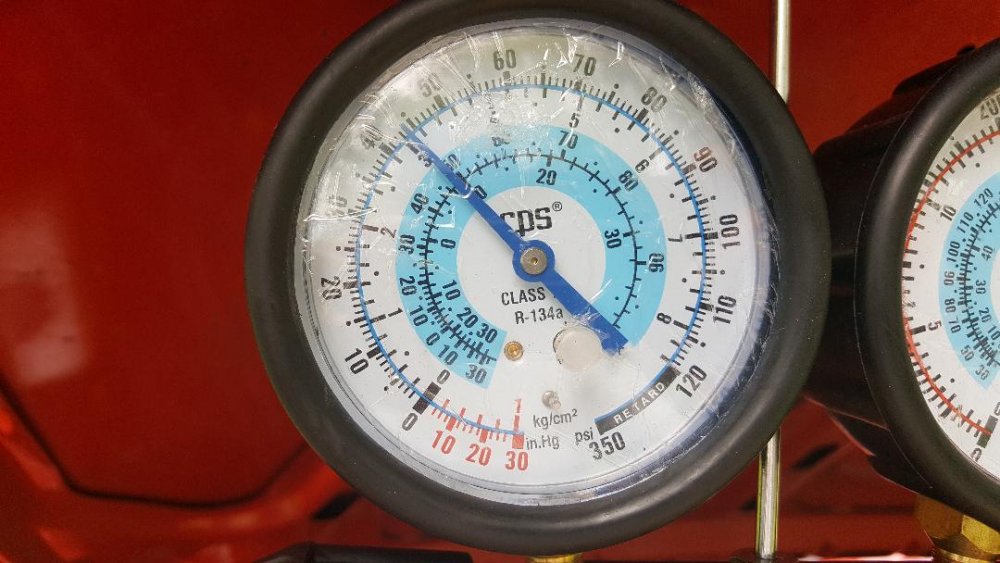

This was the system pressure after idling for around 15 minutes. It may not meet Ranger specs, but it does match up to the temperature/pressure chart pretty well.

The high side is running a little too high, but nothing dangerous so far. I believe I have a little too much refrigerant in the system though. I only got two 8oz cans put in.. I may have accidentally let some out, and the system started performing even better... But seeing how my new compressor has a leak, I imagine the system will correct itself nicely. lol
