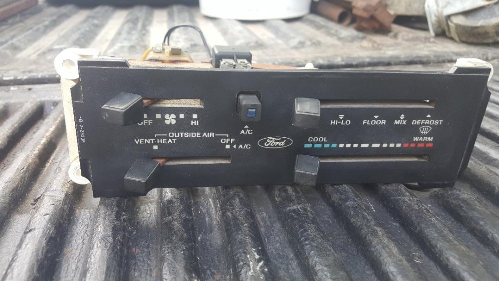

I plan to hit up a local salvage yard to pick up the dash controls that have the A/C button and use that button to trigger a relay to power up the compressor. I'll be using the stock Thunderbird A/C wiring harness to scavenge the wiring plugs from to build a custom wiring loom. I think I understand the wiring by looking at various diagrams online and looking at the Thunderbird harness. I have no need for a WOT cutout relay system in this truck..
So basically I'll be running power to the A/C button in the dash, which when pressed, will trigger a 30 or 40 amp relay to apply full battery voltage to the compressor. The high and low pressure switches should cycle the compressor by being on the ground side of the circuit, disengaging the ground to the relay if they sense a low/high pressure scenario. As shown in this annoying video:

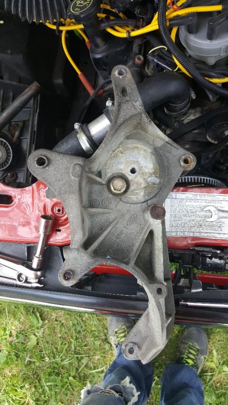

Alternator/smog pump bracket removed from engine. (that is PB Blaster running down the cylinder head)

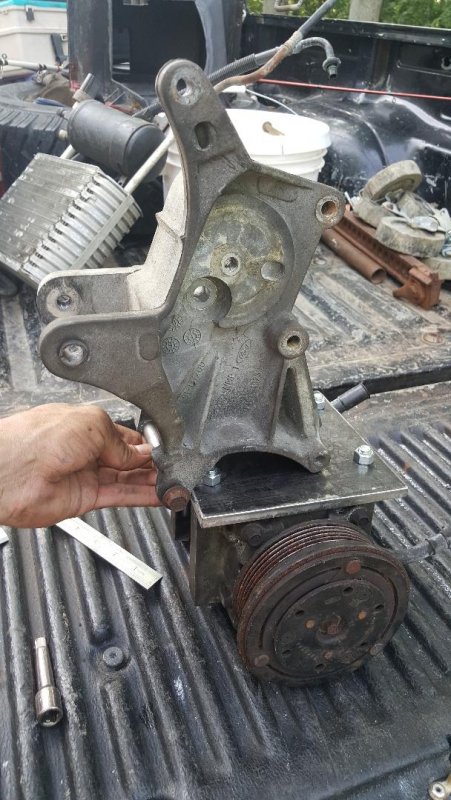

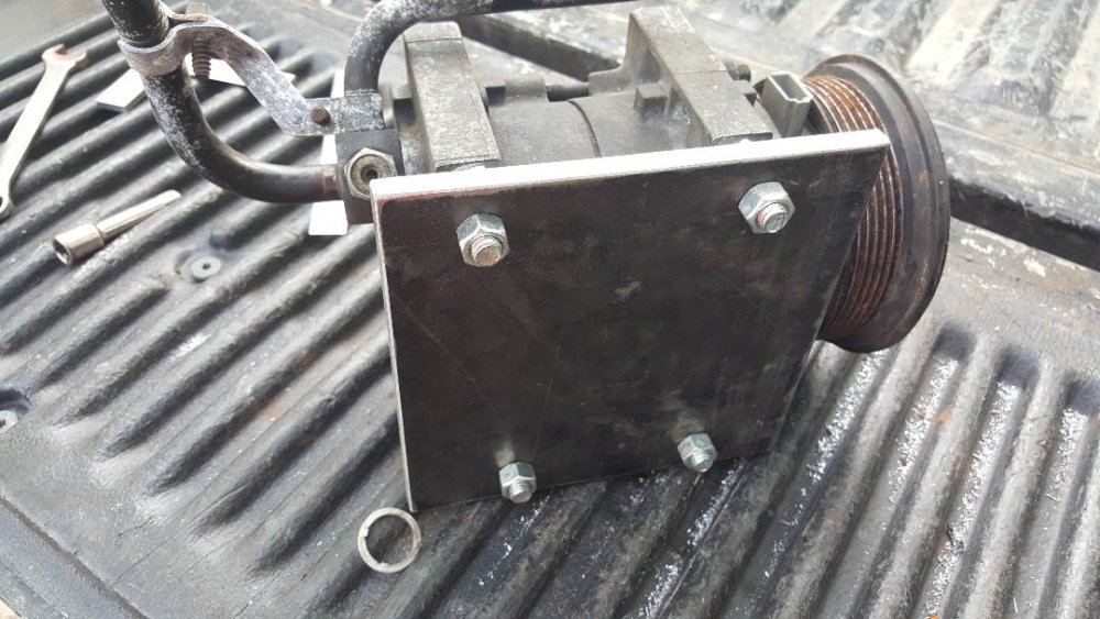

Some thick bushings I picked up at the local machine shop to weld to my compressor plate/bracket.

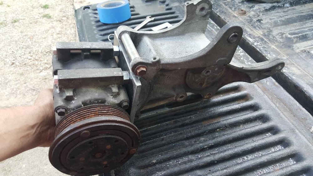

Bracket progress so far, after much measuring, marking, and drilling. There will be another 90 degree bracket like what is show in the link I provided earlier, to provide stability to the mount. Possibly a threaded link with rod ends so I can fine tune the belt tension if the automatic belt tensioner looks like it needs more travel. I'm going to have the bolt holes milled in to slots at my local machine shop. That way I can fine tune the belt alignment. It will allow the compressor to move fore and aft. He told me today it would cost me $20 to have them milled in to slots..
The nuts are only used as temporary spacers until I can get my bushings trimmed to size. It spaces the compressor body out away from the plate. I'm holding the compressor/plate backwards in this picture.. Long day....

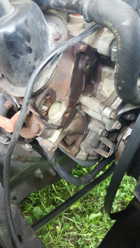

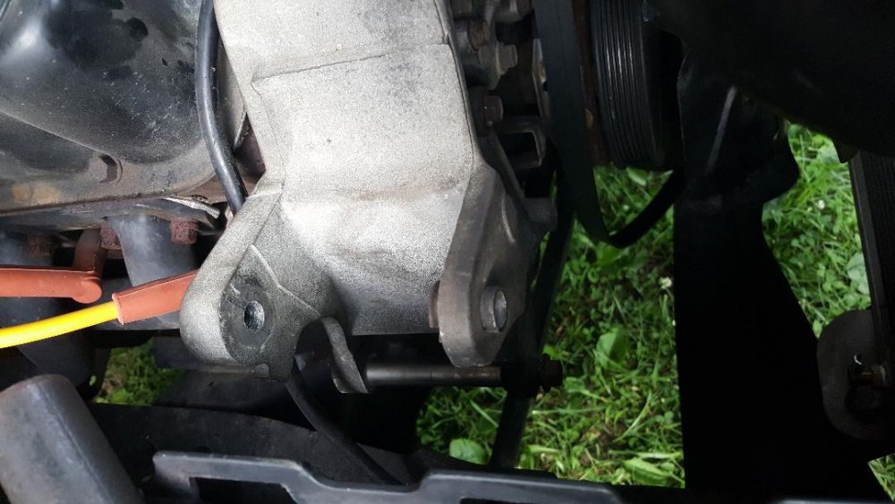

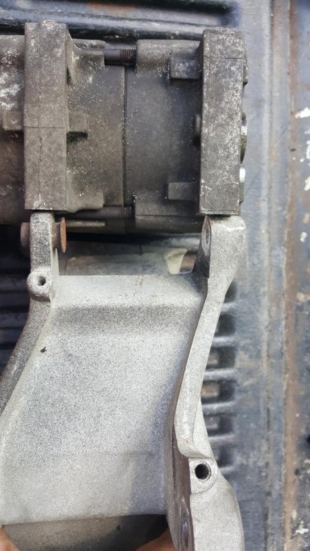

Trimmed alternator/smog bracket reinstalled on the truck for mock up.

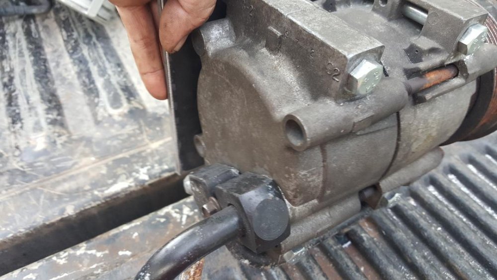

Hose connection removed so I can remember which fitting is the largest. This will help me when shopping for the adapter to make custom lines.
I actually have the plate/compressor backwards in this picture too. It's been a long day...

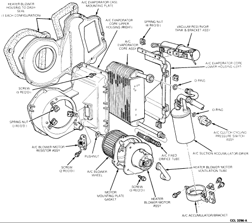

I think you need an orifice, not an expansion valve. Cheap little piece of plastic.
Running the A/C system off that little button is what the system did from the factory.
The dash portion of the harness comes out of the firewall with the blower motor controls and is a small single pin connector, mine is gray.

I'm still not sure about orifice tube vs expansion valve.. I'll have to give an online A/C parts supplier a call to see what they recommend. I'm thinking the orifice tube is more of a metering valve/filter in the Ford system, but I'm not sure how they took care of expansion in the system?

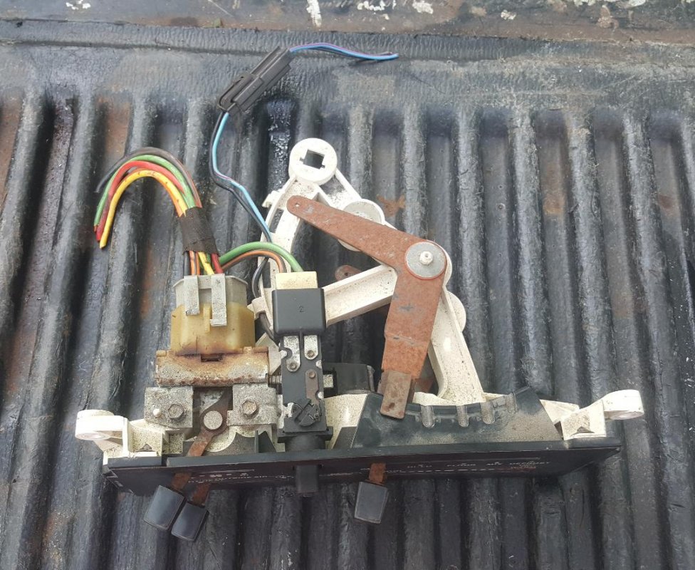

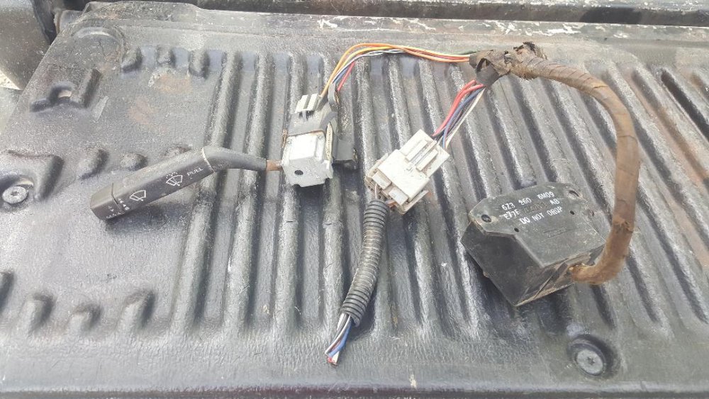

Today at the junkyard I scored the following for $40 total, which was a little high but still cheaper than Ebay:
I also found the parts I need for my delay wiper conversion. $20 is faaaarr cheaper than Ebay stuff for this. I just hope it's all good because out of the dozen or so 1st gens they have, there was only one with delay wipers that I could find. If not, I'll go hit up a couple others and a couple early BII's and see if they have it. The guys are good at exchanging parts for me for free if they're faulty.

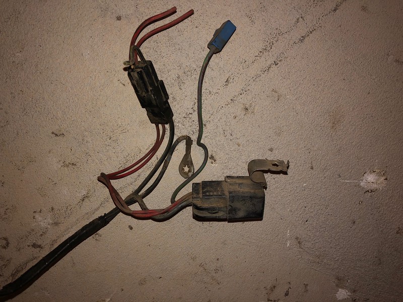

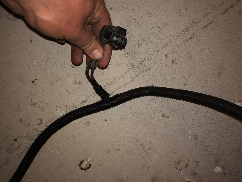

I found my engine side harness, it might help.
Only has a place for one switch.
Compressor end complete with diode:
Switch connector:
What plugs into the dash harness (blue), goes to to the ECM, ground and WOT cutout relay:

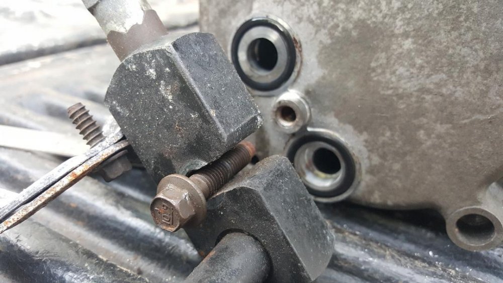

It does look like my factory Thunderbird compressor block (hose connection to the compressor) has a built-in relief valve, but whatever new adapter I get to hook lines to the compressor doesn't look to have a provision to mount one. So that's another thing I'll have to be sure to adapt in to my hose.
Here's the factory one:

From what I've read thus far, not all systems used a high pressure switch. The switch Ford used on the accumulator/dryer isn't just a low pressure switch either. They called it a cycling switch. On 47psi / Off 26psi / Off permanently at 0psi
More research is still needed...
