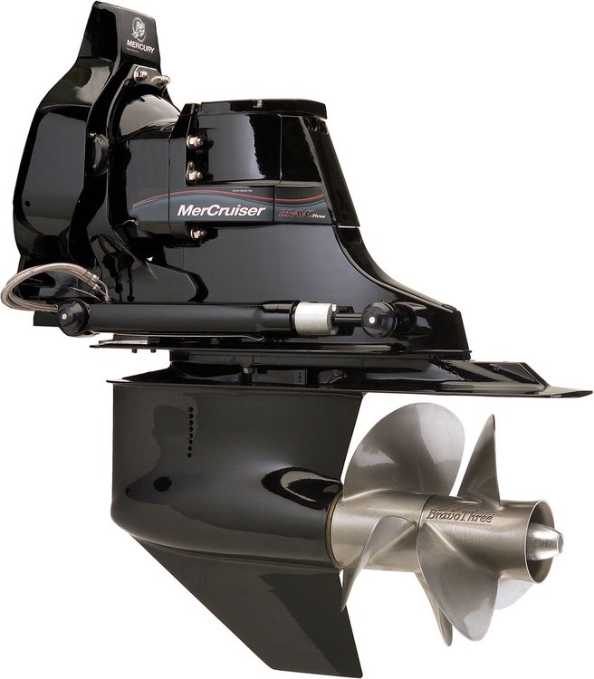

Horsepower sells boats & bragging rights at the pub. Torque pushes water. More dirty thoughts about a V10 or at least the 5.4... 457 lb-ft of stock twisties is tickling the nuts of diesel power or stroker & cam kits in GM/LS but with the RPM range you want in a cruiser. You can "allegedly" get 30-40 more horses out of a tune, but this is in the auto world. Messing with phasing to get it to run a boat might net a bit more torque lower down. And if I only have to buy one drive, I can hook that 10 cylinder monster to this mean SOB...

Do contrarotating props work better in a boat than on airplanes?
Seems like they are all ooo and ahh until the gearbox craps out...

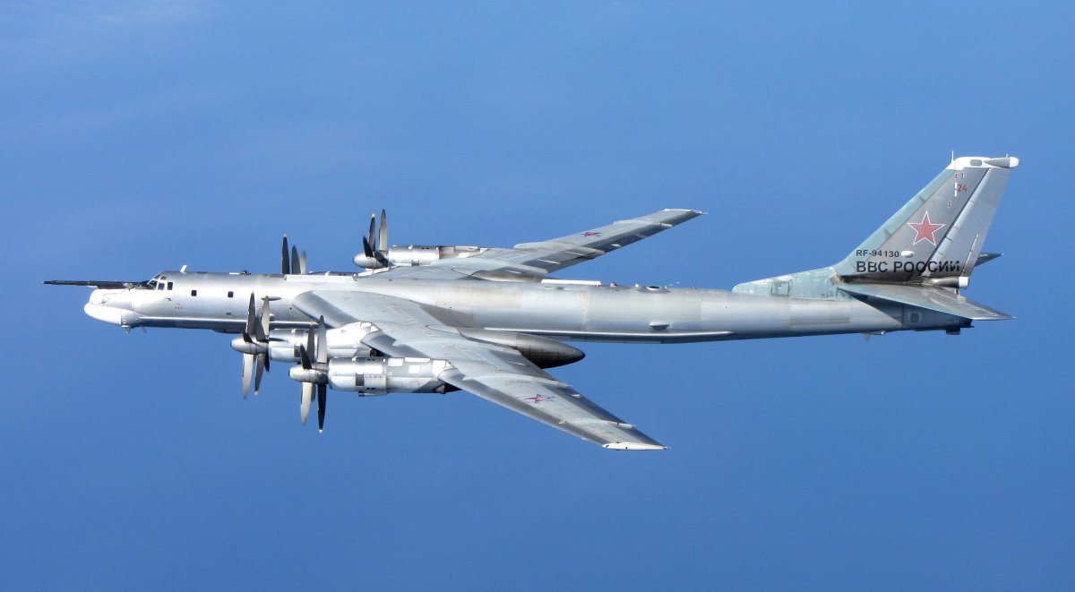

Russia seems to think they work good. Their biggest bomber uses them.
Quite a bit better. Single props kinda just sling water everywhere. Some goes back, some down, up, left, right... If you've tried reverse or idle-forward with a sterndrive you know what I mean. It's all over the place. Forget what you know about steering a car because you'll feel like you're about to take out half the dock. Contra-rotating props pull tangentially displaced fluids back into the secondary prop to create a more concentrated "beam" of force. You lose out on the top end but the control you gain on the bottom end is worth it in a boat this size. Think of it like cornering in a Tahoe with junked out shocks vs. in a brand-new Explorer. Twin-engine setups with one prop add axial control but can be just as rough in reverse as they haven't solved the tangential flow problem. In the air it's anywhere between 6% and 16% gains in efficiency according to the net.

As for the Russian nuclear bombers with contra-rotators: they're jet turbine powered to the tune of 115,000 shaft-horses per unit. Contra-rotators are extremely good in situations with big power and heavy load and help to decrease losses. The commercial version of @Dirtman and his Tu-95 actually holds the world speed record for prop aircraft!
