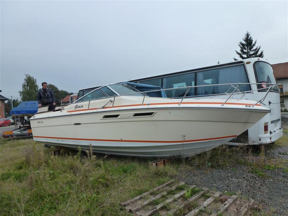

This is what some guy over in Europe looks like sitting in the same model next to a bus.

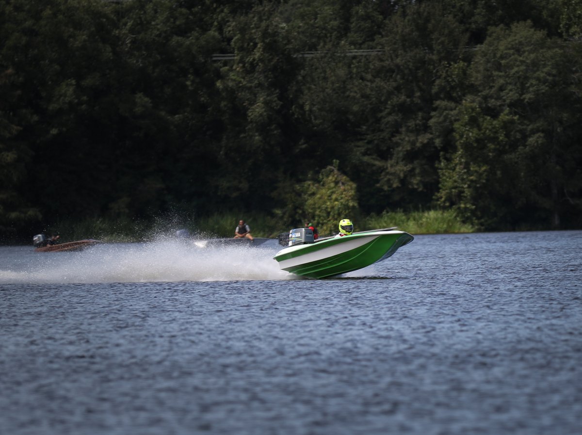

I have a boat, lol several. That is my 1st love. This one is carbon fiber 190# 15'
