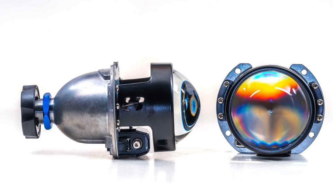

I was talking about something more like this, where the entire assembly is designed around properly focusing the beam from the HID source. The retrofit involves opening up the factory halogen housing and converting it to hold the projector. That way all the focus issues are avoided because it's all handled internally within the projector unit.
There may be a similar version for factory LED headlights, but it's not a road I've been down for research yet.
