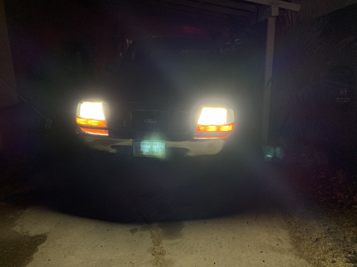

Finally got the LEDs set in place and properly put in. The LEDs are torchbeam 9007s.

Hows the beam pattern? Everytime I've seen LEDs in a stock ranger headlight housing the bulbs are plenty bright but they are horribly focused and scattered to the point of being useless.
I'm not really sure. They are fairly bright, but I haven't had a chance to see how focused they are yet
Let us know. I'd love to find a set of bulbs that work well in the ranger housings!
