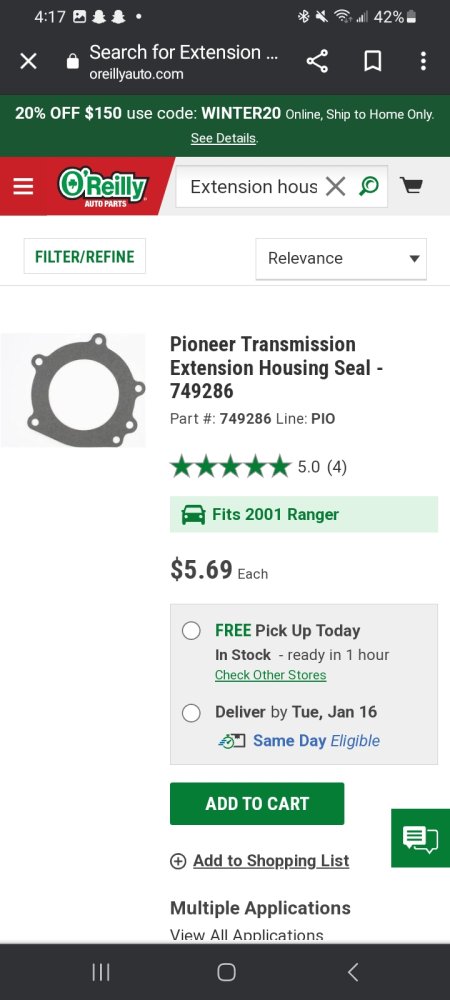

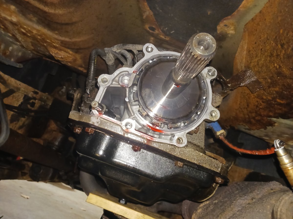

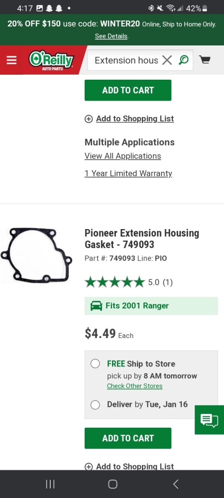

I took the extension housing off and everything else today, it seems to me that it is supposed to be wet. There was a gasket between the transfer case and extension housing, and what looks like a piece of a gasket in-between the extension housing and transmission. For some context, the extension housing was replaced by someone before I got the truck. It looks like whoever did that job did not even put a gasket back in place of the old one. Wouldn't surprise me seeing as how many loose bolts and shady work I've found on the truck so far. I attached some pictures of the gaskets it looks like I need to buy, and I'll post some more about what the extension housing and output shaft looks like. Let me know if all this info seems to track correctly or if I am missing something, Thanks!

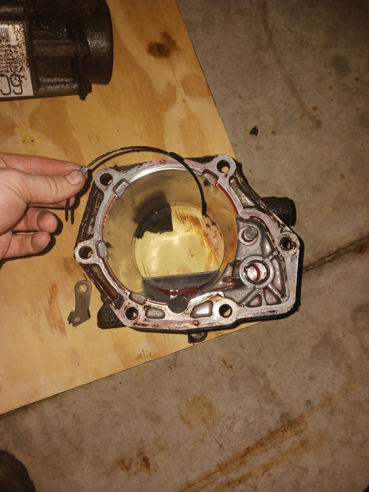

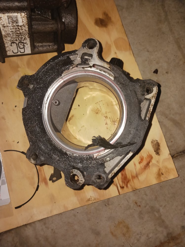

Transfer case side of extension and output shaft. Don't see a shaft seal to replace
