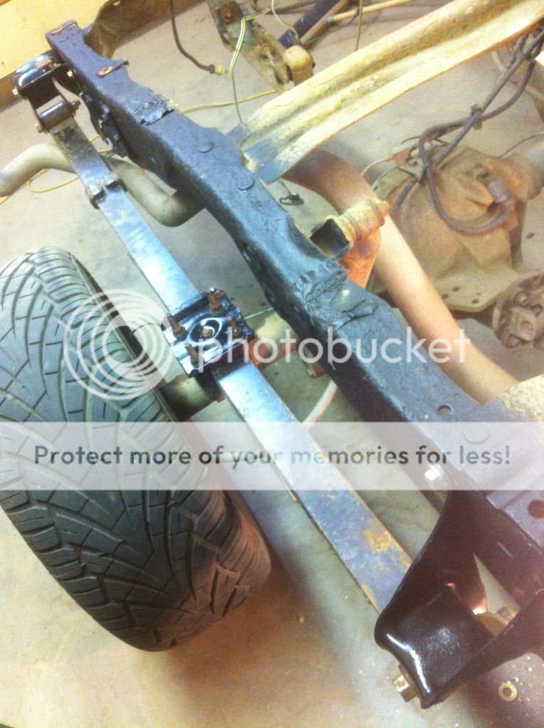

This is not my picture, but the 4x4 springs look identical to these, and my 2wd ones only have the upper three:
Should be fine, yes?

What you think about the extra item in the 4wd leaf pack?
Yes, will be fine.

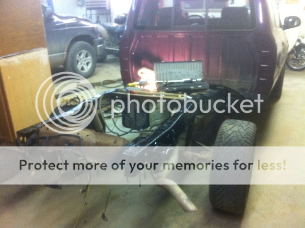

FINALLY got some time to swap out the springs, hangers, shackles, etc.
Appreciate all the help you guys gave, thanks.

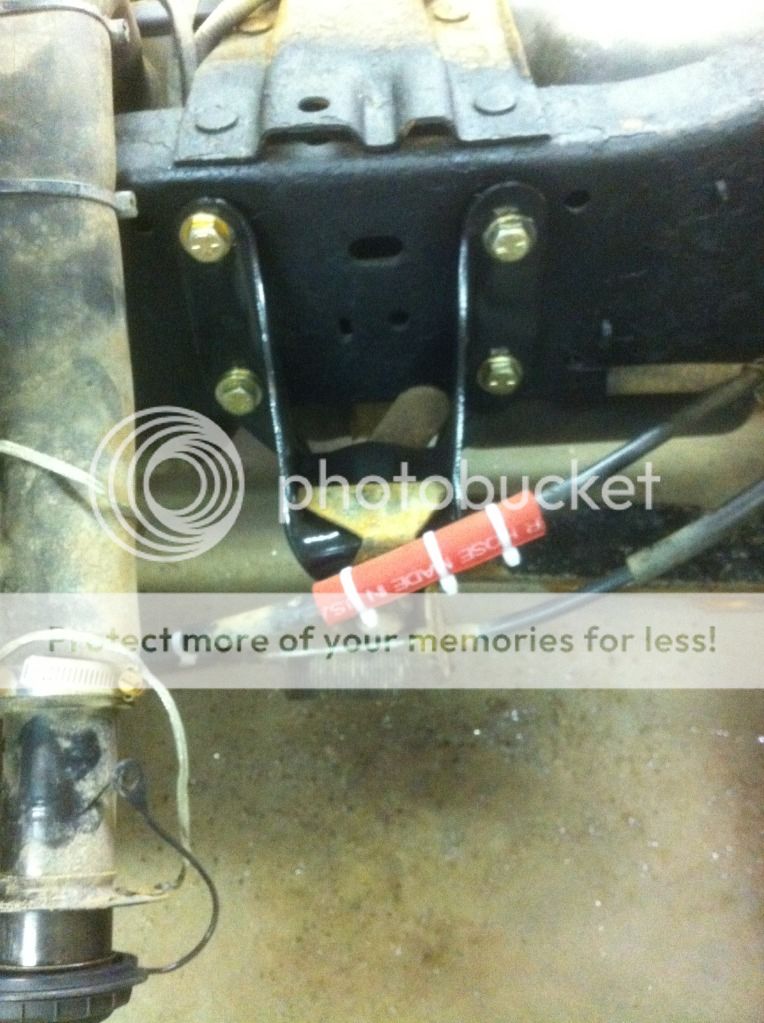

And the E-brake cable bracket needed it's hole hogged out a bit, as the front 4x4 spring eye bolt was a little larger O.D., and would not slide through the bracket. A quick touch with the dremel and a grinding stone, and it was the right size again!

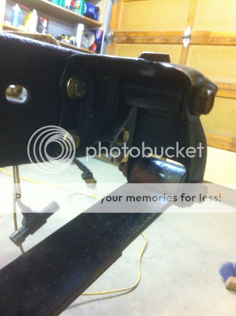

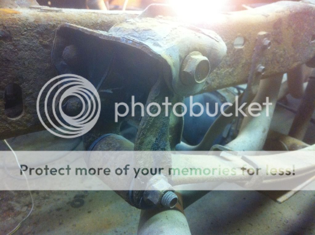

Old hanger bracket, started disintegrating when I hit the bolt with the impact gun:

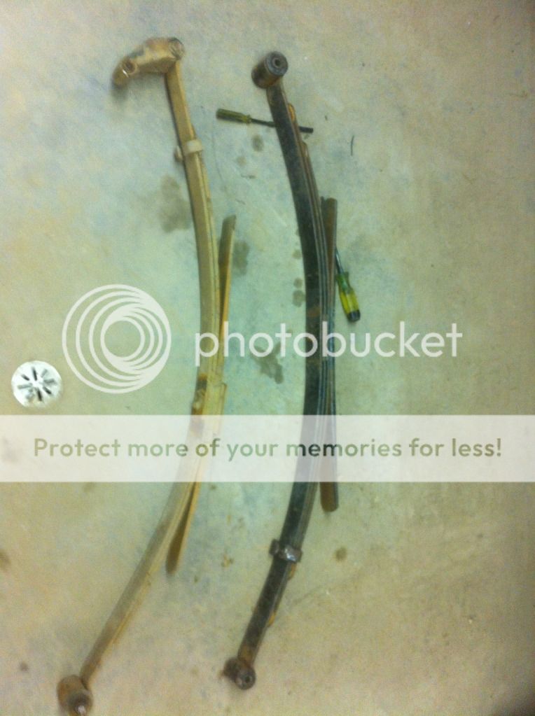

Old and new(er) leafs together:

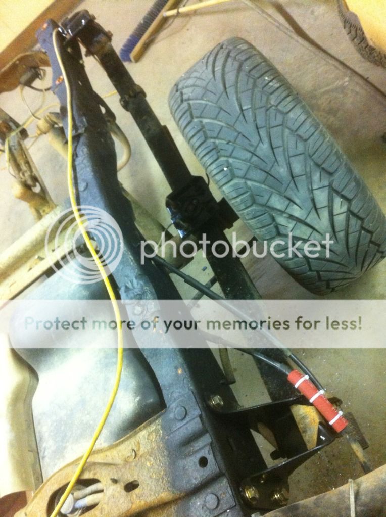

Protected my e-brake cable from rubbing on the bracket:

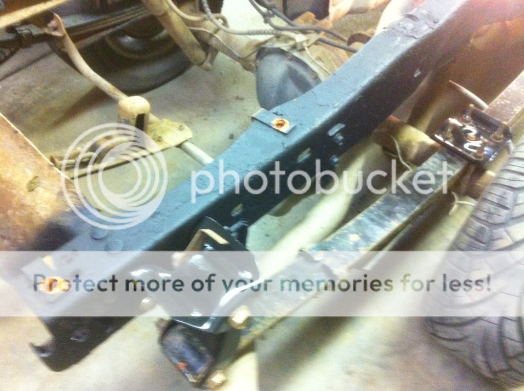

And the rest of the improvements are below. Will finish painting the framerails tomorrow with some more Tremclad (I only had 1 can in the garage), and pop the box back on.
Made sure the bolts were all torqued to spec as per the manual, and the U-bolts were evenly snugged with the same length of threads sticking up over the nuts.
I was able to re-use the original U-bolts, they were in great shape and came off easily. They were also plenty long enough to accomodate the extra leaf.
I found torque specs for the new grade 8 hardware on the web and used that.
A little better condition than the ones I removed, LOL:

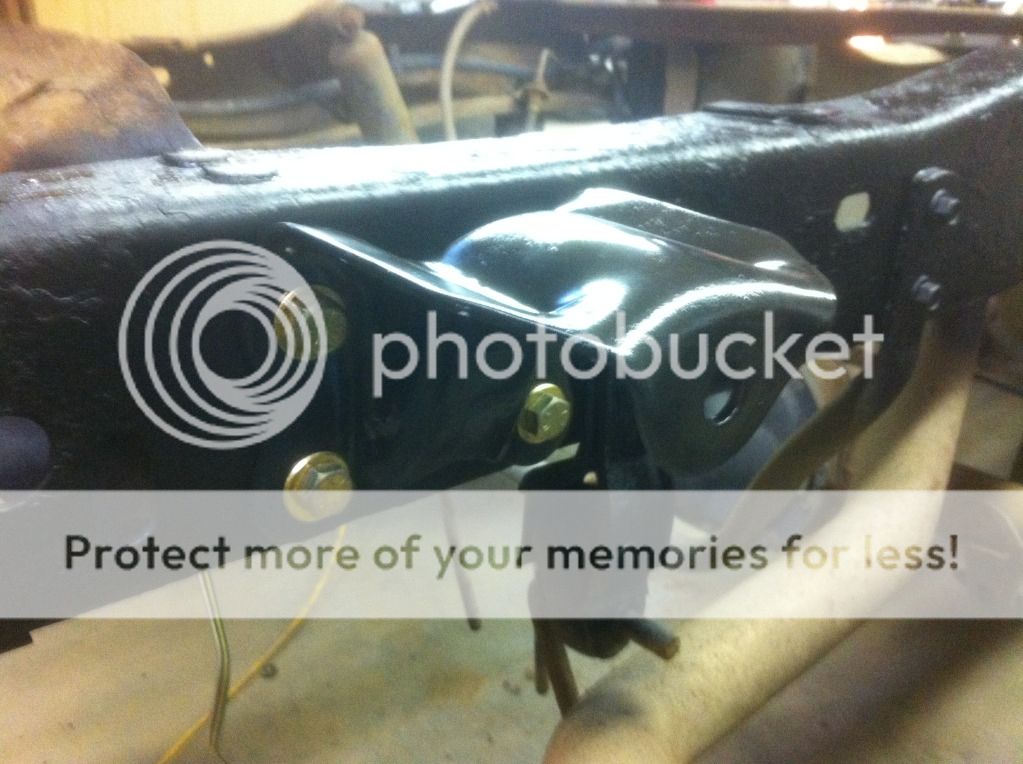

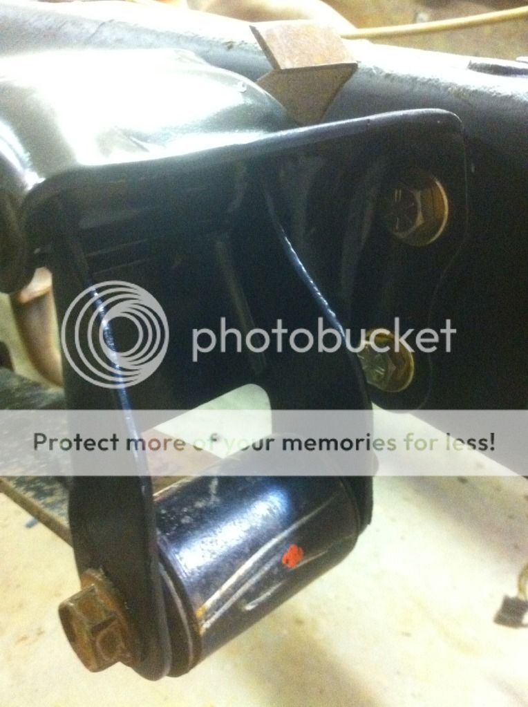

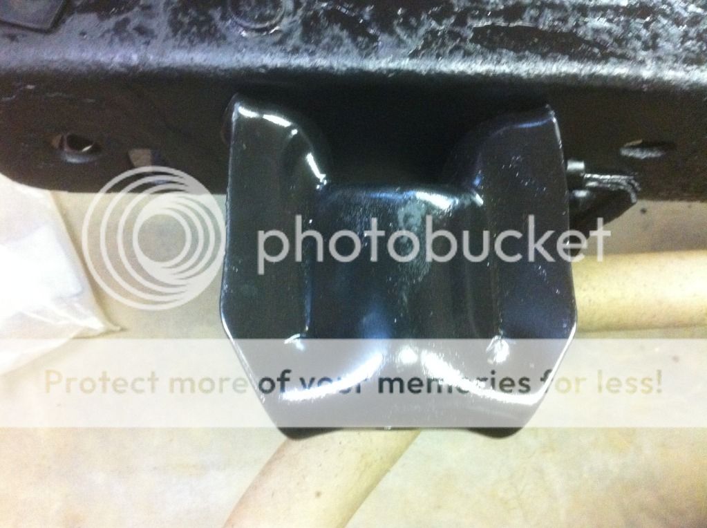

You can see how much narrower the top of the new bracket is in this shot, from the unused holes way out to the sides:
Rear brackets were identical, no drilling required:
