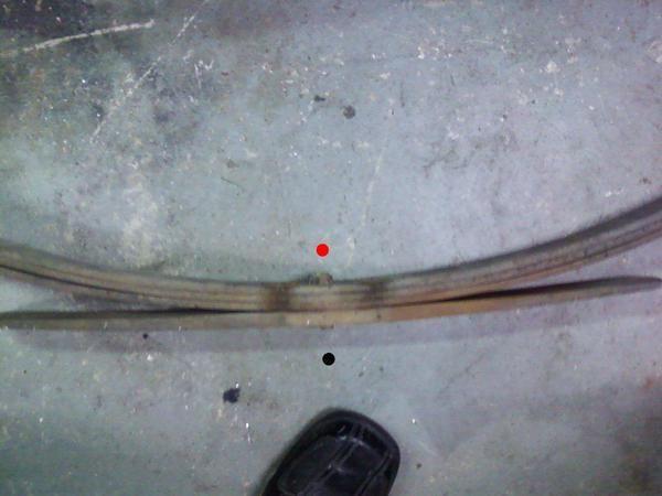

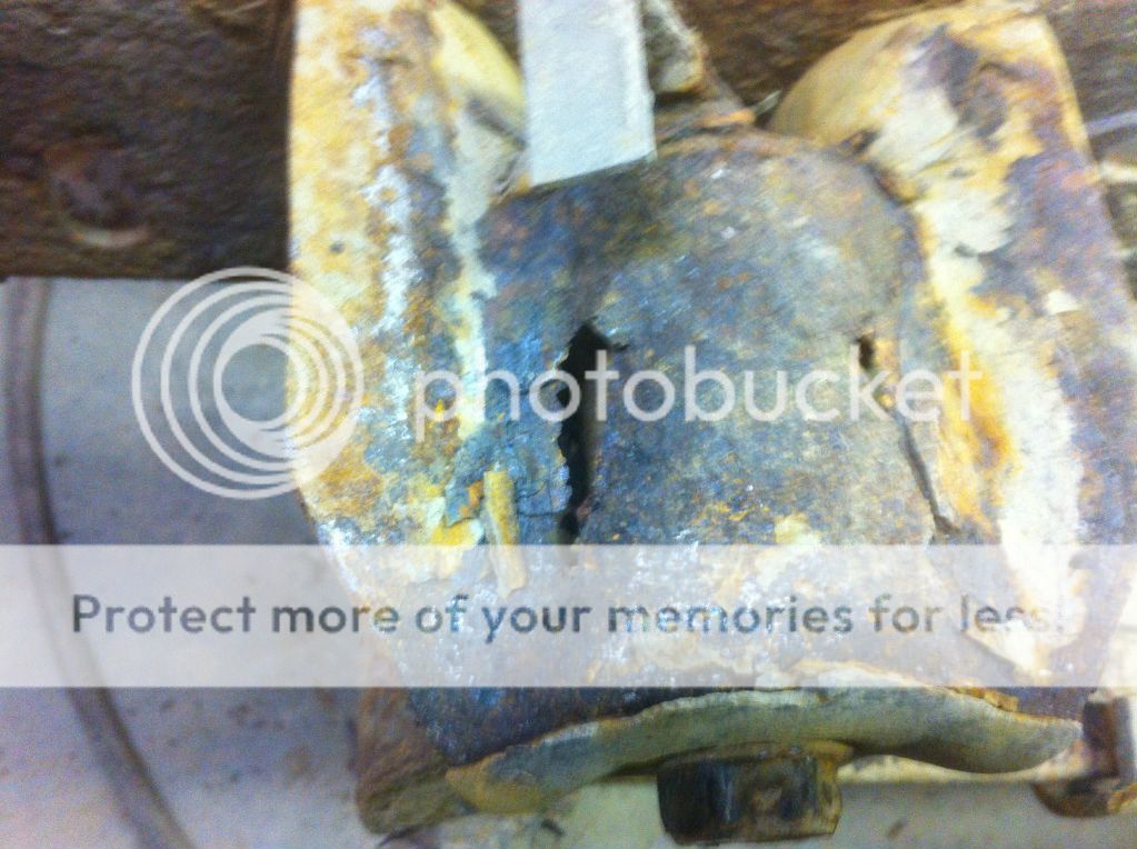

So I plan on replacing the leaf springs and hangers on my 94 2wd ranger. The hangers are quite rusty and thin, the spring bushings are well, 17 years old, and the leaf springs are beginning to wear, the lower springs slowly eating into the upper ones.
Not too bad yet, but I picked up a full set of springs and hangers from a wrecked 2008 4x4, in excellent condition. The teflon rub blocks between the leaves hardly have any wear on them at all.
I battled getting them off the wreck yesterday, which was hard, but quite doable because the wreck was flipped upside down (no cab, engine, or trans).
Now before I install them in the 94, I was looking for some tips, because those damn factory rivits are difficult to remove.
My plan is this: remove the box, heat the rivit heads from the outsides of the framerails with a torch, and hit them with my air chisel while they are glowing hot to remove the heads.
Is there a better way? Would centerpunching them and drilling them out be a better approach? Use a drill bit that's a fraction smaller than the rivits?
Any advice is appreciated, thanks.
