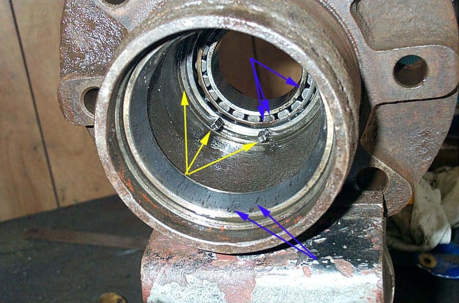

Kyle, inspect those hubs VERY CAREFULLY!!! The inner bearing races are only held in by a circle clip, and if the grooves are worn or if the clip is worn or cracked, you will lose your wheel. The circle clip holds the hub and wheel on, not the outer wheel bearing nut!! (That's why you couldn't give me a corporate 14 bolt...)
SVT
Not quite....
"IF" there is a problem there you will get noise, and leak fluid. You will not loose your wheel. The hub cannot slip off because it cannot overcome the outer bearing, the race, and the locknuts. Only chance of "losing" the wheel would be if both bearings were destroyed. Its all sandwiched to the axle spindle via the bearings and the locknuts.
Watch out for this when you go to remove the wheel hub outer bearing and race. The bearing does not simply fall out of the end of the hub on most FF axles - its OD keeps it captive. Instead, a snap ring in the hub, accessible from the back of the hub (yellow arrows) needs to be removed so the wheel bearing can come out the back.

This is the view from the backside, if nothing else, if the clip fails the hub would move inward not outward.
I got a buddy that has a chevy 3500 had wheel bearing problems, pulled it apart, complete rebuild new inner and outer bearings and races and new seal, the truck didn't make it 30 feet and both tires (dually) came off. Pulled it apart only to find the retaining clip failed and the hub slid off...

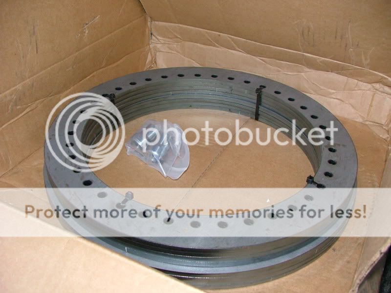

Got some goodies today...
Kyle M's Ranger Rebuild

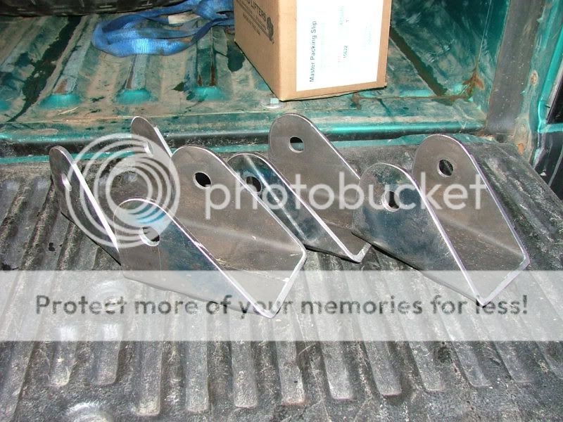

Then I made these after work today, spring hangers for the inboarded 63's
