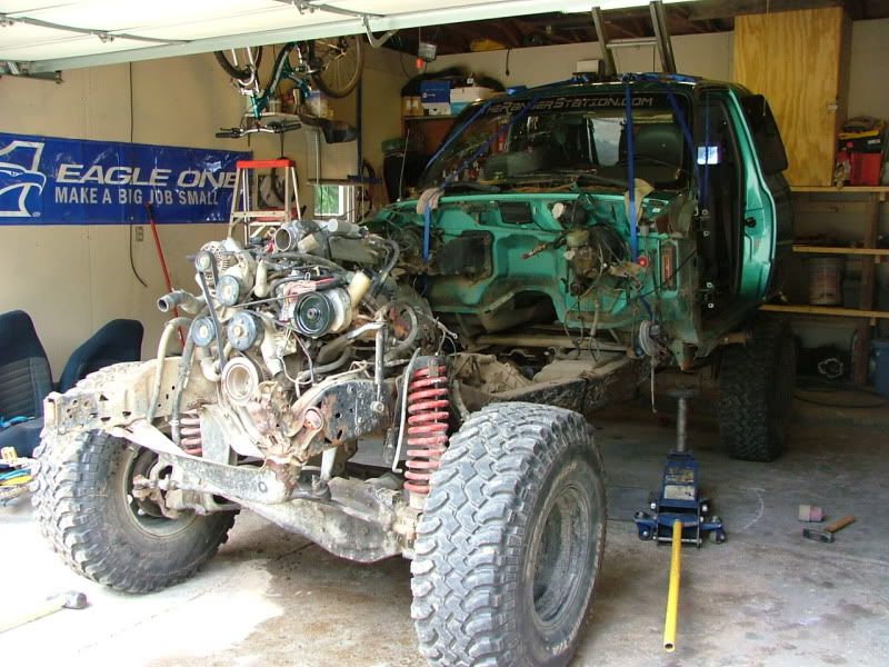

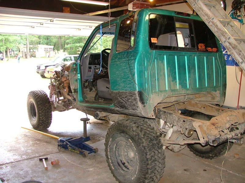

On another note, made some progress, pulled my X cab, but just rolled it back on the frame and sat it back down since I want to put the motor in the other frame before I put the body on it. Might just leave it like this, looks kinda bad ass IMO:icon_twisted:
Mud raaaaaaiiiilllllllllllllll!
:icon_rofl: your rear tires would rub
I can clear it for that....
Hell yeah!!

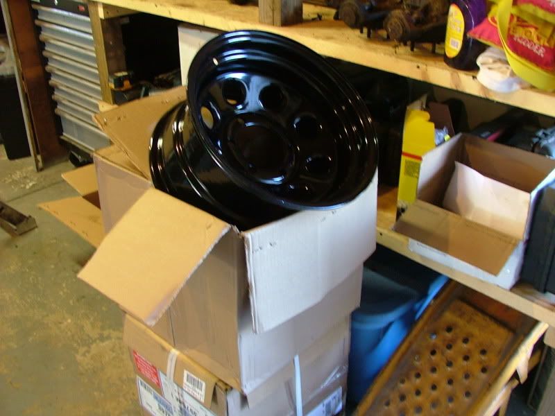

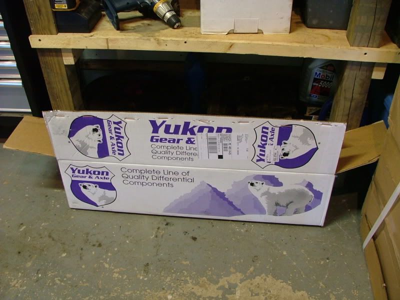

New parts showed up today, got engine ready to come out and go in the other frame....on with pictures
Truck looks broke....sitting on bump stops
Fawk yeah Kyle. The build has been coming along nicely. Good progress, you'll have it up and running in no time.
Hell yeah, Kyle looks like your trucks rebirth is just moving right along. I'm already subscribed.:icon_thumby::icon_welder::icon_cheers:
