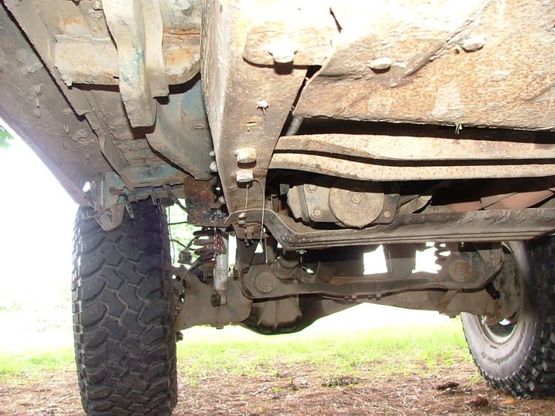

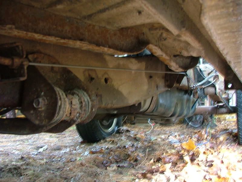

Here are some pictures of the frames, as best you can see them....
2wd frame
4wd X frame
Just for reference, my rear cab mount on the X cab will be where the front spring hanger is, or there about...

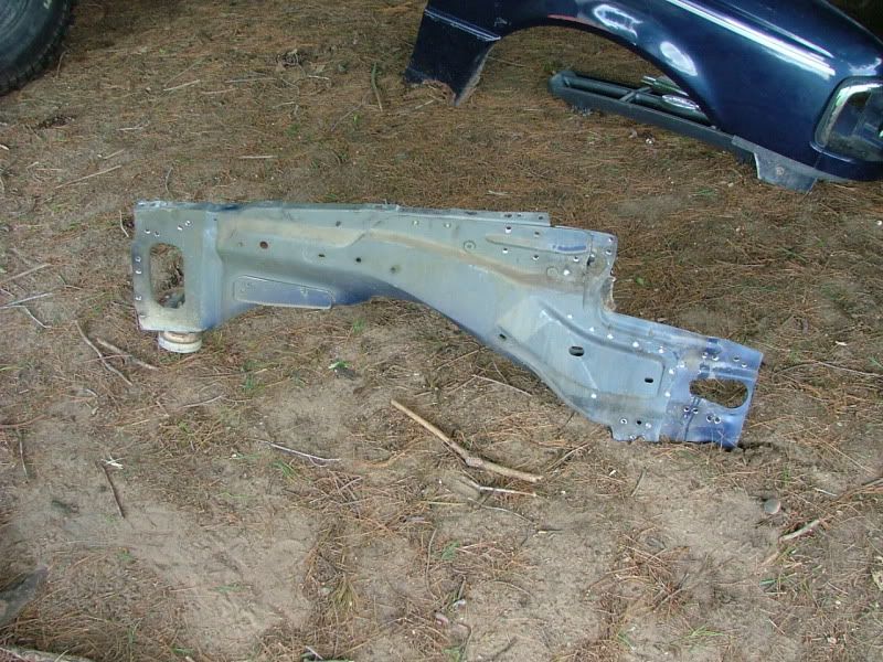

And just a little update, had some time into tearing the parts truck down, got the flat bed off, front clip off and the inner fender support removed.

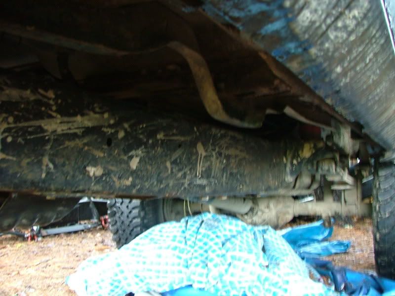

I also got another look at my X cab frame and how bad it is really messed up...
supposed to be straight, ouch
damn, thats one f'ed up frame. how fast were you goin when you hit the tree?
holy man is that one bent frame rail. glad to see youre gettin another truck together already. just outta curiosity, whatcha doin with the front pig?
Not sure, some where between 20 and 30 I would guess. Not really that hard, but hard enough.

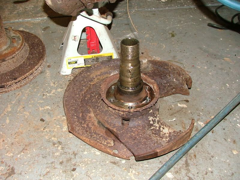

I got a corporate 10 bolt axle for free from my buddy, he was gonna scrap it, and I knew the knuckles looked the same as mine so i wanted to see what I could make work. What I wanted to do was take the spindles and backing plates and put them on my EB drum knuckles because I read that they "might" fit. My concern is what would I use for stub shafts, locking hubs, and what bolt pattern I would have to run.

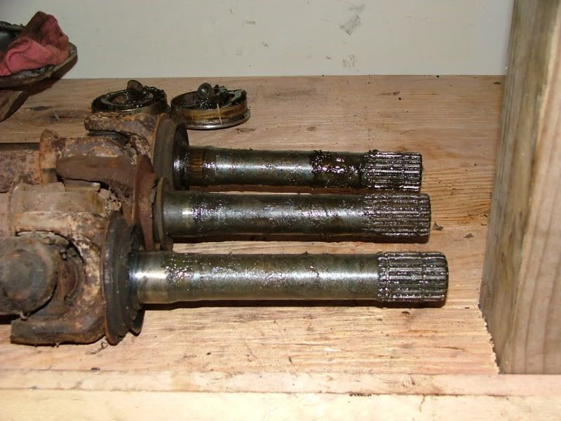

So after tearing down the 10 bolt I found that sure enough, the spindles will bolt up, the stubs are the same length and same spline count as my 44 stubs and I can use my Ford locking hubs in the Chevy hubs(slid one in there and it fit). I really wanted to have the 5 on 5.5 bolt pattern but it appears the inner bearing has a larger id so it wont work (unless someone knows of a special bearing i could use??) SO it looks like I will be running a 6 bolt wheel.

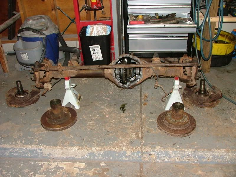

Here are a few pictures from the tear down
backing plate and spindle
the EB 44 shaft is in the middle, others are 10 bolt shafts

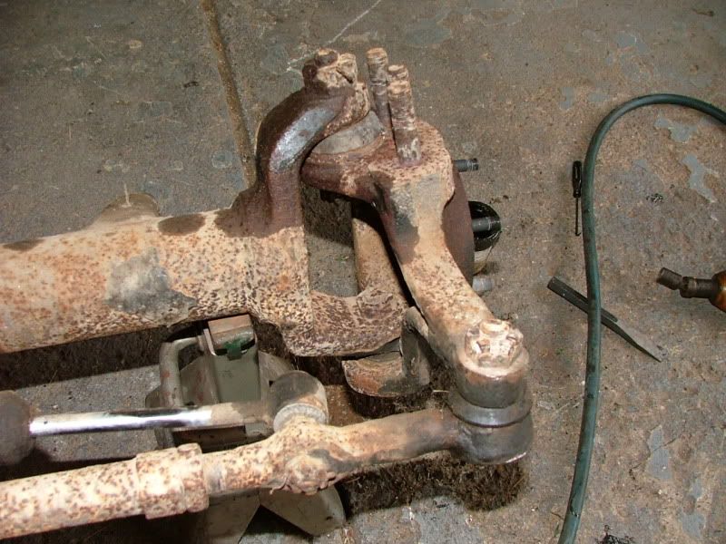

the one flat top 10 bolt knuckle, but it is on the drivers side, may be an issue? How can I make that work?
then my 44 ready to be torn down the rest of the way....

You can get a 5x5.5 bolt pattern but you need the small bearing spindle. I got mine off ebay. Then you use a ford hub on that spindle. That's the setup I'm running now - chevy knuck, chevy spindle, ford hub, ford lockout, chevy stub shafts.
Can't utilize the driver's side flat top unless you get a pass side to match it and do hi-steer. Maybe you can, but I don't know of any 'traditional' steering setups that it would work with.

I am thinking about turning the spindles down in a lathe to fit the smaller bearing, I read that it can be done, I will have to look into it. My only other concern is buying new hubs for the Ford pattern, they aren't cheap. For dollars sake, I might just stick with the 6 on 5.5 pattern.
I think that there is a drivers side flat top on that chevy axle because it was a leaf sprung front end, so no track bar to worry about and I think that is why it would work, still seems odd to have such a short drag link....
I thought most chevy's had their steering box on the pass side frame rail? I can't think of a specific truck that does, so I may be wrong, but for some reason that's in my head.
The way that is setup in your link, you'd have to reverse the steering input somehow. Look at the linkage, if you'd turn your wheel right, the tires would turn left.
