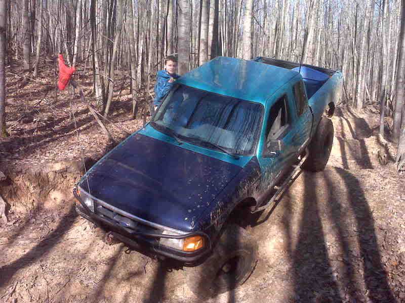

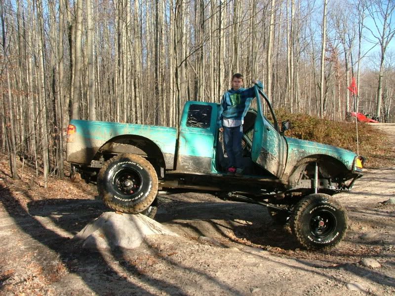

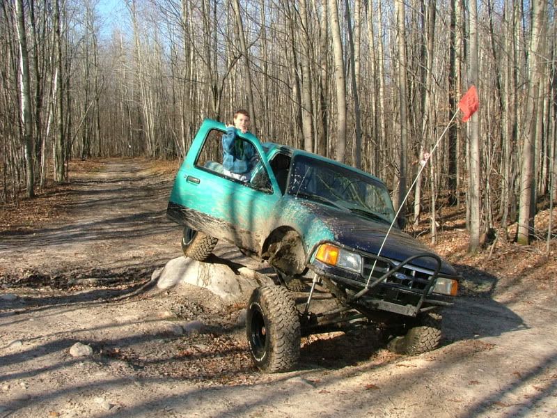

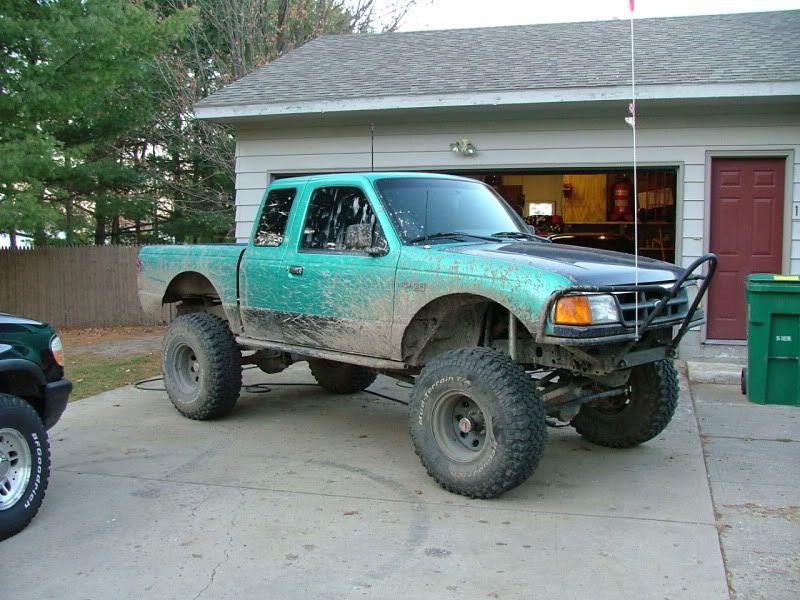

Alright, here are my poser pictures, nuttin special. Took em for my nephew...

That thing got a lot of flex man.
Thanks

truck looks real good.

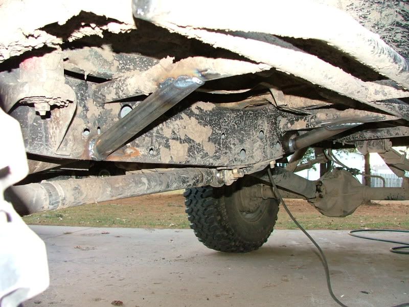

Alright, small update

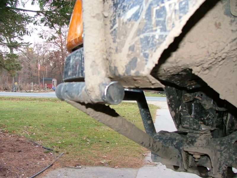

Added gussets to one side of my sliders, made them way more stiff.
Started caping my tubes....bout time

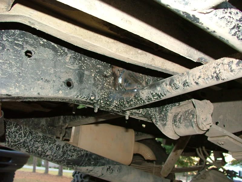

My bent tie rod
Gonna change that up a little. I am going to shorten up the drag link to the same length of the track bar, weld some tabs onto the tie rod to mount the drag link in double shear with a 3/4" bolt, flip the tie rod to the top of the knuckles to gain some clearance, mount with 3/4" bolts. Then I am going to flip the drag link to the top of the pitman arm. If I don't, things wont clear and the angle wont be right. I was also thinking about making it double shear...anyone see a problem with doing that? Welding to the pitman arm?
I just don't like how this all looks and I wanna make it double shear, on top
And here is one how it sits....
One last thing, I am gonna buy some Pacer flexy flares to help clean up the cut fenders. Oh, and my winch will be here tomorrow, so stay tuned for mounting of that.
I dont see a problem welding to the pitman arm as long as you preheat it first.
