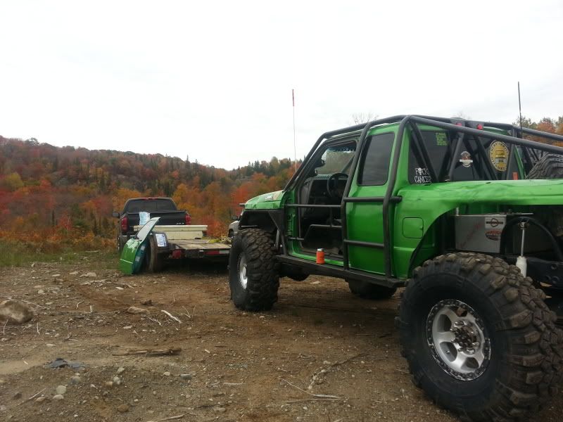

Couple of pictures and a video from my Canada trip last month, went to morning wood offroad Park.... Best place I've wheeled ever, hands down.

2 questions...
What happened to the rock rings?
Why does it load up and die when you get off it?

2 questions...

Haha, thanks!
First, I switched from the H2's with the rock rings to some BTR aluminum beadlocks, I love em too btw.
The stalling, not sure, it comes and goes but I think it is from the lack of the speed sensor to help keep load on the motor when I go wide open to no throttle. I have one and I should hook it up, but I'm too lazy lol
